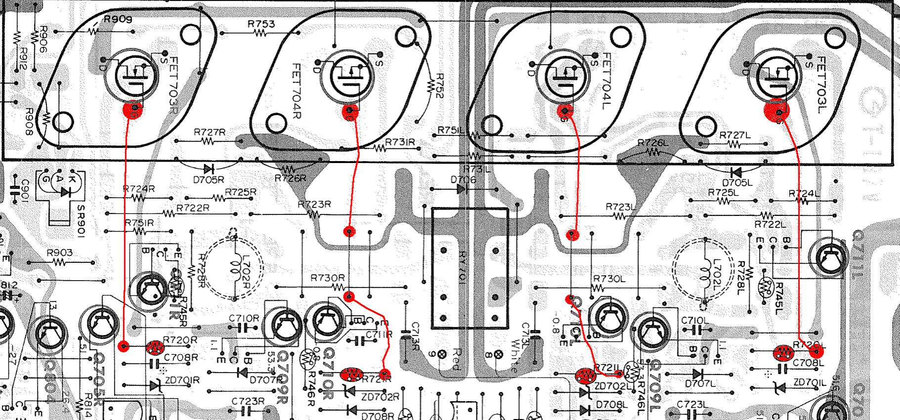

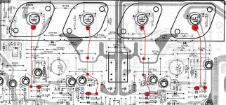

Well, Refitted the Output FETs and now have discovered that there is Still Oscillation, Both Channels; maybe I'll dive back in and have a go with what was suggested a couple of posts back; Perhaps try adding a little bit of Capacitance across the Base/Collector Junctions of Q706 and/or Q707, (just as Hitachi has done in the HA4700 across the Q702/Q703 junctions).
Do You think that this might solve the problem? -- Was rock stable until I refitted those Output Devices.
No magic answers I'm afraid 🙂 Adding capacitance at strategic points in a circuit will often tame instability, but ultimately the reasons why this has to be done really need addressing.
For example, whether it really is a marginal design stability wise, or whether alternate semiconductor replacements have changed the characteristics and altered the phase margins.
