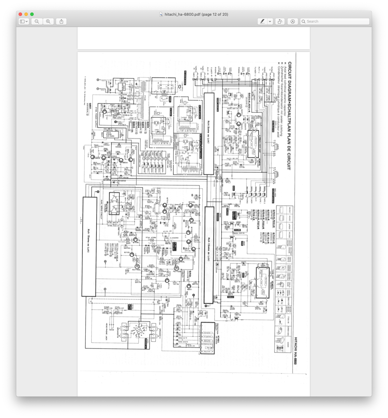

I see that Jonsnell has been good enough to post the Schematic of the amp.

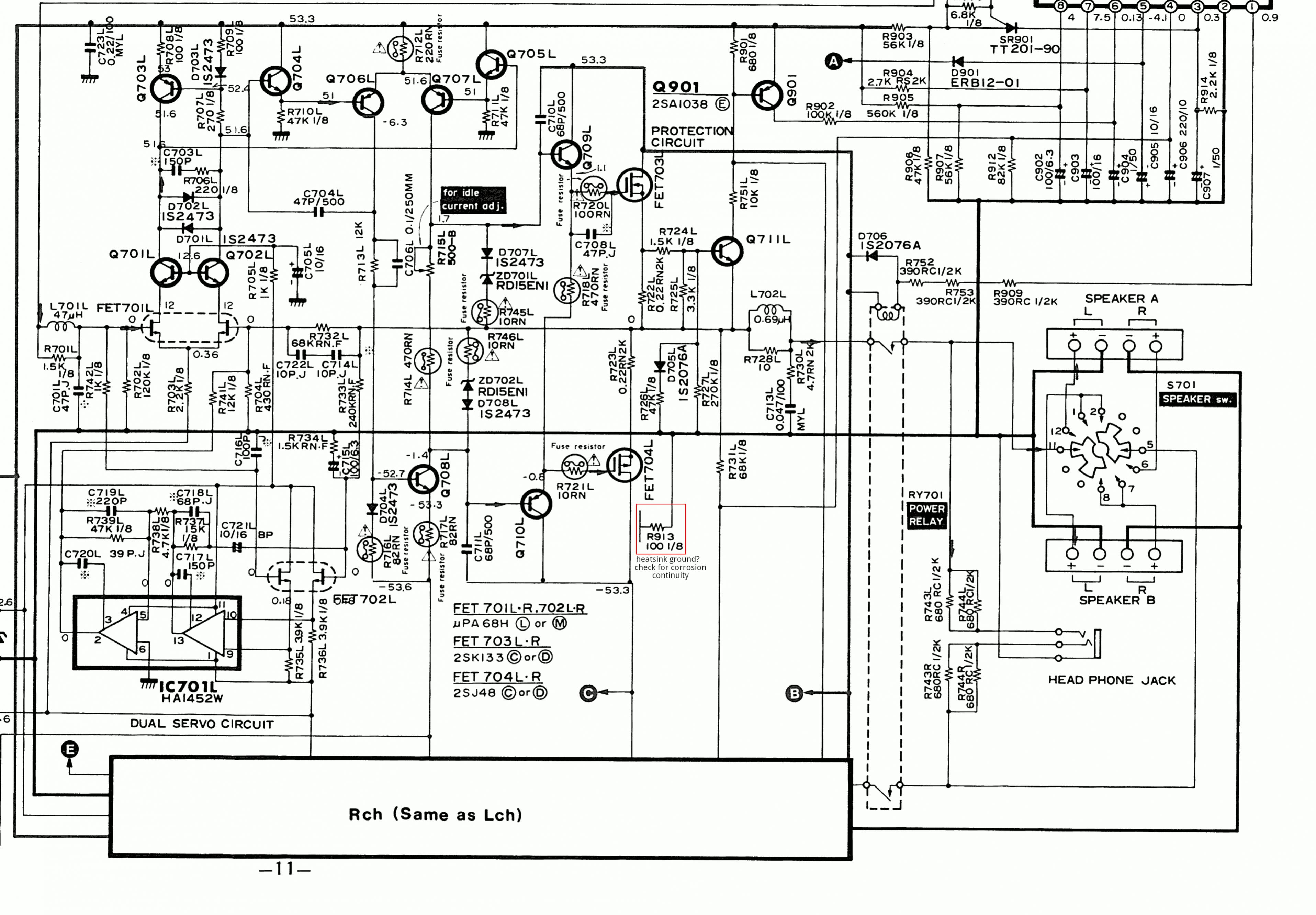

see the attached pic of the power amp section, the red square is a ground for the heatsink?, have have become lose or corroded, as its the only thing i can see thats common for both channels.......other than the protection circuitry.
Another thing I'd check would be the little pF ceramic caps like c722 c714
