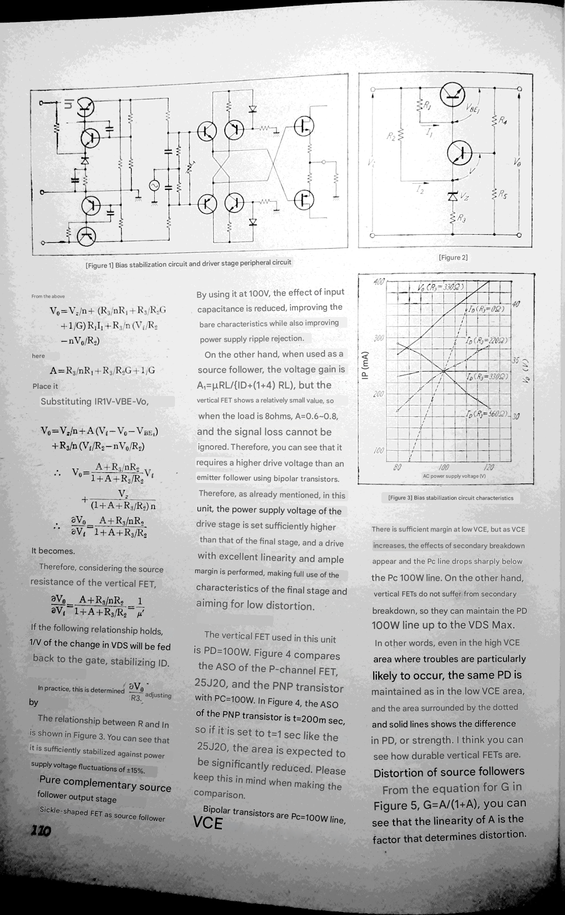

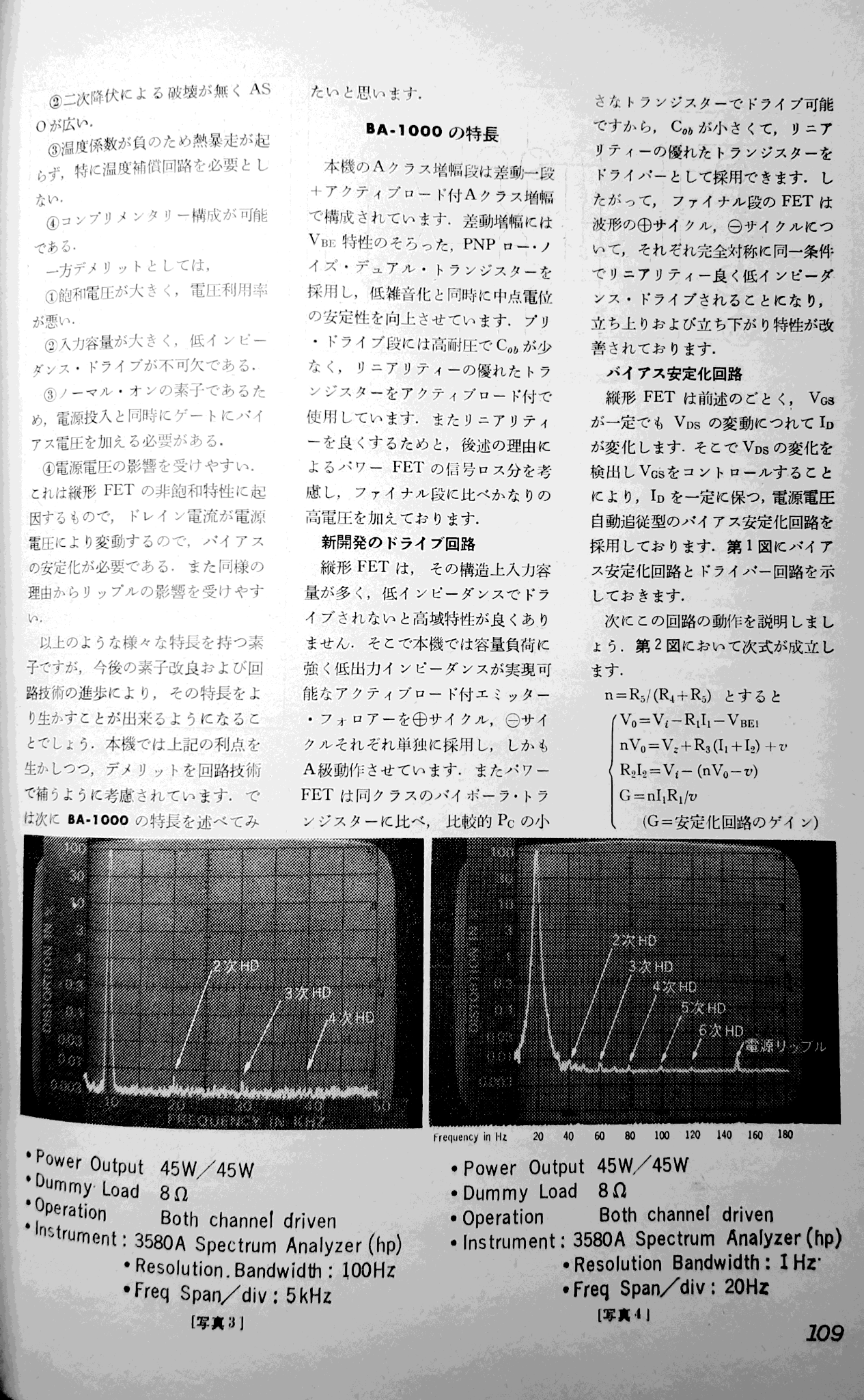

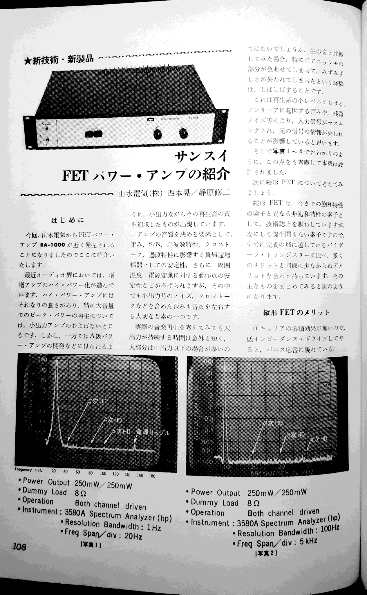

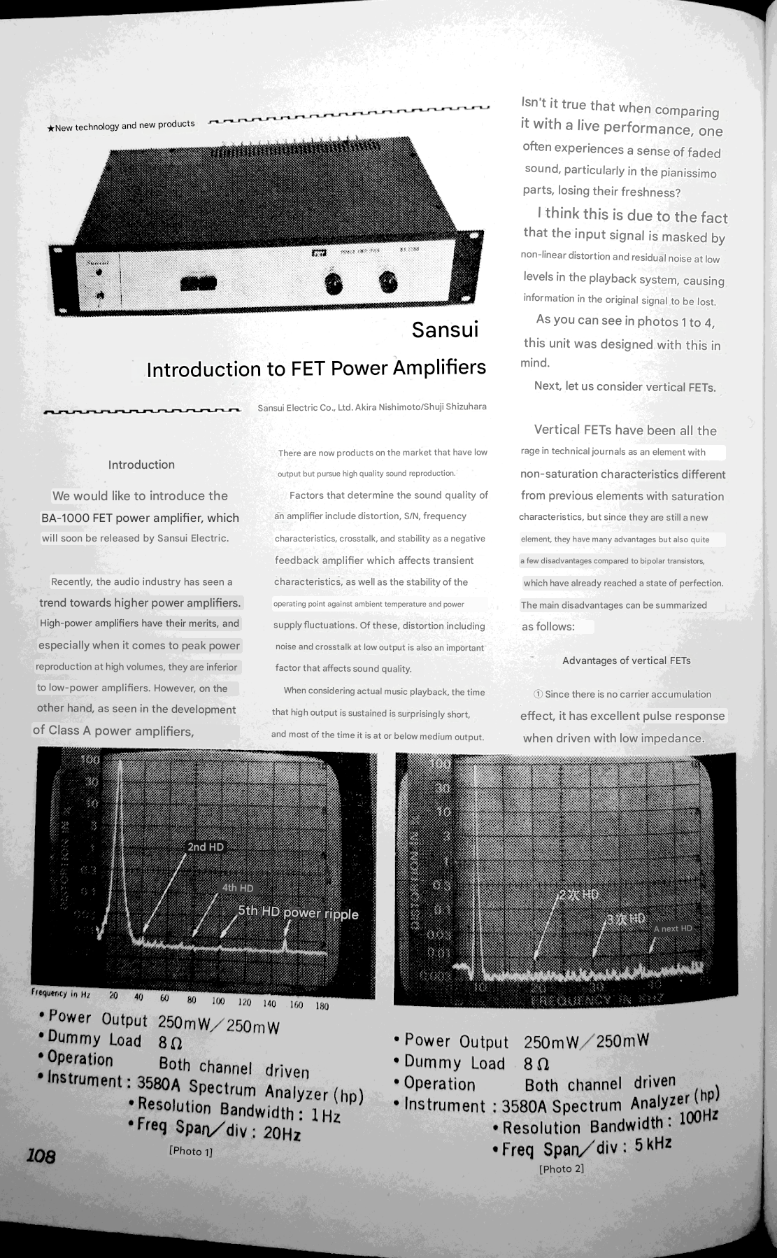

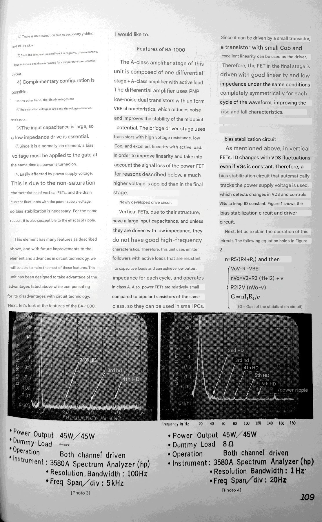

Tough luck - I found the mag but (as I expected) the article in question is just a quick introduction / review of the (then) new Sansui product = no (proper) schematic to speak of...
