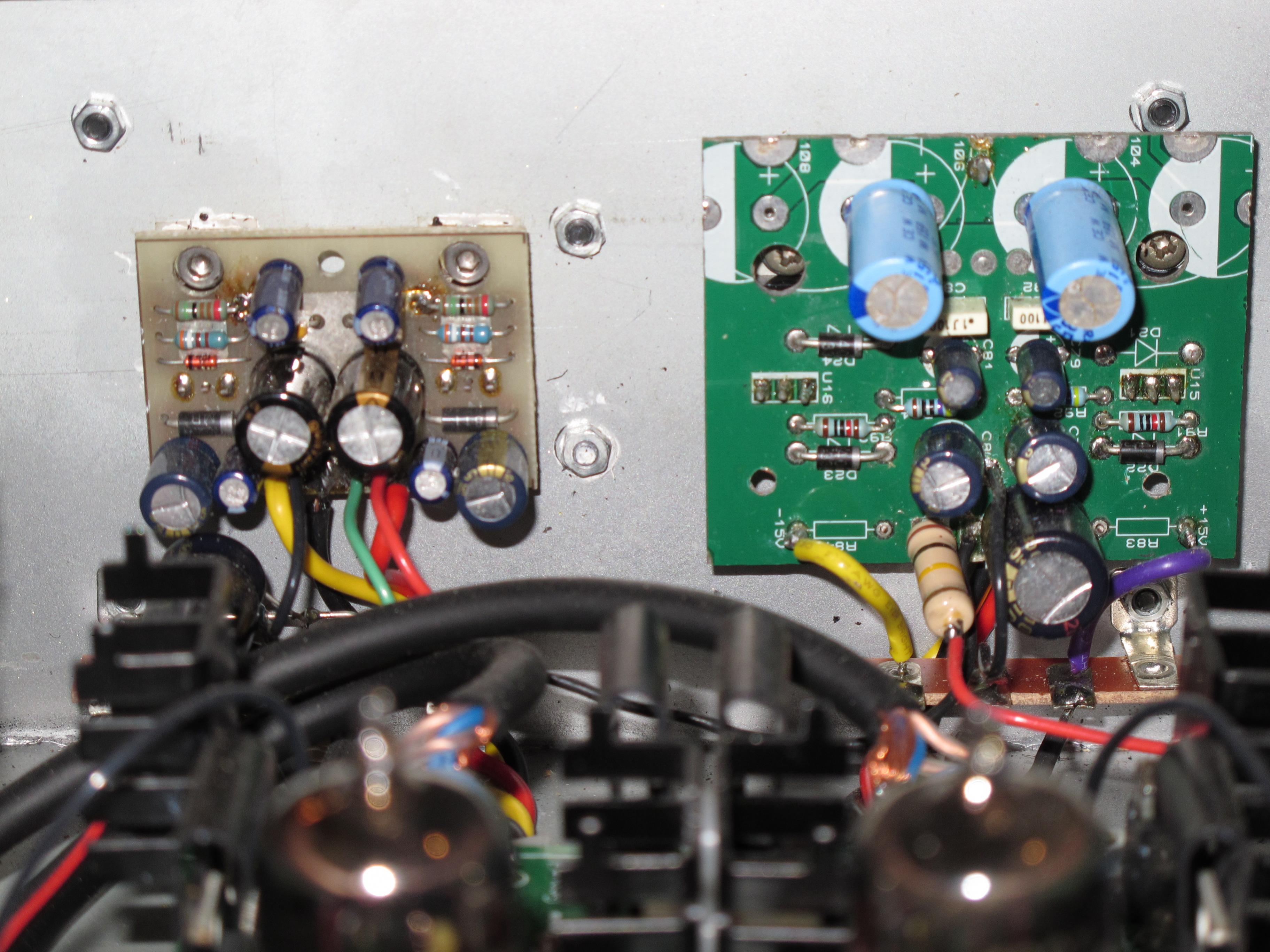

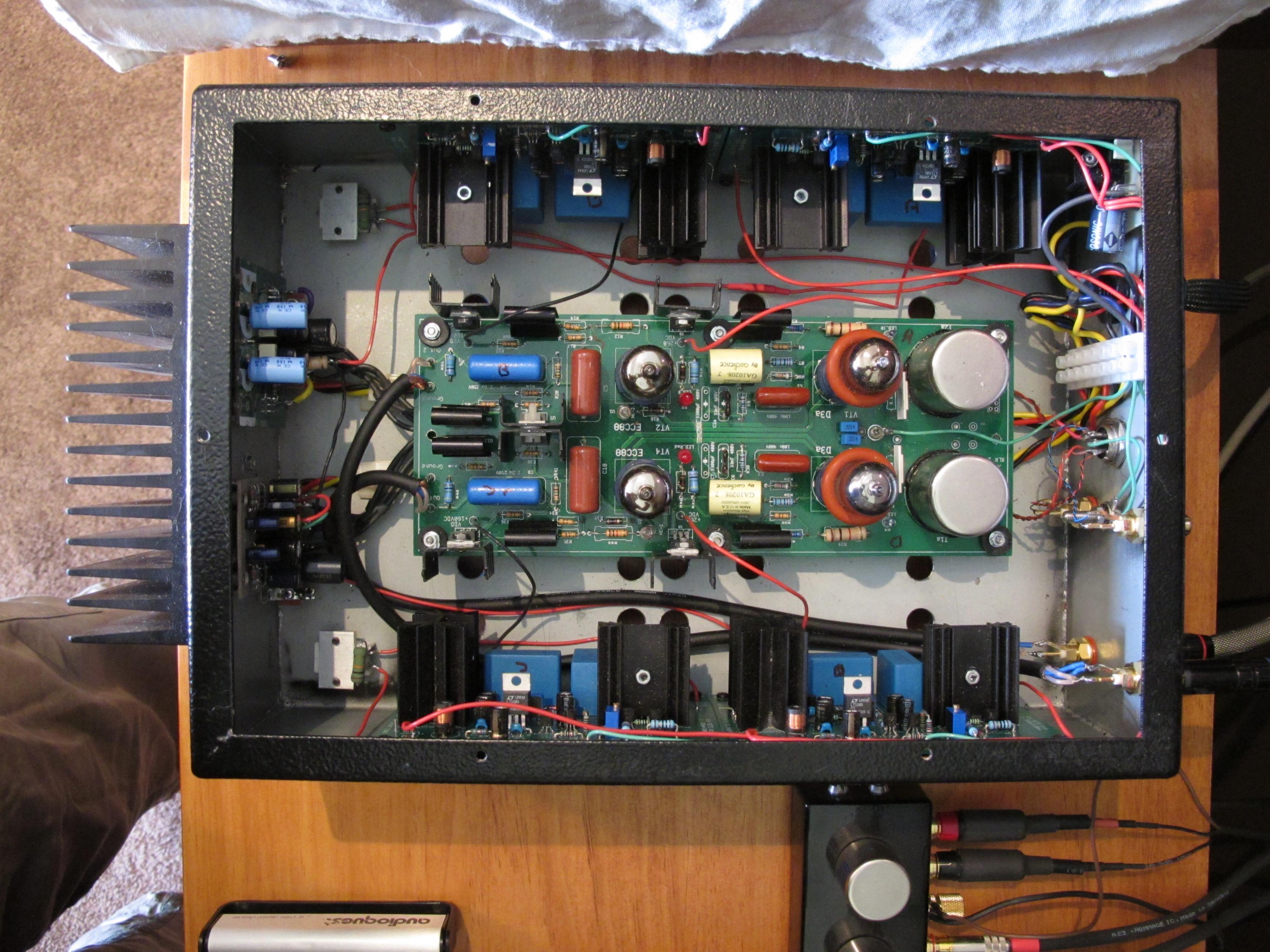

This may be beyond my nascent abilities. See the attached pics that show a break in the traces on the board adjacent to C7. From the wiring coming from the output end of the board, it looks like the two boards on the end of the chassis have been inserted into this break point.
I will have to figure out what these are for.
Any ideas?
Any ideas?
OK, so the photos I attached earlier didnt show up. You can see them here - Flickr: gortnipper's Photostream
