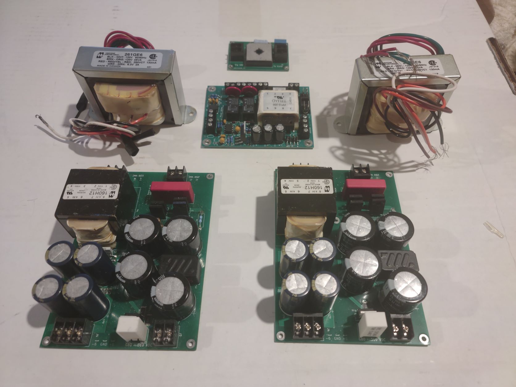

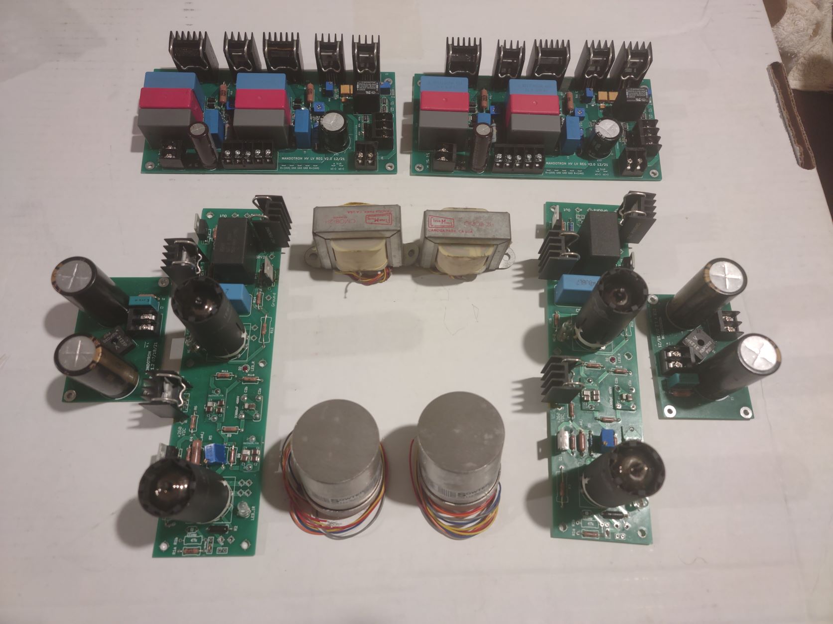

@FJCorpes : All I have is an Oscilloscope at home, The power supplies are very quite. Once built I can take it to work and put it on the Spectrum Analyzer.
@Brinkman : The power supple sections consists of split bobbin transformers from Hammond, a PMillett amp switch circuit. It also allows remote on -off and power fo a remote LED. There is a DC blocker. The unregulated sections for the high voltage uses a Tentlabs filter, and an Elliot Sounds bleeder circuit (godsend). For the low voltage, the capacitors are part of an RC filter. The resistors are surface mount a few in parallel to handle current.
For the Audio section: the regulator consists of an RC filter at the HV input, two Maida regulators with a series voltage drop resistor in-between (in one of the heat sinks). The low voltage has an LRC filter at its input. Since this is bipolar I used a common mode inductor. The regulators are the LT1963 and the LT3080, There are ground loop breaker boards but these re optional - don't think I will need them. The audio board is from JackinNJ. I have added sub board with COG/NPO Capacitors in the RIAA. Want to try these. The input transformer is the Sowter 1480 and the output transformer is the Cinemag CMOB-2H

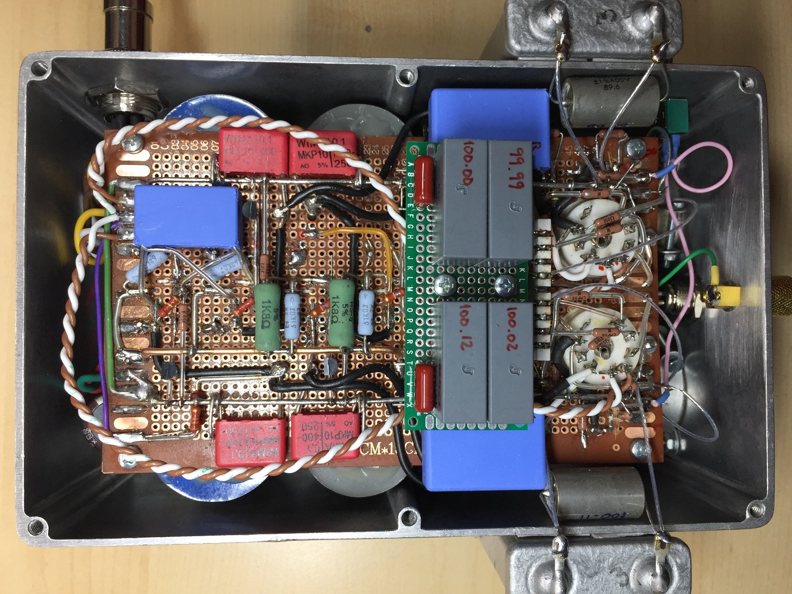

Very cool. I’m making the Equal Opportunity phono preamp but with some His Master’s Noise twists (ie Sowter SUT for MC and some DIY adapter boards so I can use two D3A tubes in place of a dual-triode tube). I also picked up a couple Pete Millett boards to help with my build: his regulated DC filament supply PCBs and his 9-pin tube prototype boards (to make the adapters mentioned above).
