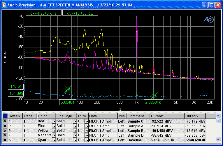

Here's a comparison of D3a's
Wow, one of those D3a's looks really bad! That behaviour is very different from what I get in my measurements. My measurements show a quite clear flicker noise (1/f). In his article, Stuart mentions that "most D3a that I've checked needed some time to burn in before their grid current stabilized". I'm not sure if he was referring to this type of noise or to what? It would be nice if he could intervene in this discussion to shed some light on the subject (and, by the way, make me a bit happy 🙂).
jackinnj, I have built a jig to test the noise of several of my D3a's. My results are slightly worse than yours, I suspect because your Audio Precision is much better than my measurement equipment. However I have some questions:
- Did you measure the D3a's on the same HMV circuit or did you build one specifically for that task?
- I assume you measured the noise at the anode of the D3a, right?

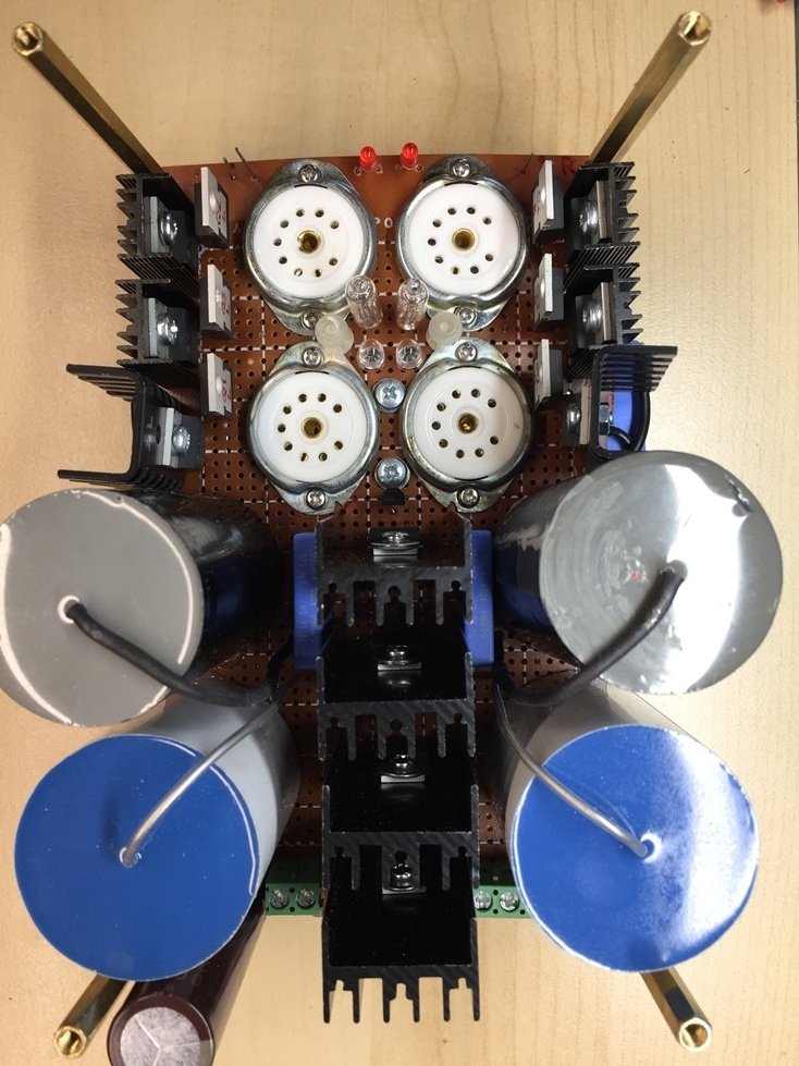

Every time I finish a new HMN, I'm blown away by his sound.
This time I mounted tubes on the top and other parts on bottom.
I have replaced D3a with 6Z11P. This have lower gain and work very nice with a MM 4.5mV cartridge.

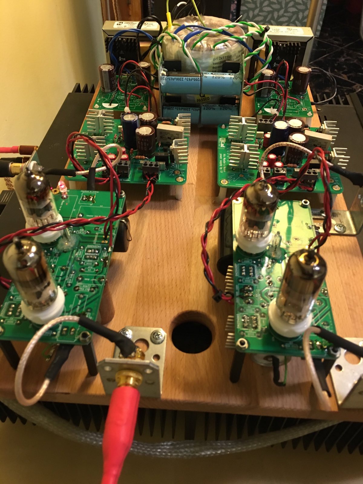

I just finished another HMN. Some pictures here This time I had noise on one channel and I was able to trace down this on DN2540 CCS.
Some DN2540's are very noisy. So far I found three DN2540 with same noisy behaviour.
Tibi

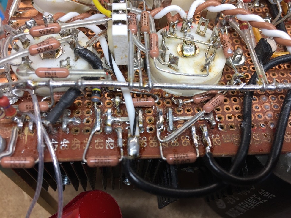

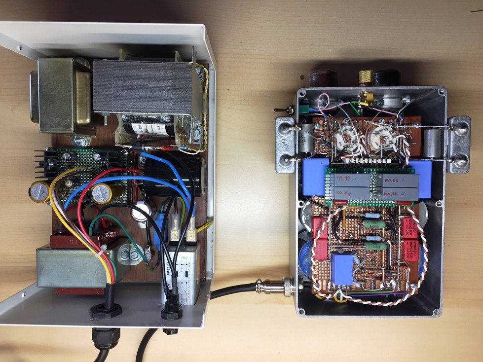

Thanks for your response Tibi. Can you suggest a way to measure the noise of the DN2540 without taking it out of the circuit? It would be a huge hassle for me to remove them from the circuit. I'll send you some pictures to give you an idea... (the last picture shows how the CSS has been implemented)Francisco,
In my case the noise was coming from one DN2540 and this was happening three times in three different phono's. I suggest you to measure each CCS.
On the next phono I'll take more time and make some measurements, but till then I suugest you to look at CCS's.
Regards & Merry Christmas !
Tibi
The reason to make everything so tight is that the phono has to take the original place of the preamp in an EMT930 turntable.
Francisco
