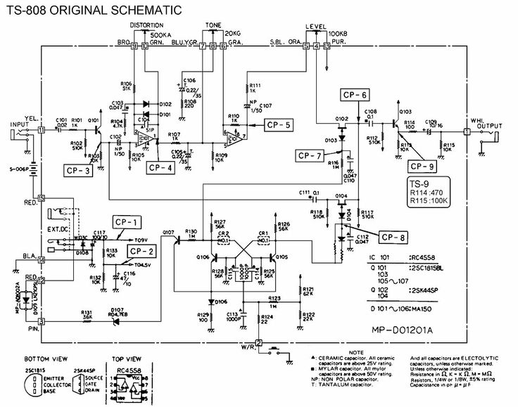

Well, we could talk about opamps in circuits such as the one in the attached image. Sounds great for many things and is quite famous.
Also, notice the .22uf tantalum capacitors in the tone circuit. Gotta love that sound! 😀

PMA, if you mean in the musical instrument circuit, op amps often sound very different when not used conservatively relative to their specifications.
Nonetheless, useful circuits that may sell a fair amount of product can result.
