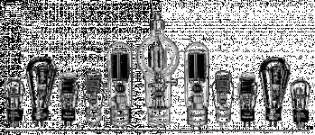

12AY7
Would you believe I could fill half a page telling you about the history of that little tube alone?
And I do mean the history of the one in your picture, not the generic 12AY7A...
So, you're telling me you know your tubes too?😎
Cheers,😉
Cheers,😉

Frank,
I just picked a tube at random, I bet more appealing than the centerfolds in the Playboys' you have stashed under your bed.
I have built a few tube preamps 12AX7's and 6DJ8's, sounded good but I needed better bass.
Jam😉
Jam😉
