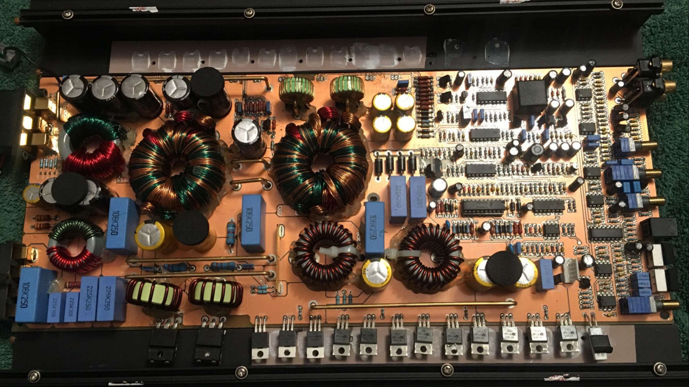

It just occurred to me that a picture of the board may be helpful but I can no longer edit my initial post. Please forgive the fact that it's backwards in the heat sink and the PS FETS are missing. The board is safer in the sink thank out when I'm not working on it.

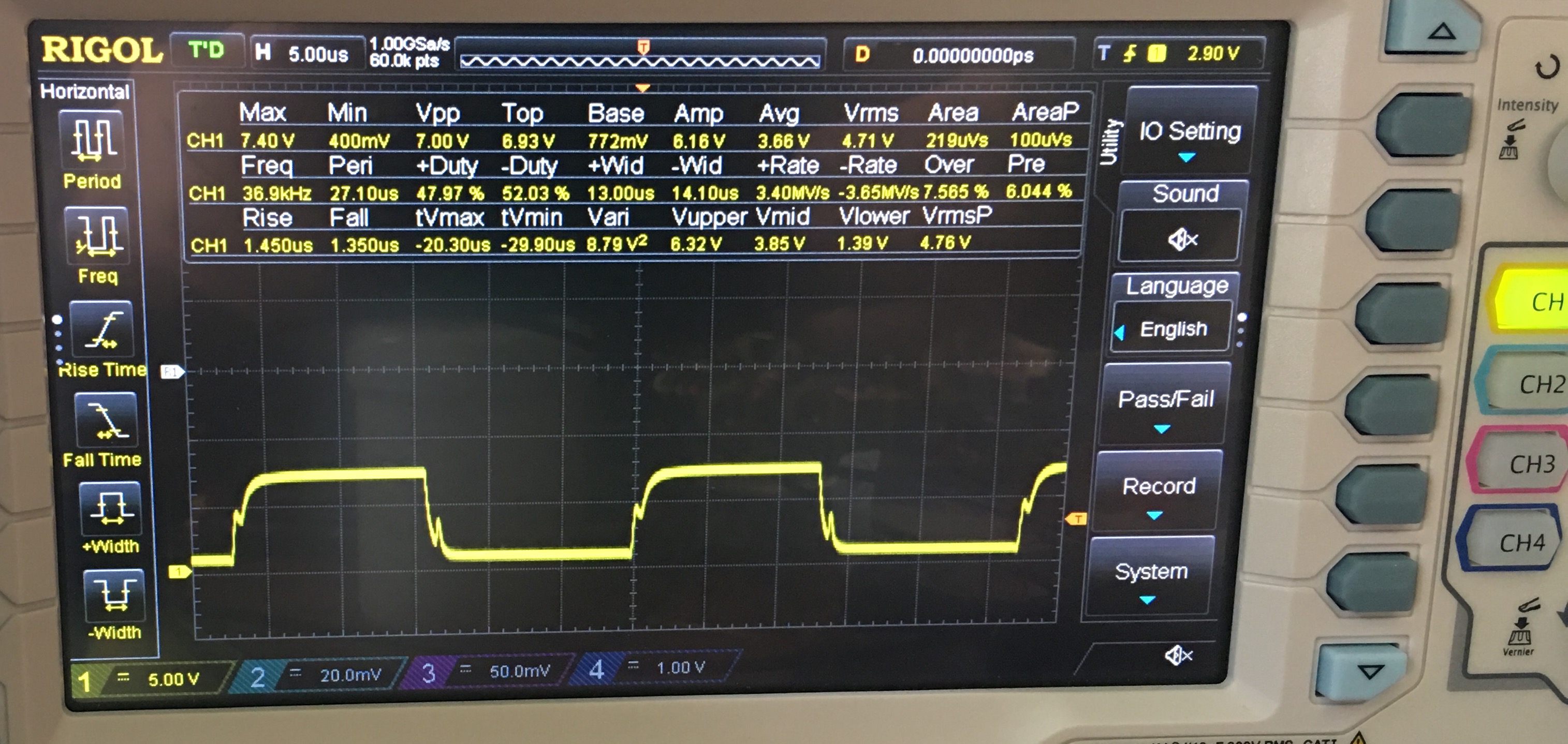

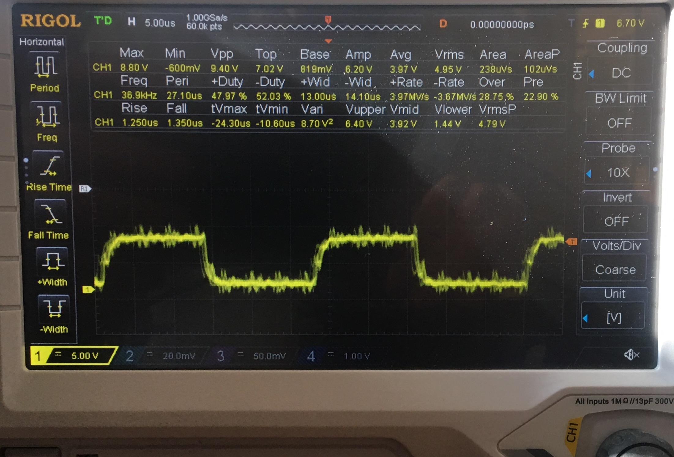

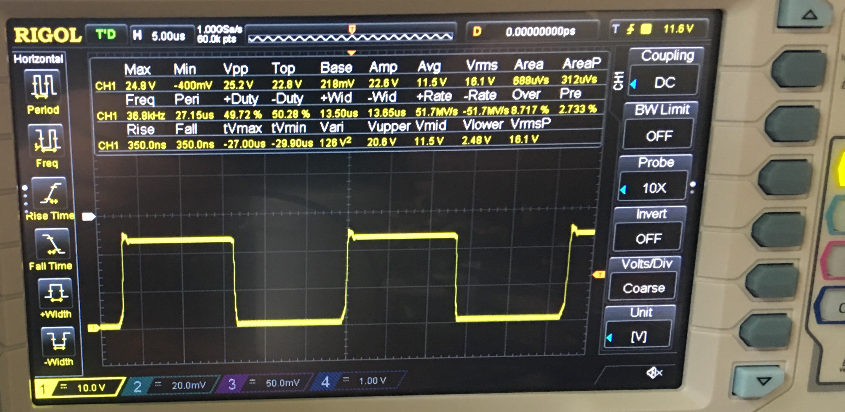

Attached is a picture of the drive wave measured at the gate, the amp is powered with 10v. All 12 gates look to have an identical signal, I can upload 12 pictures if needed. There is some noise in the signal, I'm not sure if it's from my cheap power supply or if there's an issue with the drive signal.
The second picture is what the drive wave looks like when it reduces to a duty cycle of "zero"? as I increase the voltage from my power supply and the transformer starts buzzing.

What's the resistance between the source leg and the primary ground terminal? 0 ohms?
The issue is that it's not 0 ohms impedance to high frequencies.
There should be no inductor in series between the source legs and ground.
It's not safe to ground the scope to all source legs but on a push-pull switching power supply, it's safe (except the MTX types that use a gate drive transformer and 'follower' type drive for the transformer).

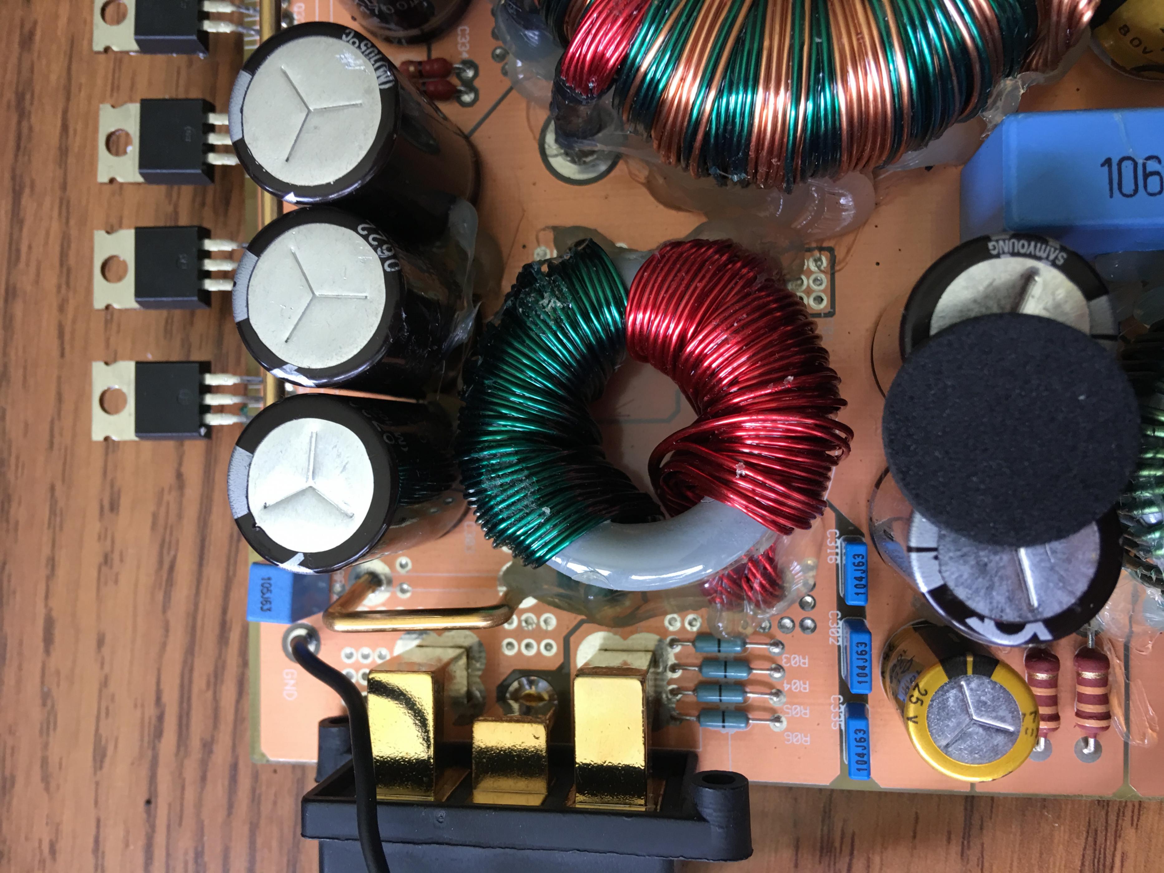

The inductor I referenced is pictured below. Perhaps "inductor" is not the correct term.

This is the waveform with the scope connected as per instructed.

Ah yes, choke would have been a much better word choice. My apologies.
I included the waveform you requested in the above post, perhaps I shouldn't have edited it in. Being new here I'm not familiar how much double posts are frowned upon.
As you explained, it looks much cleaner with the scope connected correctly.
Double posts are bad but posting the photo twice would have been OK.
When I see a new post for a thread (bold text), I only use the green arrow to go to the last post (almost without exception so it's good to mention if you made edits or multiple posts.
The waveforms look different from 10-13v because the rail voltage is regulated (something else that's relatively rare in amps like this unless the rail voltage is near the upper limits for the output stage driver IC).

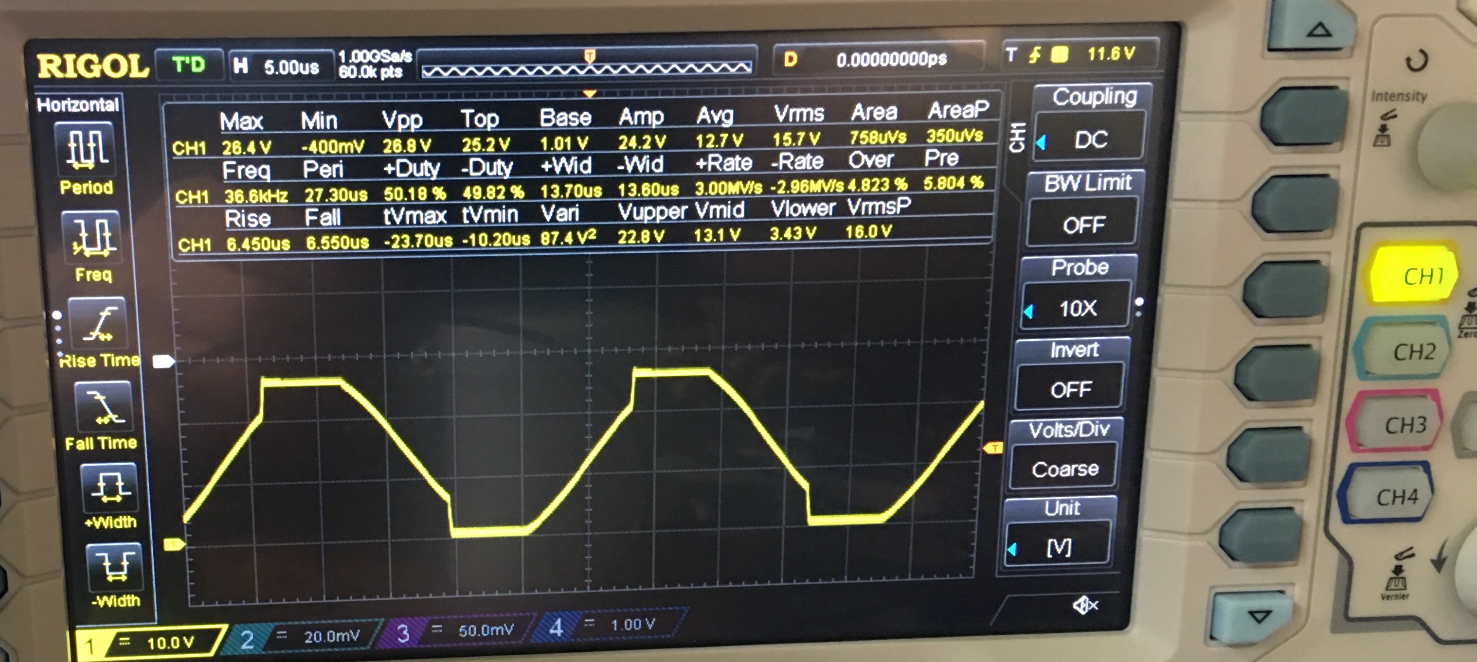

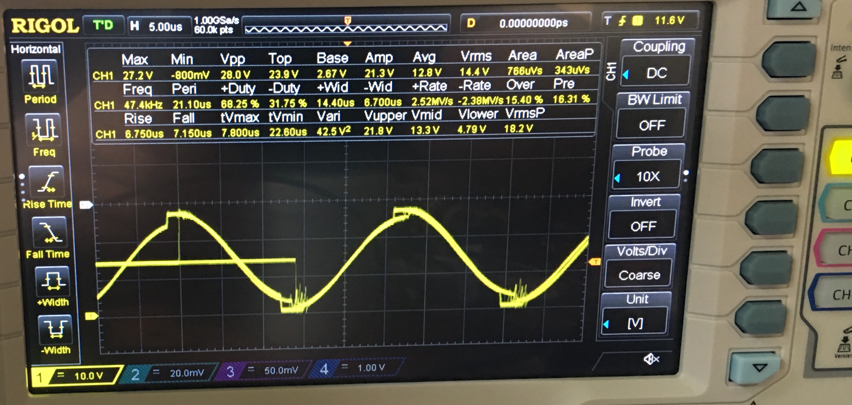

While I'm asking questions, these are the waveforms on the drain at 11.4v, 12.6v and 13.5v. Does this look abnormal for a regulated power supply? (13.5v has transformer noise, the others do not.)
