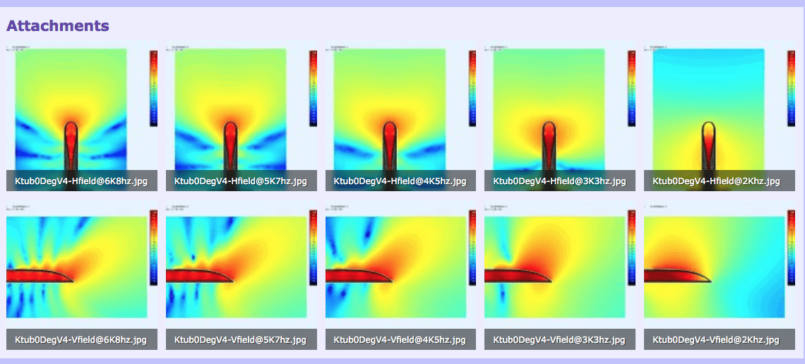

I've toyed with the idea of running a K tube instead of a WG above 3k. @freddi I know he swears by them for getting extended top end from a 1" CD, but I've never given it a serious thought past a quick listen.

The K-tube is a diffraction horn with bizarre dispersion patterns and peaky response.My only apprehension with the SST1 is that fact its a diffraction WG. I've heard the B&C ME20, which sounded very good at lower SPLs, but when cranked up, it has that sizzle commonly experienced diffraction WGs.

https://www.diyaudio.com/community/threads/3d-printed-k-tube-for-1-compression-drivers.344571/page-2

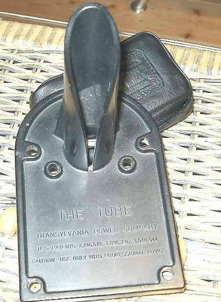

https://patentimages.storage.googleapis.com/a2/33/52/7e84065907a786/US3540544.pdf
I still recall hearing a 2" Transylvania Power Company Tube used in a PA back around 1978, first time I'd heard a JBL 2440 used in a mains speaker feeding back at 10kHz, an octave above the SM-58 "presence peak".
Can't find a photo of a 2", but looked pretty much like the 1":
Printed on the mounting flange:"CAUTION-USE ONLY WITH PROFESSIONAL ADVICE"
Consider yourself warned 😉
Art
(I should have clarified that I was recommending the compression driver - not the K-tube for this application)
Re: dangers of the mighty K-tube being used w/o professional assistance - have 5 of the Transylvania Power Company "The Tube" and have survived - other than paralyzed vocal chords - tumors on both kidneys - blood sugar which can hit " near 600"- vision which no longer converges, (look like Jack Elam) "etc" - although those slight ill effects may come from some other source (????)

A K-tube that size needs no EQ as there's little gain on the bottom plus the top octave's dispersion pattern as presented towards the listener's ears is narrowing.

The ktube does have an odd pattern. I don't know if that's useful for PA purposes. I have heard one before and vaguely remembered liking it, but that was a long time ago.
