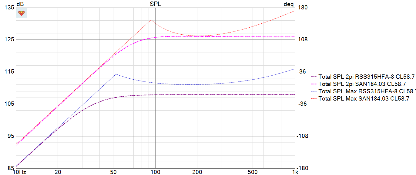

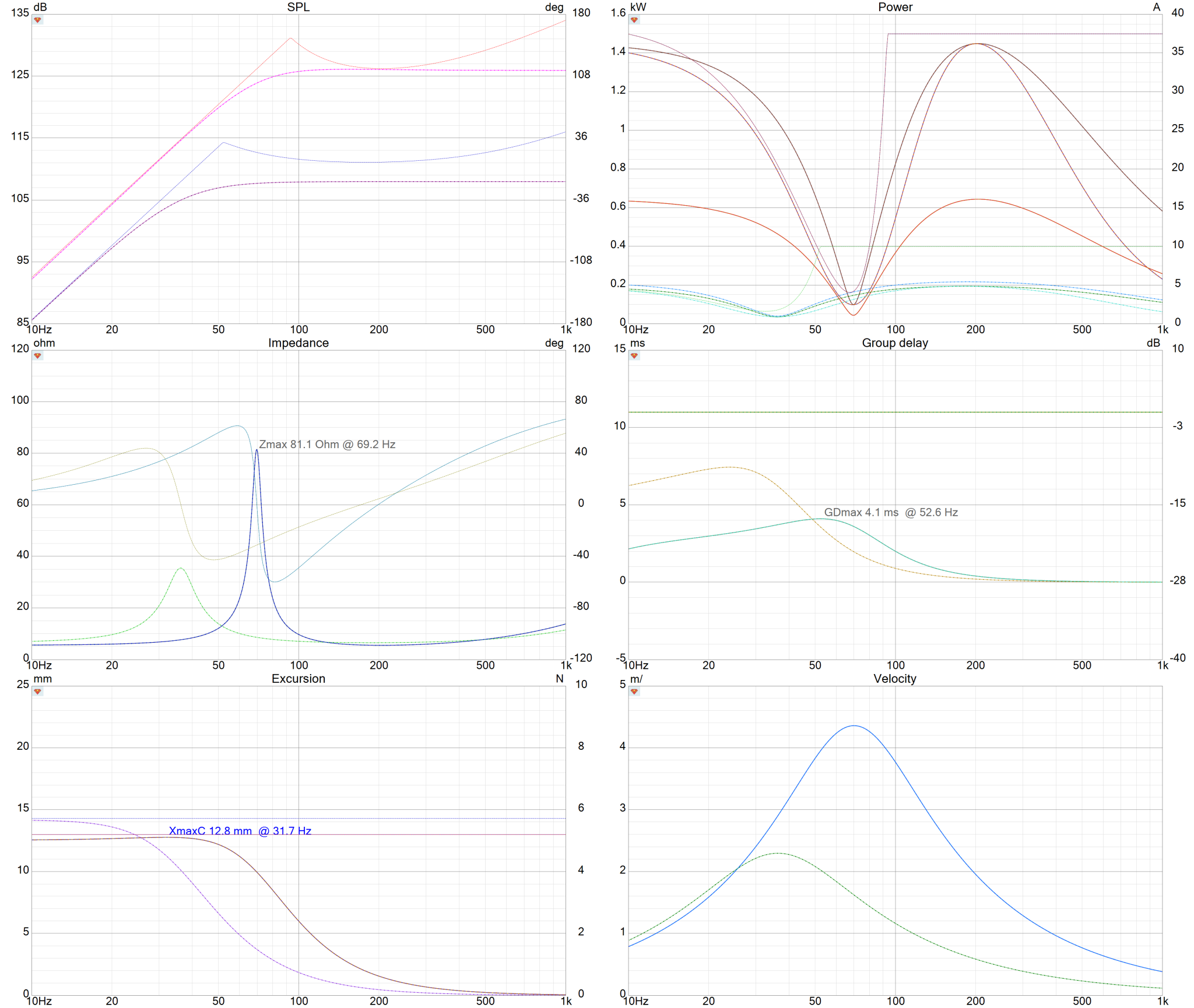

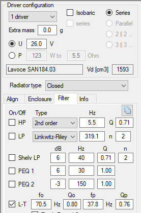

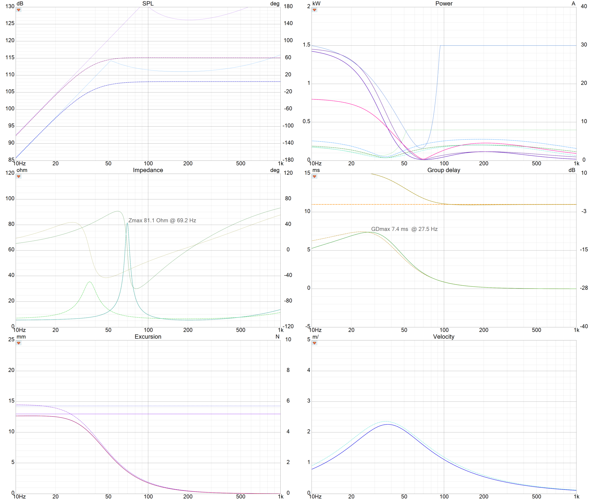

My modelling program seems to like it.
vs Dayton RSS315HFA-8 in box just over 2 cubes. No EQ:
A little Linkwitz Transform later:
Just as deep and extended. 8dB more output. Same volume box.
