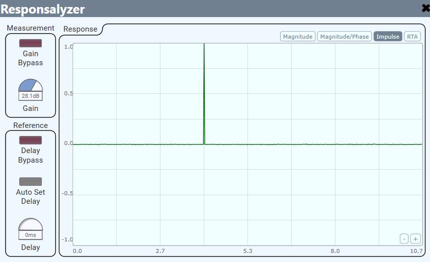

I'm going to give a stab at what i think Camplo meant by sharc fin, and try to tie it to what i was saying about impulse pulses and Dirac.
First, here is a Dirac pulse, the impulse response of perfectly flat frequency response (mag) and perfectly flat phase at zero degrees.
(t=0 is set at 4sec to move it off origin to see it better)

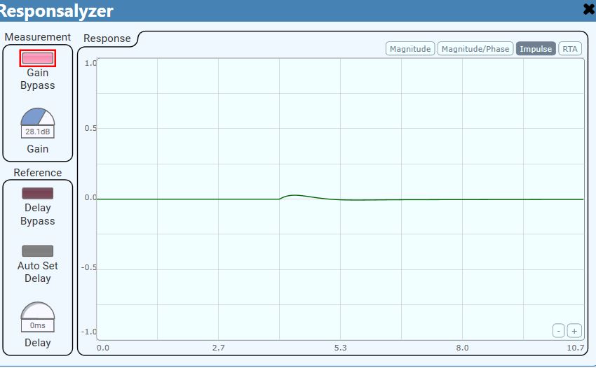

Now here is a xover representing a somewhat typical sub, with 12dB low end rolloff at 30Hz, and a 12dB high end rolloff at 500Hz.
Note the impulse's 'sharc fin' look. (same t=0 at 4sec)
Also note the impulse was magnified upward with a +28 dB gain !!
Here's the same impulse with no gain added, taken at the same line level of the first Dirac impulse.
It shows how little the contribution of the bottom end is to a full range impulse response.
I so recommend full recognition that perfect mag and phase= perfect impulse response = Dirac pulse = perfect transient response = correct timbre / harmonics, etc, etc.
It also has helped me to visualize the timing implications of that perfection between frequencies.
By timing implications, i mean knowing what part of the frequencies waveforms are all in phase, peaks or starts? Once you see this, you've got it !.... ime
Perfect mag and phase, or perfect impulse, is the straight ruler all our measurements are based off.
