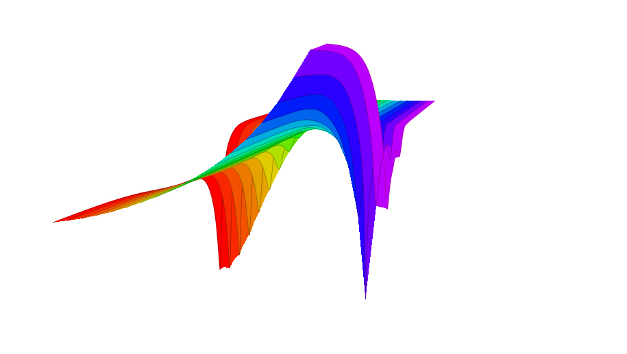

Thanks for the replies and allowing me to play devils advocate on what I think is a somewhat controversial topic. I like the idea of taking impulse/step response measurements at different levels, as well as, taking FR at high level duration....I can't be first to think of it but I like to fancy the idea...Just like QTS is measured at fs, but is only snap shot of the performance at one stage out of many (because Q changes with frequency)...IR and step are checked at 1watt but this too is just a snap shot and this variable changes with magnitude.
I'd really like for us to start benchmarking systems using this metric...I don't know if anyone will entertain me...even if just out of curiosity. If you think about it, IR/Step at one watt is removed from what one might here during a listening session. Taking a IR/Step measurement at desired listening level (90db for example) is an interesting measurement if you ask me....and just like polar measurement can displayed in VituixCad as a cascading line graph, I'd like to see something similar become programing in software that we can see the IR/Step response shape shift from 1watt and increasing....if we can name it after me, even better lol
1watt, take snap shop, 10 watt take snap shop, 20 watt, 30watt, so on and so on....then display the shapes cascading in 3d, from origin to final sorta like this
attachment.php
If I could provide you a graph it would show the Impulse/step response at each interval, 1watt all the way to max desired test wattage...this graph will expose what happens when the transient starts losing its original benchmark shape of 1watt. Smoking what I'm putting down?
You seem to be suggesting that the response will be flat at the lowest levels, resembling the test signal. Were you just 'playing devils advocate'?
I am suggesting the IR/STEP response will not be the same at (>1watt or <1watt) vs (1watt)
And that this measurement taken at a level resembling desired listening level...may be of use?
And the characteristical change we witness from low level to higher level input may also be of use?

Imagine the IR of a driver with 100db sens, tested at 90db vs a driver with 85db sens tested at 90db (all other things being equal or logical?).... anything unique happen? Too many variables to see a trend?
lets say at one watt both drivers have an equal IR....at 90db.... do we see a trend?

the difference we see in the "graph" from 1watt to desired level is the meat. Its the same as measuring FR at multiple levels is what you are telling me I guess...
I guess I am focusing in on the deviation of Fr from 1watt to desired listening level...in a detailed way. Looking at the IR is more telling for me than looking at the FR
A raw impulse response is dominated by high frequencies and is not that easy to interpret without filtering or transforming into something else.
Many people have measured drivers at different drive levels, the frequency response is always very similar until some sort of compression sets in.
