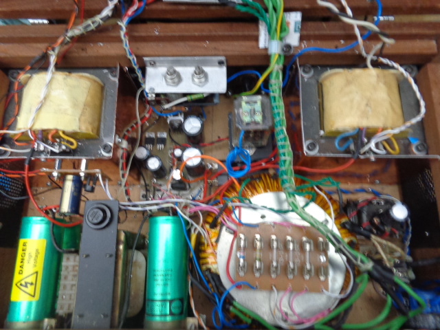

I downloaded all the info for both your amps a number of years ago, but never got around to doing either. I'm in a position to build Vixen as I have a surplus of both 807s and 1625s, and all the others bits and pieces. Did you ever have any thoughts, given the cathode follower, about a PPP and if there are any changes or additions you'd make to do that? (I have the appropriate OPTs, and power transformers for a PPP so that's covered.)

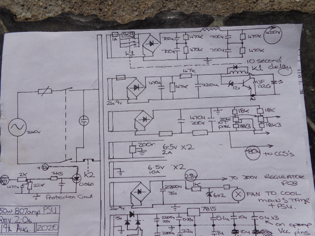

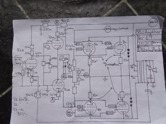

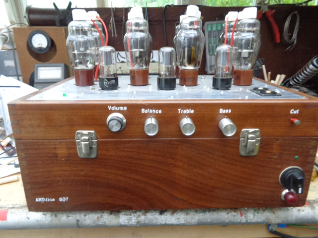

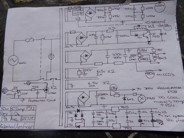

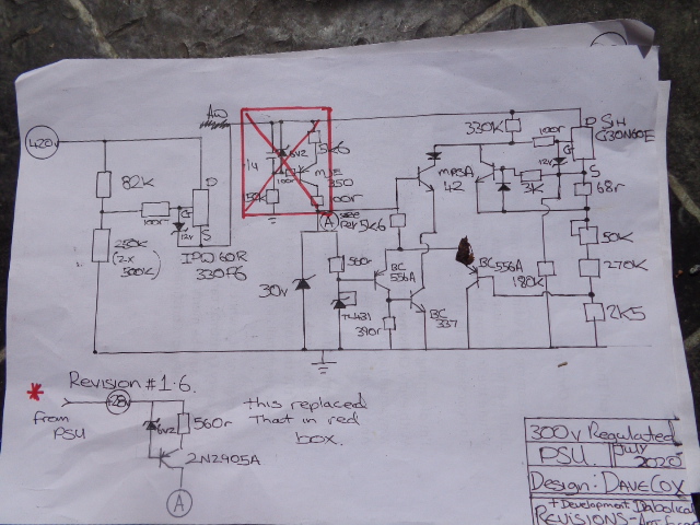

I built an 807 PPP last year, sounds wonderful but it might be a bit complex for first time builders, essentially though it's similar to Miles's amp's, 6SN7 front end and PS with CCS, four 807's, custom OPT's regulated screen grid PSU. Used ESP's preamp using 5532's too. It could be simplyfied though leaving iout some of the extra's. Posted schematics for anyone who's interested. If any other details are needed drop me a line

Protects the 807's if any pull too much current if a fault occur, EG like going to gas, spikes etc. If any 807 starts pulling more than 28w then voltage across Rk 10r sense resistor goes up, this triggers a thyristor which in turn energises the relay K2,which in turn cuts the neutral mains supply thus turning the amp off.
