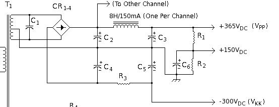

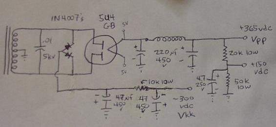

I'm finally underway on this project, and have a quick question:
I notice that this PS uses a full-wave bridge and provides B- voltage on the "left" leg coming from the full wave bridge. I've already drilled the chassis and am using a 5U4GB for the "right" leg, (into the choke and to the vpp & 150vdc
Would there be any major concerns if I used two 1N4007's as the "left leg" of the PS supplying the B- (Vkk) voltage?
The Vkk supplies low-current cathode voltage for the 6SN7 driving the 807's, and R3 is 10k, but not any plate current for any tubes.
Like this:
This would avoid a second tube, for which I don't have enough filament amperage, and also I'd like to keep the 5U4 for the main B+ of the PS for the "slow warming effect" and avoid a standby switch.
I presume also that I should probably use a 47uF cap for C2 to prolong the life of the tube.

Frank 754,
There is no problem using silicon diodes as you have drawn. It in fact saves you two tubes, as the cathodes are no longer tied. But I would regard the 1N4007's inverse voltage spec as a little low for comfort. If I am correct the transformer is a 350-0-350V type (don't see it here). The maximum inverse voltage across the diode in this case would be 2(Vp), or 2 x 495 = 990V. The 1N4007 is rated at 1000V.PIV. That allows too small a margin for spikes, variation in mains voltage, etc. I do not know what is available near you, but would look for a 1.3 - 1.5KV diode - as you say current is insignificant; they are mostly 1A or higher.
C2 of 47uF would be advisable. Then, so that you are not misunderstanding, the 5U4 as I know it is a directly heated rectifier; not much of a slow warming effect there - barely enough to not overstress the filter input capacitor. If you need to avoid a peak charging effect before the amplifier tubes have warmed up (also cathode stripping to a degree) you would still need some way of delaying h.t. on for about >13 sec. A 5V4 or at slightly lower current capability, 5AR5/GZ34 would be a better option - but you apparently already have a 5U4.

frank754 said:Would there be any major concerns if I used two 1N4007's as the "left leg" of the PS supplying the B- (Vkk) voltage?
I'm afraid that there is a concern here. The negative rail, being solid state, is going to come up very fast. When it does, the 6SN7 drivers will still be cold, and you're gonna hit the cathodes with 300V. The Vhk rating (heater positive) of that type is specced at 100V. I don't know how much of that they can take without a flash-over. Of course this was not a problem with the Vixen design since that one is wired specifically to allow for heater preheating before you hit it with the HV.
My current project uses a very similar PS (SS negative rail + 5U4GB positive rail) however, this design includes regulated heater DC and that PS is floating, with no connection to the DC neutral. This being done to prevent the problem of H-K breakdown when the negative rail comes up.

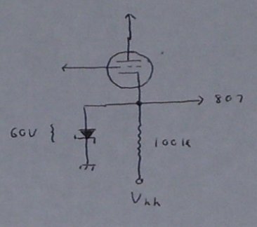

Here's another solution to the problem (attached). Here, use a 56V / 0.5W Zener. This will clamp the cathode to a safe voltage until the 6SN7 warms up. Once it's warm and drawing current, the Zener will drop out since the bias for the finals is ~22.5Vdc.
OK thanks, Johan & Miles, as far as the xfmr goes, it's a 300-0-300 not a 350-0-350, but will look for higher rated diodes (than the 1N4007's). But am considering a 6X4 now (see below).
For 600v the combined RMS should be only around 850v though.
The Zener "soft start" idea is another good option, which I overlooked. Short of that I could still put in a standby switch for the HV, since all the tubes are on a separate filament transformer except the 6J5, 6CB6 and 6AQ5 (the preamp, and the ones in the bias regulator circuit).
The third option which I like, and would keep the unit "all-tube" would be to add another tube. I have tried to avoid another octal on the chassis with making it too crowded (and also I don't have enough 5v filament amps for two 5v rectifier tubes), but I've just been thinking, how about using a 7-pin 6X4 tube instead of diodes, for the "left leg" B- ?
The 6X4 is rated at 1250 PIV, and can handle a bit above 75ma of load per plate at 300-325v RMS using a capacitor input filter.

frank754 said:OK thanks, Johan & Miles, as far as the xfmr goes, it's a 300-0-300 not a 350-0-350, but will look for higher rated diodes (than the 1N4007's). But am considering a 6X4 now (see below).
How is that going to work? The 6X4 has a common cathode and separate plates. You can't wire it for negative volts unless you connect it as a half wave. If you do that, then you'll need a different negative rail ripple filter since you're cutting the ripple frequency in half, and making the filter half as effective.
I was considering using it as half-wave, but also wondering how it would affect the usability (and result) of the Vkk voltage, and how it would affect the audio as half-wave. Was just doing some research as we speak. So thanks for the quick feedback, Miles.
Noting also, that on the negative rail you were suggesting an R3 of 10k 10w rather than another choke for that side.
There aren't too many tubes with separate cathodes, with the notable exception of the 6BY5 (of which I have none in stock), and a few others at higher filament voltages, and those seem to not be able to take the HV at such a high level.
Also, using two 6X4's would probably be overkill and a waste of transformer heat, as well as requiring two more sockets, not to mention the voltage drop.
Also wondering, if I did use it as a half wave, though it has a cathode separate from the filament, would using the same filament supply voltage as I will for the 6J5, 6AQ5A and 6CB6A create any malfeasance as far as bleedover distortion (or worse) from having the direct AC HV at the cathode (that nearby) and using the same 6.3v filament supply?
Before abandoning this approach and going back to the diode method for the negative rail, are there any dual triodes (for example) with separate cathodes (6SN7 ?) I could use as a rectifier for this negative side, ignoring the grids (or strapping them to the cathodes) and just using them as rectifiers? (seems like this type of circuit is a rare breed for tube aficionados and even when done, usually suggest a third filament supply.)
Probably best to scrap this idea and just go back to the diode plan. 🙂

Miles is correct regarding the heater-cathode voltage, with an admirable solution. Sorry, I did not see that one (I did not have the circuit in front of me then).
Half-wave for bias is used here and there but then with about no load current, i.e. one could use high resistor/capacitor values. I have not seen it lately because of the convenience of si-diodes.
Your thought of using dual triodes as rectifiers is a nifty one, but again the maximum heater-cathode voltage rating is ruling this out. I have not seen the peak inverse voltage of triodes specified, but as said, a no-go for the former reason. (In days of yore when no adeuqate si-diodes were available, I once had to use three 5V heater windings for three GZ34s in a bridge!)

frank754 said:Miles (if you are around)
On the feedback circuit, I'm not clear which line on the OPT you have the resistor & coax wired to. I have terminal posts for both the 3.5 and 8 ohm taps (for 2 spkrs in parallel or 1 speaker), but there are also 16, 250 & 500 ohm taps on the 1650G, my guess is the 8 ohm tap. Also, I might try tubelab's idea of variable feedback, perhaps a 500k pot instead of the 330k resistor, how much wattage would this pot need to be and would placement be very critical (i.e., as close to the OPT lead as possible with a very short wire going to it and the coax from the pot to the 6J5?), with the shield grounded only at the 6J5 end, of course.
The gNFB is taken from the 8R tap of the OPT since I'm running 8R speeks. If you want to try variable feedback, a conventional 24mm pot will do nicely. This should be wired at the 6J5 end, and not at the OPT end. Ground the coax shield at the 6J5, but not at the OPT.
I made the plate stopper coil/resistor assemblies under the chassis soldered between 2 lugs of a terminal strip and then have thick auto primary wire going to the plate caps. I used bare #18 copper wire and they turned out a bit longer (maybe 20% or so less than 1uH), should this be ok?
Give it a try and see. The coil dimensions should be OK. As for the placement, if that doesn't work out you can always move them.
I will have to order the 56v Zeners from Allied, to protect the 12SN7 from the Vkk with the filaments cold. In the mean time, can I just temporarily put in a standby switch to stop the Vkk from getting to this one place in the circuit, all other HV lines coming up normally from the 5U4 side?
Don't get over eager there. Trying to disconnect the negative rail will leave both the 6SN7s and the finals with no operating bias. That's an open invitation to poof something. Wait for those Zeners before trying to power up.
For the filament supply for the 6AQ5A & 6CB6A, I had to use a separate one from the other tubes. I only had left the main 6.3vct line from the main PT that was unused. I connected this to these filaments, and ran your C5 to ground and R8 to the 150vdc to the center tap. Can I also power the 6J5 filament with this setup, or do I need another filament transformer just for the 6J5, or can I add another resistor to compensate if need be?
The 6J5 has a 90V H-K rating and won't take 150V at its heater, so don't run it off the same heater tap as the voltage regulator tubes. It would be better to connect a 20R / 5W resistor in series with the heater and run it off the 12.6V heater supply. Even better would be to split that resistor into two, 10R sections and put one in series with each end of the 6J5 heater to maintain balance for possible noise reduction.
As for the main tubes' 12.6v filament supply, I'm just using the AC so far, not the whole regulated deal, and I haven't done anything with the center tap so far, will probably need to put a voltage divider on that as well to raise it up. Other than that, if all goes well, I should have it up & running soon.
If you do that, keep an eye on that Vhk of the 6SN7s, that'll be the weak point so far as that goes.
