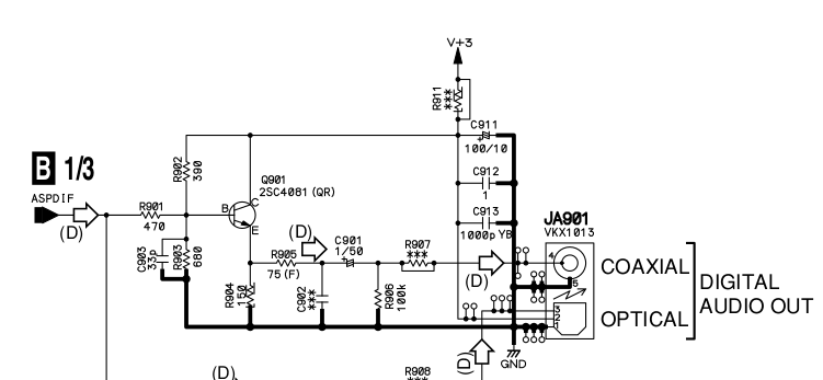

Manufacturing is done off reels in assembly plants. Diy can do anything, of course.
Small part of the schematic of the Panasonic DV-575A DVD-A, DVD-V, CD and SACD player, showing a 100 uF, 10 V electrolytic capacitor biased at 3.3 V (V+3 is 3.3 V nominal) and a 1 uF, 50 V electrolytic capacitor biased at even less voltage.
