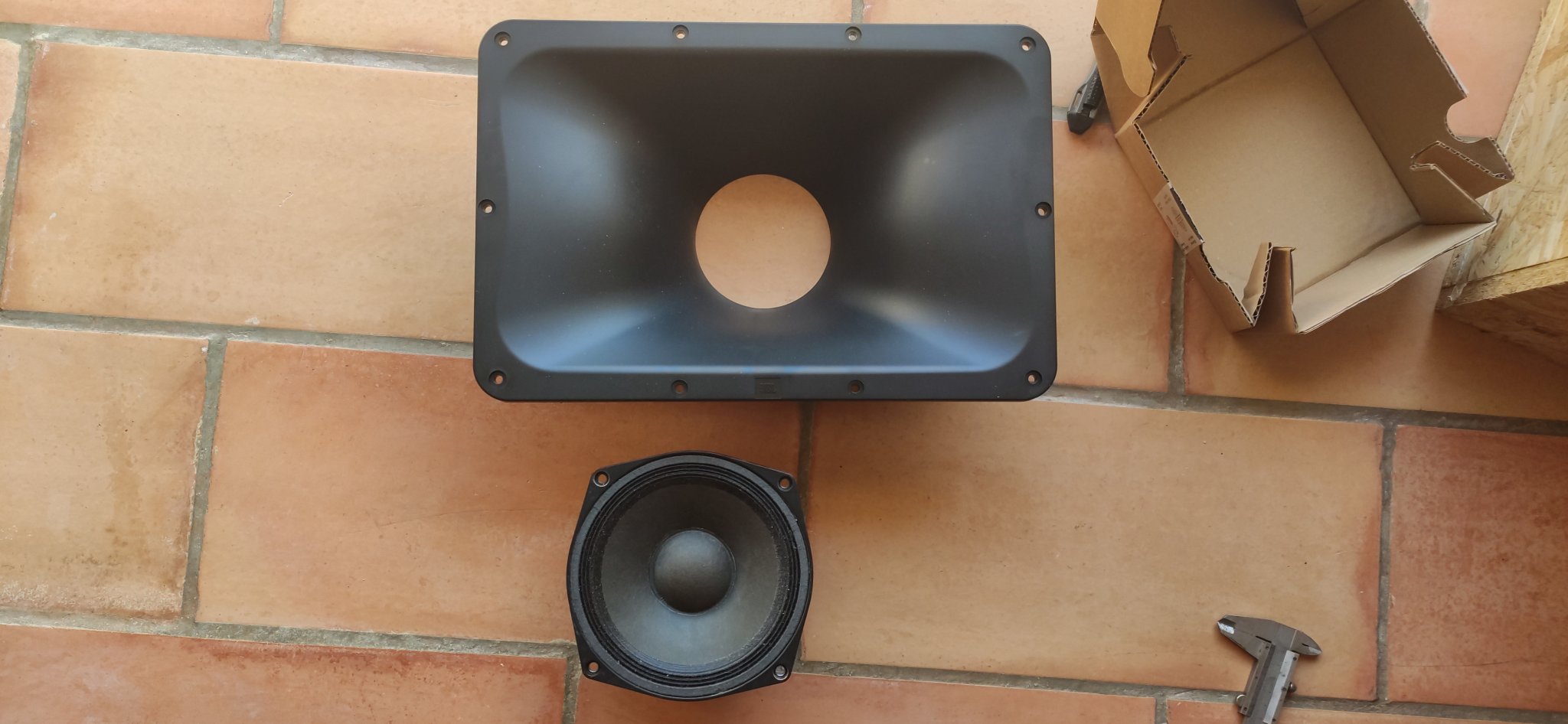

I bought a JBL 5024540 PRX735 waveguide for my 165mm BC md38 driver but the throat is only 100mm and I think the effective cone diameter is around 130-140mm
I first thought I would just cut it to get the desired diameter but after reading on multiple entry horns I think it is not necessary.
I think I could use a box with one or two BC 6md38 and connect it to the waveguide.
But how ?

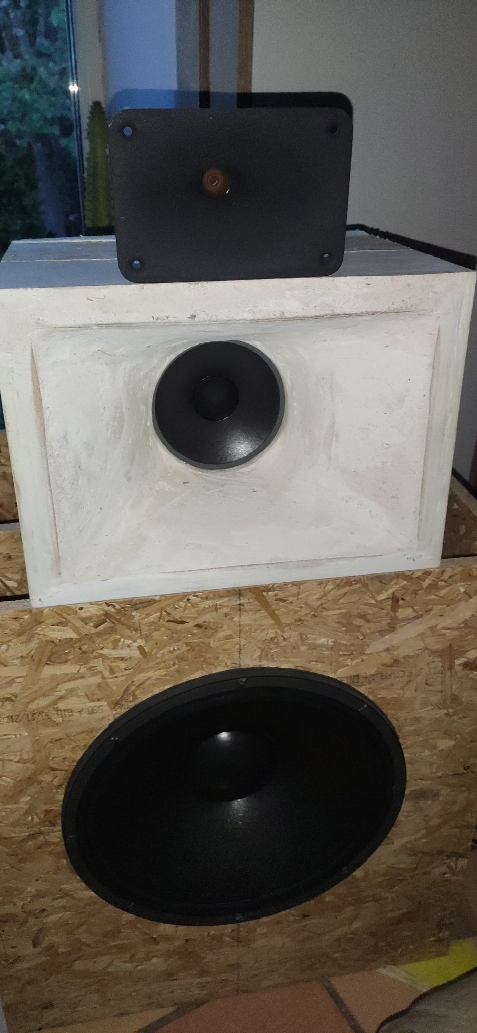

I decided to use a waveguide for look and to throw less energy to the room. I built a prototype in wood and sand I got good results but I made throat equal to SD.

It looks fairly regular, might just extend the mid directivity a little in the frequency range. Like others this has a short narrow vertical section which ought to be extended beyond the flat mouth mounting surface but usually isn't. It is popular for trying to get closer spacing but this can be a false economy.
