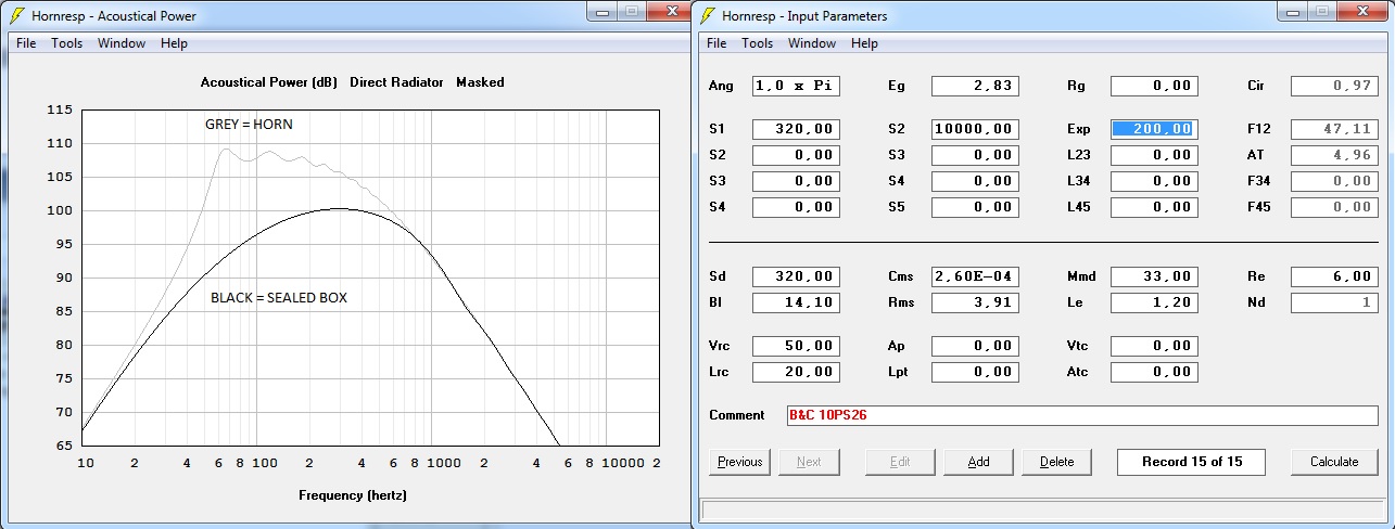

What many people do not understand about horns is that most of their efficiency gain comes from the compression ratio, the horn load itself is a relatively minor effect. So going to 1:1 would simply be throwing away most of the gain
Hornresp clearly shows a 16 dB increase in spl @ 65 Hz between a direct radiator in a closed box and the same driver in a 1:1 C-R exponential horn with the same closed box encapsulation the back of the driver.
I'm not sure that I would buy this example in detail, but it does show what I was saying, no gain at LFs and no gain at HFs. Perhaps my estimate in the middle was a low. A lot of the gain in your test is from the resonance of the horn, i.e. the ripples. In a theoretical infinite horn this would not be so large.
And I would use an infinite baffle for the direct radiator since Horn response is most likely using that condition at the horns mouth (not knowing what the actual radiation would be for this device if it were not infinite baffle.)

I think that the sim shows what I was saying even if we might disagree on the details of the levels.

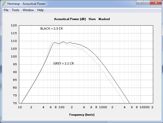

The gain from a 3 x compression ratio was exactly right as well, but this gain is across the whole bandwidth. (Ignoring the resonances which will change with CR)

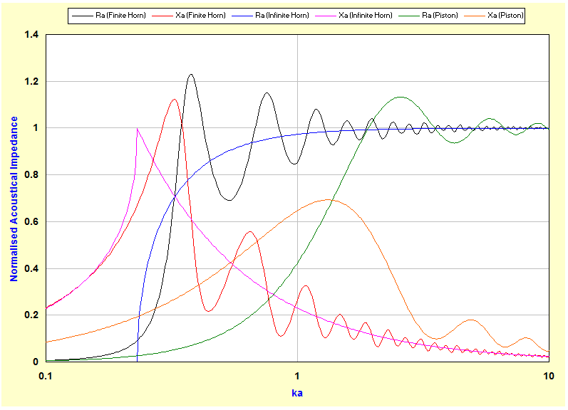

If I get a chance I'll plot out the impedance on a piston with a and without a horn,
The dark traces show the normalised acoustical resistance (black) and normalised acoustical reactance (red) loading a rigid plane circular piston of area 500 cm2 coupled to a straight axisymmetric exponential horn having a throat cross-sectional area of 500 cm2, an axial length of 60 cm and a flare cutoff frequency of 100 hertz, with an infinite baffle at the horn mouth (half space radiation). The compression ratio is 1:1.
The light traces show the normalised acoustical resistance (grey) and normalised acoustical reactance (pink) loading the same piston mounted in an infinite baffle (half space radiation).
Hi David, while I could argue the details of this, it is basically what I was saying, except I was talking about an infinite device where the resonances would not be so pronounced and I would have done the axis in dimensionless ka (that's always the way I think about things. ka here would be about 300-400 Hz where the difference is the greatest (again ignoring the resonance peaks.
I will admit at this point that I misspoke about the actual numbers in the region of maximum gain of a horn. When I thought about it later I could see that 1-2 dB was quite a low guess. My thinking was that the impedance would be about double at ka = .7, which would be twice the power and hence 4 times the SPL. This would be more like 12 dB - so clearly I had some brain freeze going one. The take away is that compression ratio is a factor across the useful bandwidth of a device while the horn gain is only over a limited bandwidth, nearly a decade (again, more than I had guessed at first.) However, for a waveguide designed mostly for directivity control, its useful range is well above ka = .7, so for a device like that, the horn gain is not as big a factor as the compression ratio. Since I never use horns at LFs or below ka = 1.0 this factor is what stuck in my mind.
One other question for you. You plot "Acoustic Power" which would be in watts, but the scale is the usual one for Sound Pressure. What do you use as a dB reference to get this to work out that way? There is a reference standard, but the dB levels would not be as you show.
Also, I assume that you are assuming a flat piston impedance for the mouth load impedance.

Hi Earl,
The chart was taken directly from Hornresp, which is why frequency rather than ka is shown. By exporting the data it is possible to convert to ka in Excel or similar. The attached chart shows the results for the same piston and horn as before, but with the x-axis now expressed in terms of ka, and scaled logarithmically. The infinite horn case has also been added.
