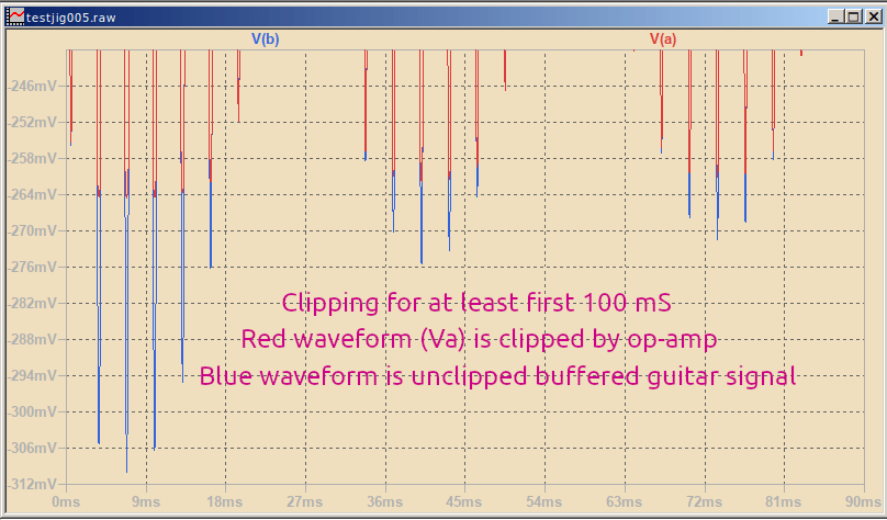

In a nutshell: The fundamental problem is that a guitar waveform starts out with a LOT more amplitude than it has after a second or two. If you want to still hear the guitar two seconds after you picked the note, you have to have a lot of voltage gain. And if you have that much voltage gain, there will be lots of clipping at the start of the note.
And if you use an op-amp input stage, that clipping will be abrupt, and will sound harsh. (Depending on your ears and preferences; lots of young'uns love sounds that are unbearably harsh to me.)
Okay. Enough history. How about something a bit more objective than "Well, I can hear it!" ?
Here's a screenshot of an LTSpice simulation that shows repeated clipping for about 100 mS at the beginning of a guitar note.
For the simulation, I first generated a waveform in LTSpice that strongly resembles one of the guitar waveforms captured by Rod Elliott and published on his website.
Then I fed that waveform into a virtual TL072 set for a voltage gain of 11 (non-inverting, 10k and 1k feedback resistors). It's powered by 9V DC in the usual way (inputs biased to +4.5 volts, so the op-amp effectively has +/- 4.5V supply rails).
The output of the TL072 is then divided back down by a fixed attenuator consisting of a 10k and a 1k resistor. This has a voltage gain of 1/11, exactly the inverse of the op-amp's gain.
If the TL072 does not clip, the resulting signal should now be exactly identical to the input signal from the guitar.
But it isn't.
The attached plot shows the result of overlaying the two signals. The red waveform is the one that went through the op-amp set for a gain of x11. As you can see, LTSpice thinks the TL072 it will clip repeatedly on negative peaks for about 100 mS at the start of this particular guitar signal.
Remember: this signal came from picking one single string, at a picking intensity Rod Elliott felt was typical for him.
Much bigger signals are possible (and likely). Simply playing an open six-string chord (six strings rather than one) will produce a considerably larger signal. Making the conservative assumption that there are six equal-strength uncorrelated signals, they will add up in the usual way for stochastic signals, i.e. the net signal will be (square root of 6) times stronger; that's roughly 2.5 times stronger.
So if you simply strum a chord lightly, the clipping will be much more prolonged.
Any good musician plays with dynamics. There will be times when you strum or pick lightly, and times when you strum or pick hard, for dynamic contrast. This means the signal will be larger yet, and clipping will be even more prolonged.
Short version: the clipping shown in the attached image is quite conservative. In actual use, depending on the guitar, the type of pickups, the string gauge, and the playing intensity, clipping can be much worse.

Consider a very conservative situation, where the op-amp is set for a voltage gain of only 21 dB (that's 11 times, which you'd get with, say, a 10k and a 1k feedback resistor in non-inverting configuration.)
A 400mV negative input peak now wants to turn into a 4.4 volt peak at the output.
Since the op-amp can't produce any output signal more than 3 volts peak, it will clip.

I took 400 mV and multiplied it by the gain of the first stage of a Deluxe Reverb, which has a gain of 50 in its first stage. The question was why would anyone need high voltage when the input voltage is less than half a volt. I thought this was to be a replacement for a tube amp but running on high voltage. Maybe I was mistaken, I will bow out if that were the case.
I agree with you 100%, and your example shows exactly why you DO need high voltage even with a small input.I took 400 mV and multiplied it by the gain of the first stage of a Deluxe Reverb, which has a gain of 50 in its first stage. The question was why would anyone need high voltage when the input voltage is less than half a volt.
Please don't bow out. I thought the same thing as you.I thought this was to be a replacement for a tube amp but running on high voltage.
But I think the thread has veered a little since the start. Now we seem to be discussing whether or not a 9V supply rail is sufficient for a clean guitar preamp.
Your example makes it pretty clear why you need lots of supply voltage if you have a gain of x50.
My example makes it pretty clear that a 9V supply and a gain of only x11 is still sufficient to cause lots of clipping.
We are on the same page.
The only additional thing I'd add is that a clipping op-amp sounds very, very much harsher than a half-12AX7 pushed slightly into the curvy part of its transfer characteristic. That input-stage triode won't actually clip, but it will very gently squash the signal peaks without making any harsh distortion.
