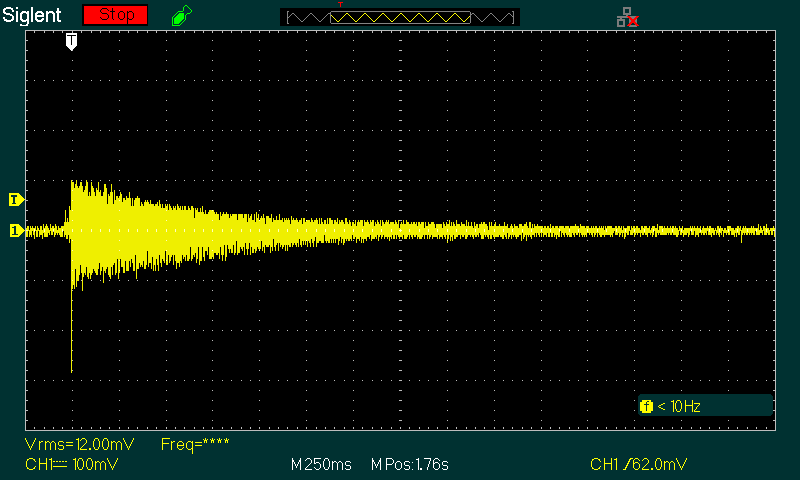

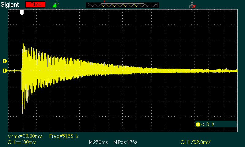

Take a look at the two attached images, 'scope captures of the signal straight from the pickup of an electric guitar. (Both images are the work of Rod Elliott, here: https://sound-au.com/articles/guitar-voltage.htm )
See how huge the signal is when it starts? In one of the traces, the enormous negative transient is about twenty times as big as the end of the waveform (four screen divisions vs 0.2 divisions).
With only 9 volts power (which means maybe 6 Vpp maximum output from a TL072), that is a challenging waveform to deal with.
You could avoid damaging the waveform if you keep the gain (signal levels) really low (i.e. it's not a useful preamp!) If you do this, you now have an accurately reproduced huge transient 26dB bigger than the rest of the signal. That huge transient will sound painful and harsh, even though it's brief, even though the guitar/amp is set for clean tone.
Very low gain from a preamp is useless, so in practice, gain will be turned up. With the gain turned up, now that huge initial spike will be harshly clipped by the op-amp. Once again, the guitar will sound harsh even for clean tones.
So you're damned if you do (high gain), and damned if you don't (low gain). Either way, you get harshness.

That transient is what, 1/100th of a second. Yes, it's going to make a click or something extra at the start of the sound, but I have a hard time believing that's the cause of the harshness you hear.I used to think so once, a long time ago. But I kept hearing this harshness in solid-state (analogue) guitar amps built with op-amps or audio power ICs (which are basically high-power op-amps).
That transient looks like a glitch. Would have to zoom in to be sure.That transient is what, 1/100th of a second. Yes, it's going to make a click or something extra at the start of the sound, but I have a hard time believing that's the cause of the harshness you hear.

And even if it isn't a glitch how's a high voltage amp make any difference, the level is 400mv.
0.4V x 50 (gain for bypassed 12AX7) = 20V, so a swing of 40V is needed. A supply of 100V can do it. A 12AX7 just scrapes by at this voltage to my ears.That transient looks like a glitch. Would have to zoom in to be sure.
