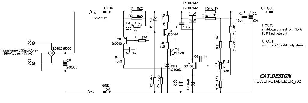

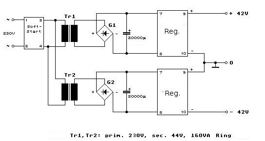

I built this power amp in the late 1970s: ( https://www.diyaudio.com/forums/solid-state/96192-post-solid-pics-512.html#post5036286 ) with regulated power supply.
The reason for this was already purchased power amp boards with a simple circuit concept; e.g. without current sources etc. in the preliminary stages, quasi complementary output devices; and with a not well functioning overload protection.
I have removed the overload protection of the power amplifiers and instead equipped the power supply control with an overcurrent shutdown. The transformers were also already bought and at that time I wanted to make something out of the existing material.
Compared to an unregulated power supply with only rectifier and capacitor, the power supply control for this amplifier provides a significant improvement in performance and sound quality.
Here the circuit:

Here the circuit:
