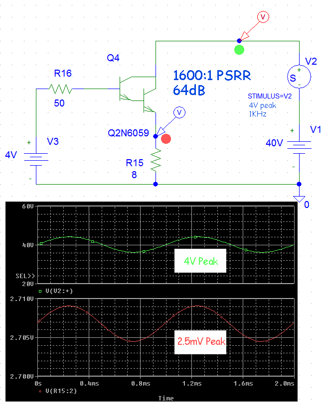

....since the output devices are directly connected to the power supply, it seems to me that they won't be afforded these cancellation properties.
We usually wire the output as emitter follower. As it says on the tin, it follows the input signal, not the power supply. Not perfectly-- in tube we observe that a CF's PSRR is about Mu. What is a BJT's Mu? Usually well over a thousand.
I simmed something. Follower with a NO-signal DC bias, and 4V of crap on the supply rail. It is important to note that a signal source is never Zero impedance. I added 50 Ohms. This could be a very stiff driver (opamp) or it could be a global NFB loop reducing effective driver impedance very-low.
The simmed number is 4V peak crap is reduced over 1,000:1 for 0.002,5V peak crap at the output. An emitter follower can be VERY effective at ignoring supply variation. (There are various collector-output schemes and most of these have the same property if properly implemented. Collectors are NOT voltage sensitive.)
Also, if modern opamp-driven preamps are SOOOO good at PSSR, why use any regulation at all?
Indeed. Mostly, I think, because as long as you are playing with chips, more chips in the power supply seems fitting. I've often run opamps in critical systems with just C-R-C filtering. If you need every last bit of voltage output, then you run the opamps AT their MAX rating, and now a regulator may save your bacon when the wall-outlet runs high. IMHO that's like driving too close to the edge of the road and asking the guardrail to keep you from going over the edge.
That's just over 60dB. At 1kHz. So using that 4V example as supply ripple, that will give 2.5mV at the output. If the output signal is say 25V that's -80dB. So your THD+N will never be better than -80dB and limited by the supply. Go to 10k and you loose another 20dB. Not pretty.

Simple emitter follower is not good enough, as Jan said. You should see Jan's Super Regulator. Replace op-amp with discrete op-amp that capable high voltage. It is almost make another amplifier for different purpose.
I think you just made a VERY good point for a regulated supply. AS Jan points out, that 2.5mV "peak crap" is only 80 db below a 25 volt output (~75 watts/8Ω). Not particularly good. But what about when you are only driving room listening level? Maybe 5 volts, ~ 3 watts. Then your crap is only ~-66 db below----pretty bad, actually!!I simmed something. Follower with a NO-signal DC bias, and 4V of crap on the supply rail. It is important to note that a signal source is never Zero impedance. I added 50 Ohms. This could be a very stiff driver (opamp) or it could be a global NFB loop reducing effective driver impedance very-low. The simmed number is 4V peak crap is reduced over 1,000:1 for 0.002,5V peak crap at the output. An emitter follower can be VERY effective at ignoring supply variation.

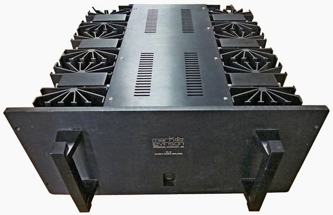

The Mark Levinson ML-2 power amp has regulated power supplies. Have a look at the photo below. ML-2 has six enormous heatsinks. One for left channel pull-up, one for left pull-down, one for right channel pull-up, one for right pull-down, one for positive supply rail regulator, and one for negative supply rail regulator.
ML-2 is revered for the beautiful sound it produces. It's one of the most prized collectible amplifiers of all time.
To me it's a demonstration that voltage regulation doesn't always ruin the sound.

Used to have one of those too. It also suffered from a very muted top end, thanks in part to an aggressive low pass filter end and a ridiculously low input impedance. So wish Linn would stick to turntables.You are describing my regulated Linn Amp (which is eligible for Social Security here in the States) -- it is quite civil but lacking in dynamics.
That is a solid argument. Sadly, never had one of those.To me it's a demonstration that voltage regulation doesn't always ruin the sound.
Perhaps the most elaborate example of a regulator i was familiar with was in a Naim NAP250 and the poor dynamics stereotype fitted it perfectly.
