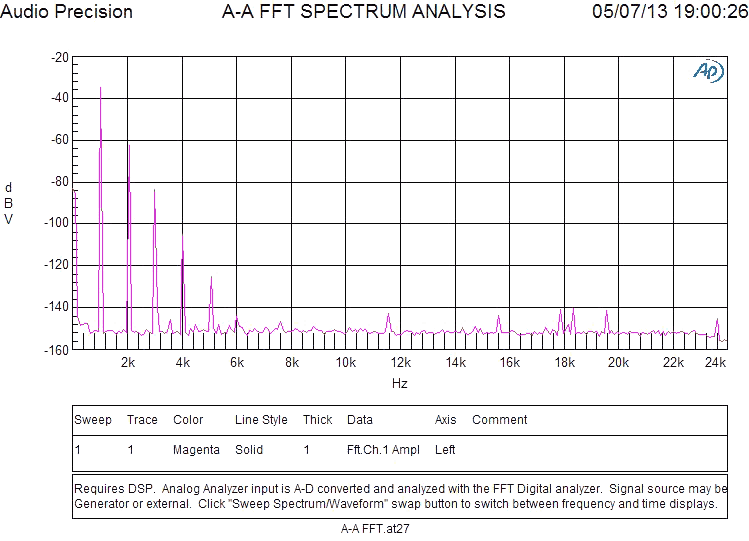

Is there any DISadvantage to using REGULATED power supplies for power amplifiers?
Yes
When you use a regulated power supply its error amplifier can introduce distortion and modulate the power supply rails.
Observation comes from a correspondent to the Linear Audio regulator shootout years back. So I went back to the drawing board and did the following experiment -- inject an audio signal onto the power supply rail (from a very low THD source) and see if there are any harmonics. The Super-Teddy was very, very quiet, but was problematic listening:

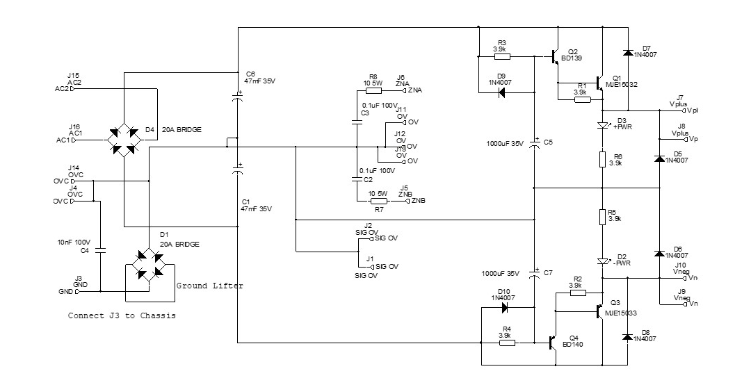

There is another way of mitigating mains issues which is to protect the amplifier sensitive circuitry with separate rail CRC filters. I also used a diode to prevent these rail filters from supplying current to the output stage. This allowed me to use far smaller capacitors. The overall capacitance reduction was 80%.

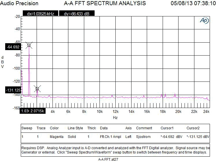

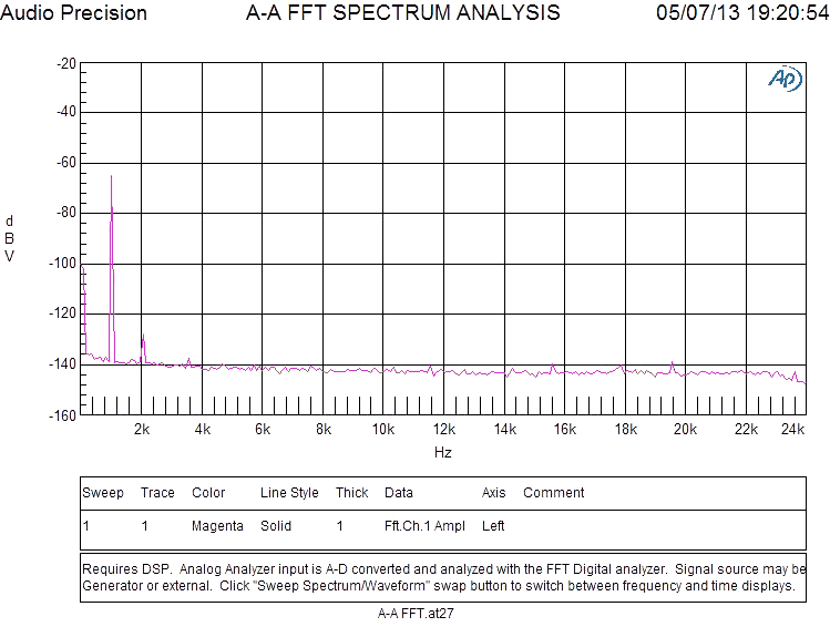

When you use a regulated power supply its error amplifier can introduce distortion and modulate the power supply rails. The Super-Teddy was very, very quiet, but was problematic listening.......... On the other hand, the Jung SR and Sjostrom are appropriately damped and were among the most highly rated
So you are saying that SOME power supply regulators can cause distortion. Then why not use a hi voltage/current Jung or Sjostrom regulator?
The first time I saw that done was in the Audio Research D76A tube amplifier, with the driver circuitry decoupled from the output stage by a 1N4007. Interestingly enough, their D150 did not do this.
