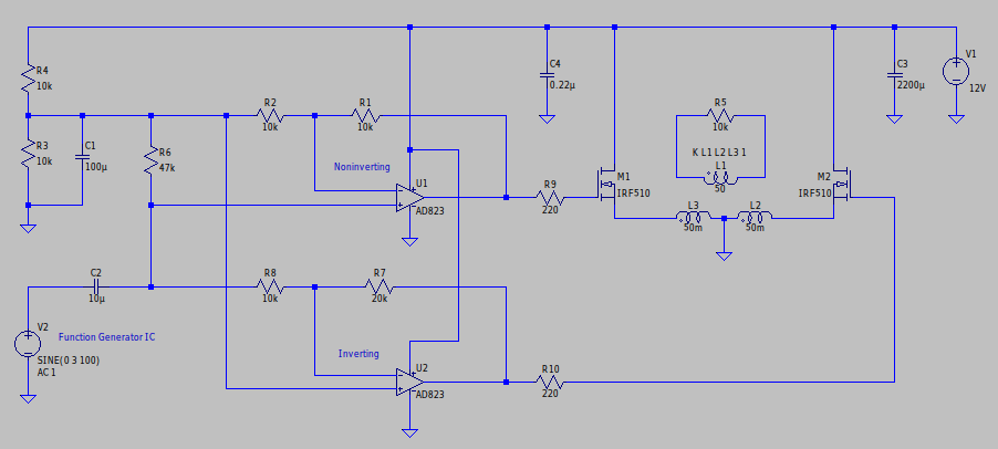

Instead of using back-to-back transformers, would it be possible to drive the step up transformer from a switching DC supply like this?:
Or maybe best to connect the center tap to VCC and use P chans.
I have a page here: https://www.diyaudio.com/community/threads/12v-pure-sine-wave-inverter-using-op-amps.417438

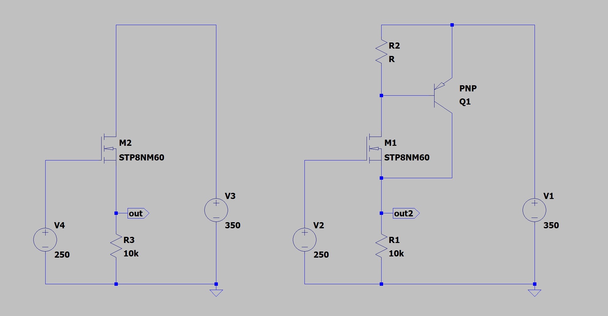

is there anyone who has built this circuit?
I think my idea is not too bad.
Escpecially for the Tube-people 🙂

Agree. Nobody's home to watch the output voltage and do something about it.@lineup, with all due respect, I am not sure why you call this a regulator. Nothing is regulated, it's a source follower (sometimes fancy-named capacitor multiplier).
There is no mechanism to regulate; to correct the gate voltage for output voltage drop.

I disagree, a source follower have an internal feedback mechanism, if the output voltage drops the mosfet will conduct more current , of course the feedback it’s low , a bjt would be better.Agree. Nobody's home to watch the output voltage and do something about it.

That's like saying that a resistor has feedback, you increase the voltage across a resistor and the current increases.I disagree, a source follower have an internal feedback mechanism, if the output voltage drops the mosfet will conduct more current , of course the feedback it’s low , a bjt would be better.
But it's stricktly a linear process, just as pulling more current out of a FET source increases the Vgs.
With all due respect, but your post seems to show an incomplete understanding of what feedback is.

the source of the Mosfet in this circuit is the output but it´s also the (inverted) input, as the output current is dependent of the voltage between the gate and the source (Vgs) , it´s a current fedback amplifier with a gain of 1 ( well it would be 1 if the MOSFET transconductance was infinite ) ,I'm sure if you think about it you'll see it too.That's like saying that a resistor has feedback, you increase the voltage across a resistor and the current increases.

No I don't see that and I see no explanation how this would work either.the source of the Mosfet in this circuit is the output but it´s also the (inverted) input, as the output current is dependent of the voltage between the gate and the source (Vgs) , it´s a current fedback amplifier with a gain of 1 ( well it would be 1 if the MOSFET transconductance was infinite ) ,I'm sure if you think about it you'll see it too.
If you drive the gate with a signal, increasing the gate voltage increases the source current, which will increase the source voltage, which counteracts the rise in Vg and is a case of (local) feedback.
In the case of a capacitor multiplier, where Vg is (ideally) constant, pulling more load current out of the source increases Vgs but there is nothing that provides counteraction.
It is strictly linear and there is no feedback mechanism that somehow 'compensates' or counteracts the drop in output voltage.
Another way to look at it is to realize that (negative) feedback always decreases the forward gain. There is nothing in the capacitance multiplier that has that effect, the forward gain is already below 1.

You can increase the open loop gain just by adding a resistor and a BJT (or MOSFET), in that case you would have less output impedance, the negative feedback mechanism is exactly the same.True, but the effect is minuscule.
