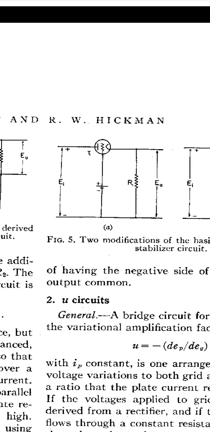

Exactly, if the output load is connected to source , you will have a circuit with negative feedback, but if the load is connected to drain and the source is connected to ground the circuit doesn't have negative feedback as the output is now isolated from the inputThe source on a MOSFET is also an output terminal, so it's more often seen as that rather than as an input terminal, even though it is in common to both in/out functions of the device.
That's why we have "grounded grid" amplifiers in ham-radio land.A MOSFET has two inputs, a high impedance input( gate) and a low impedance input ( source ) , the problem is that people see the gate as the " input " , and that way of thinking doesn't help.
Depletion MOSFET and a resistor can provide a stable voltage reference, or an Lt3090 current source and resistor as Jan demonstrated in his most recent T-Reg. I haven't measured whether this setup's noise is less or greater than a string of zeners or a gas VR tube.This is perfectly appropriate for the Valve/Tube world - historically, the use of voltage stabilisers (based on gas tube reference voltage) and current stabilisers (Barretters) were perfectly normal. These were often designed wthout any separate closed loop, just like the Power-MOS follower based example shown in this thread.
When one is worried about noise on one of these redneck zener regulators (for tubes) the zener stack can be RC filtered before it hits the FET gate. Step response might suck, but that is usually a don’t care. The stages being fed are usually class A amplifiers. Screens in a power stage don’t care too much about noise at the zener diode level (mu is single digits) so it can be made more responsive.
