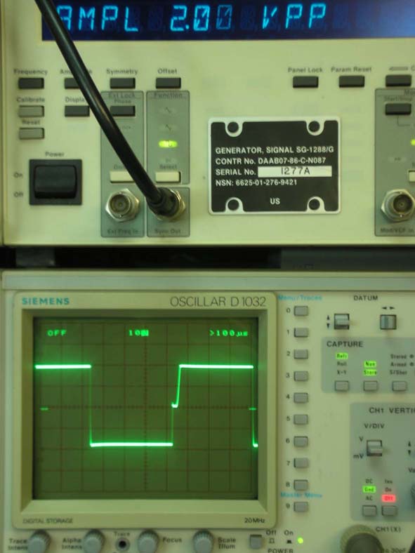

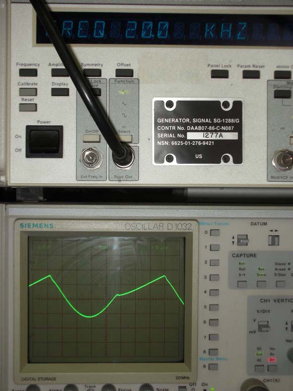

I think this is the same thing I observed in my Aleph5 and Aleph-X. The active current sources ability to deliver current is frequency dependent, meaning that at higher frequencies (from 15kHz) it won´t deliver as much extra current - the active part - as it does at lower frequencies.
Look what happens if you deactivate the active part of the current source (remove the capacitor).

thanks for the reply!
Can you elaborate on what capacitor are you talking about? Also, did that solve your problem entirely or just made it a bit better?
If you are refering to the 47nF near the Q5? I tryed to use diffrent values and even renove it. It got better in terms of wave shape, but never conpletly ok and with 4ohm load, it gets awfull!

yes they are the gen boards, I did not contact the seller (for what any way?) I made some interesting experiences, such replace the Mpsa18 with BC550C, and curiously the BC perfom much better than Mpsa, so I am wondering if Ican find a better transistor my problem will be solved. remember, in low frequency the behave is good, with 4 ohms and 8 ohms load at full power I can achive 18v and 21v rms respectively, but at 10khz with 4 ohms load has distorsion which begin at 7v rms.
I also removed the 47n from the circuit, because this is useless.
NP does not answer my question, so I must continue my research, one thing I have been thinking, this design is not so linear than I thought in interely bandwith.

I performed the last tests, so this amp suffer in the highs , unless... If we increase the bias to 750ma, works fine, but the mosfets produce a lot of heat (27w each x 8=216W/each channel)total 432W. As I said at 8 ohms load peform good, 4 ohms load less power. The thermic cycles short the life of the fets, so the best ones for this are IRFs To-3 case.

banzas said:I performed the last tests, so this amp suffer in the highs , unless... If we increase the bias to 750ma, works fine, but the mosfets produce a lot of heat (27w each x 8=216W/each channel)total 432W. As I said at 8 ohms load peform good, 4 ohms load less power. The thermic cycles short the life of the fets, so the best ones for this are IRFs To-3 case.
I think that a number of manufacturers have problems with
diy gene, since he freely uses trademarks that do not belong
to him. I have instructed my IP attorney to contact Ebay.
As to your problems with the high end, all I can say is that the
Alephs were always a delicate balance between bias current,
current source gain, feedback, layout, and compensation. Every
time you alter that balance, you are likely to see some
degradation in performance.
