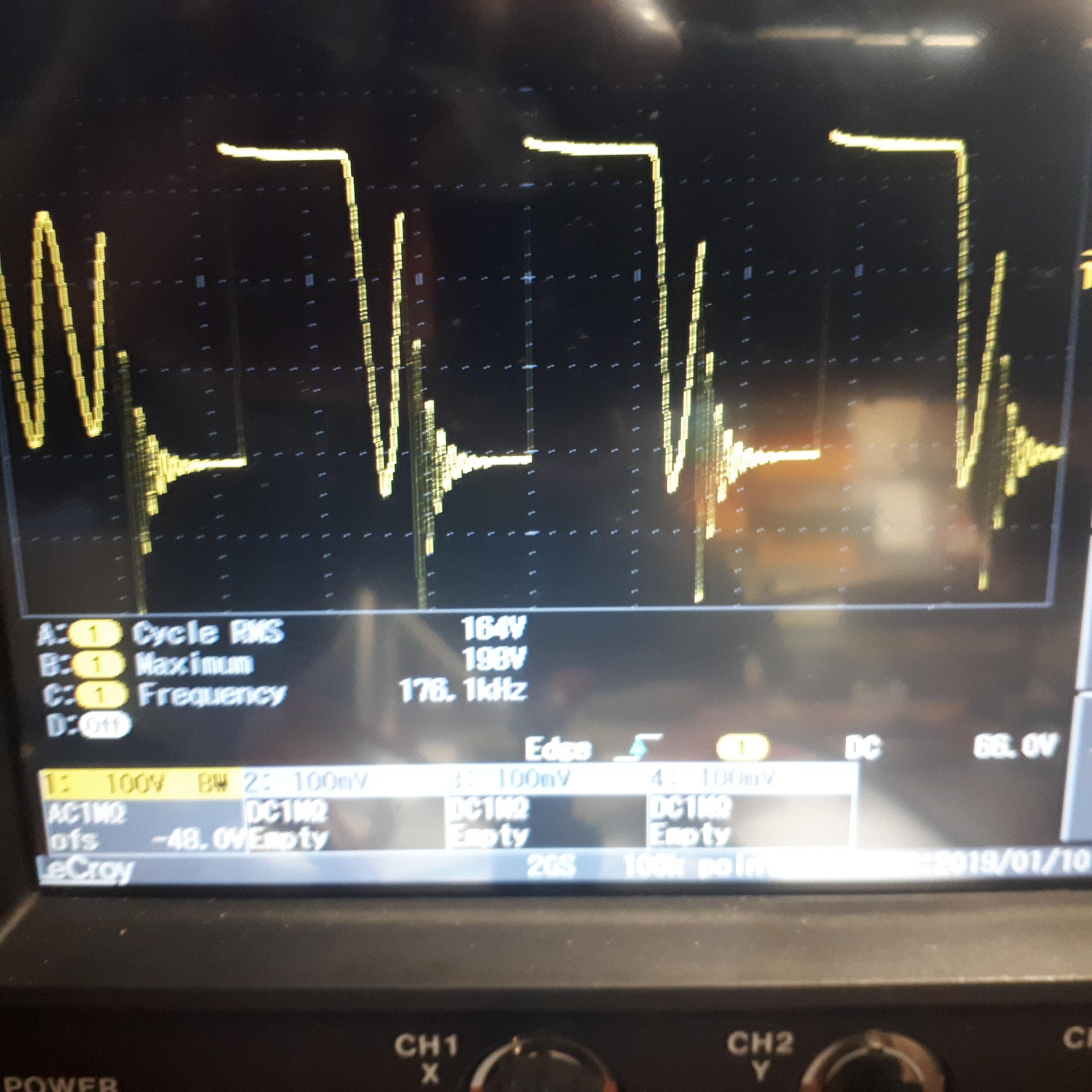

What I have found is that it is ZVS type (I have the single rail version, although there is a dual rail version also).
Due to this, and despite the constant switching frequency which according to my scope is near 48kHz, rather than the advertised 75kHz, the burst switching/pulse dropping action results in voltage ripple which modulates the carrier ripple (which is actually pretty low in level at about 80mV pk-pk).
What this means is that dependant on the desired output voltage, current draw, the ripple is variable.
I have found that I can achieve anywhere between the baseline 80mV HF hash, and up to 15 Volts modulated at around 10Hz. The latter case at higher voltages.
I don't fully understand the relationships here, but testing with various resistors to give a constant load, I find a few sweet spots in voltage, which do move about, when the current drawn is changed.
These sweet spots have low ripple in terms of AC percentage, but how they react to an active load?.....that will come in time I suppose.
I'm planning to run a tube line stage, preamp, or head amp so I will probably try and set up the PSU so I have minimal ripple with the span of current draw I expect in use, and hope that means I avoid ripple above say...1% of DC output.

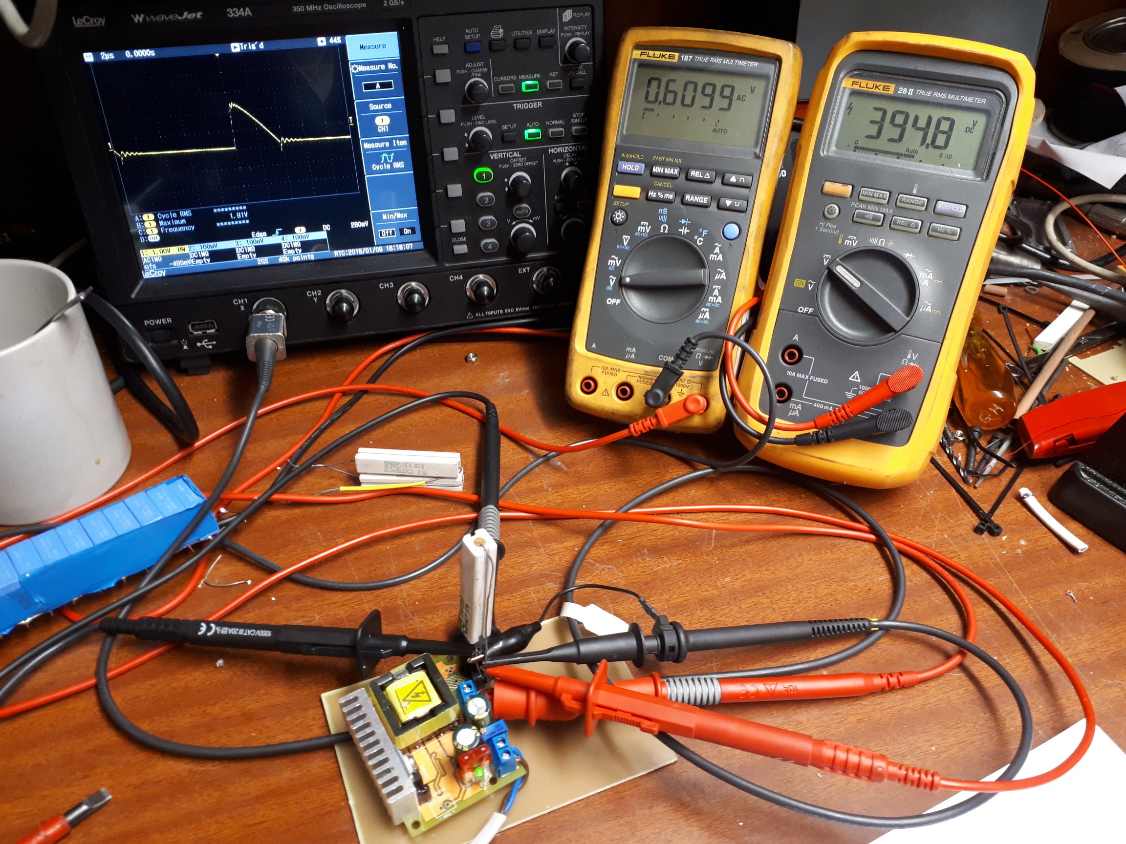

Some data
Some data taken in testing this £3 SMPS PSU from ebay (attached PDF)
Cheaply made but seems like not too shabby a supply (as long as you check joints, connections and don't expect miracles) - After 30 mins at rated 40W dissipation the transformer is the hottest part, other than the loading resistor!!!
Personally I'd limit it below 30W, or fan cool as soon as the unit is boxed up.
I have taken ripple factor measurements at some set points, which are useful to me - the replacement trimmer (10k replaced 50k original) makes it far easier to dial in the voltage, limiting output from 145 to 390 volts. A 5k trimmer would be even better I suspect, but alas I don't have any of the correct size and pin arrangement. The design seems to my eyes to have been designed for 200-300V non-adjustable voltage, but has been adapted to allow more adjustment than originally designed for. I suspect a 5k trimnmer would give a working range of nearer 200-390V (perfect for me!).
I have also upped the 10uF 400V output capacitor to 22uF 450V (same footprint), and the 470uf 35V input capacitor to 1000uF 35V.
Maybe it is of some use to someone else like me 🙂

No. I didn't take measurements that high in voltage.
However, all of what I found in testing means little without the referenced to input voltage.
In my tests I used 30V supply, and from a little fiddle at 390V, it looks like 24 to 30V supply will work best.
I have now found that if input volts are kept between 12 and 18 VDC, the PSU has no real issues at low volts, and ripple is a fairly constant 400mV at 75kHz.
If I run at 24 to 30VDC then the pulse skipping/clock dividing action means that switching drops pulses and sawtooth ripple appears, modulated on top of the switching waveform.
I have found that (Vin at 30V) ripple isn't bad, but can degrade to several percent at the upper end of voltages >250V
However, at 18VDC input, I can load up around 80 ma at 250V with fractions of a percent ripple (Bonus!)
Attachment just for you haha!
395V 4k7 load 80ish mA....overloaded at 50W but short term seemed OK.
Supplied DC 12V 3.5 Amps.
It worked fine until I turned it off...and on again.
I've had this sat testing at 200-250 all last week with no problems....395V and I've killed something.. although I can still hear switching, and diode looks OK....

I have blown several of those diodes... I replace them with UF5408 usually. On one I think I melted the coil. I tend to run them under 15W but in 70c ambient or so... I usually use them at the highest voltage for a VA/PI in a tube amp.
If you don't make the effort to measure part and heatsink temps, and reverse engineer what they are safe to get up to, and operate near the blurb max power level, then of course the unit may well fail, as you haven't managed thermal integration issues.
Just testing till it fails like that provides no usefull information.

Kodabmx,
It is indeed a shorted diode. Luckily I have found US3M diodes and also S5M 5 Amp version, so may replace the diode and see if that is the only fault.
TRobbins,
I wasnt intentionally testing to destruction.
I have monitored temps during testing (transformer, heatsink, FET package)
The fly back diode is simply underrated for duty at claimed 40W output. Hence replacement with 5A updated part.
Anyone would think I don't know how to test....and I need to be told rudely.

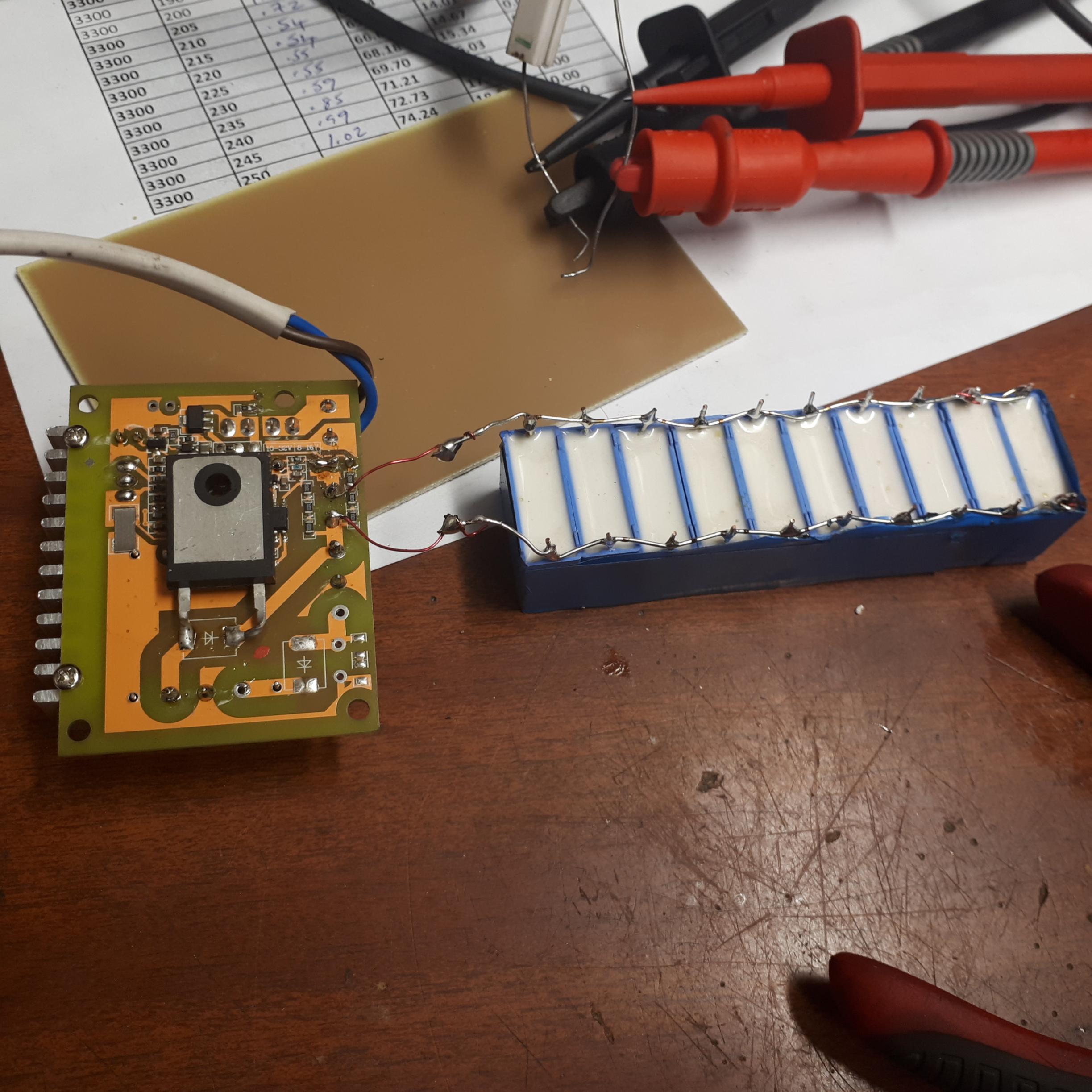

Diode was shorted, 1000V PIV 3A current device, and their isn't much PCB real estate to wick the heat away, so that's a likely scenario. It may be that a S5M replacement isn't much better as it's the same package, with the same heatsinking.
I just hope I haven't killed the FET, although it still seemed to switch despite the loss of fly back diode.

Well....I have no idea of diode duty (not sure how I can't measure that, as I haven't got a diff probe yet.
Suspect US3M diode removed - tests as short off PCB too.
Diode replaced with BY359/F10F150S damper diode (improved If capability and 1500V PIV)
Running with roughly 8W load to heat soak:
12VDC at 0.88A input
200VDC with 4k7 load (some 40mA) 0.34V ripple with standard 10uF output smoothing. I suspect this will drop to mV when switched for 22uF (as before)
78% conversion efficiency according to above measures.
Switching off quickly for temp measurements:
Replaced diode 40C
Heatsink 35C
Transformer 45C
At least the to220 diode can be heatsinked, the transformer temp is probably the next weak point (I think Kodabmx said this earlier)

The IR gun worked OK, despite different emissivities of the materials.
Replacing the US3M diode with F10F150S damper diode worked OK (this is about the only diode I could find here that looked somewhat suitable...)

In the attached photo you can see how ridiculous my replacement diode looks!
The plan is to mount the lot in a small Hammond box, and heatsink the diode and FET to the box.
Next will be at add the 300k resistors, 10uF cap (22uF is far better ripple though) and diode for the other rail....

At the risk of being wrong...
If it is a simple Single Switch Isolated Flyback Convertor the FET body diode should never enter forward conduction and therefore your theory is wrong unless you can claim that the convertor has some concept of resonant mode operation.
Slower Trr on the output diode will hurt RdsOn dissipation on the primary FET if the convertor is operating with continuous current. The FET would have to drive that recovery. However leakage inductance would have to be extremely low for that to be a problem.
Since you have a scope maybe you can supply some pictures of the primary FET drain voltage and secondary Diode voltage, not bar end, both referenced to the appropriate grounds.
Try to do it zero ground lead. Someone else will have a picture but if you take the tit off your probe there will be a nipple and ground ring. You may have already lost the springy thing so you will have to improvise.

Soldered on 50/75ohm BNC.

If you can get those waveforms, short ground, then I will take a guess there will be some serious ringing going on. Keep the probe on x10.

See attached waveform at diode anode, square wave excitation with several cycles of exponentially decaying 'ringing.
100V/div
5us/div
