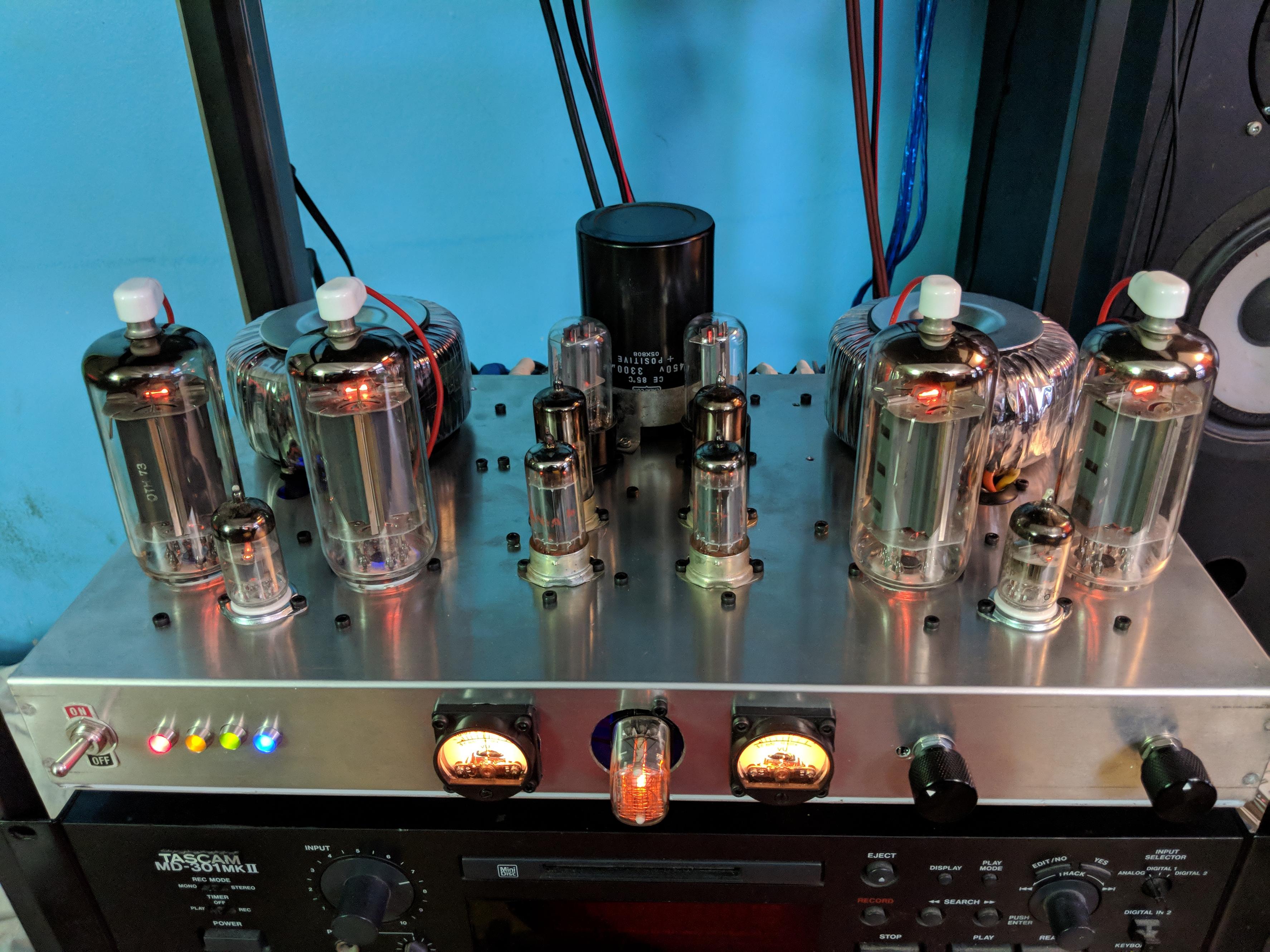

This amp I've recently completed uses boost modules from a 12V ATX 750W 80Plus gold supply (EVGA Supernova G2)
It's using 6P45S running about 300V B+ @120ma per tube (triode connection), a pair of 6N8S as a buffer with active load, and 6N1P (picture shows 6CG7 but I wanted more gain) /6N6P in an Aikido-esque config. Also the Nixie, of course.

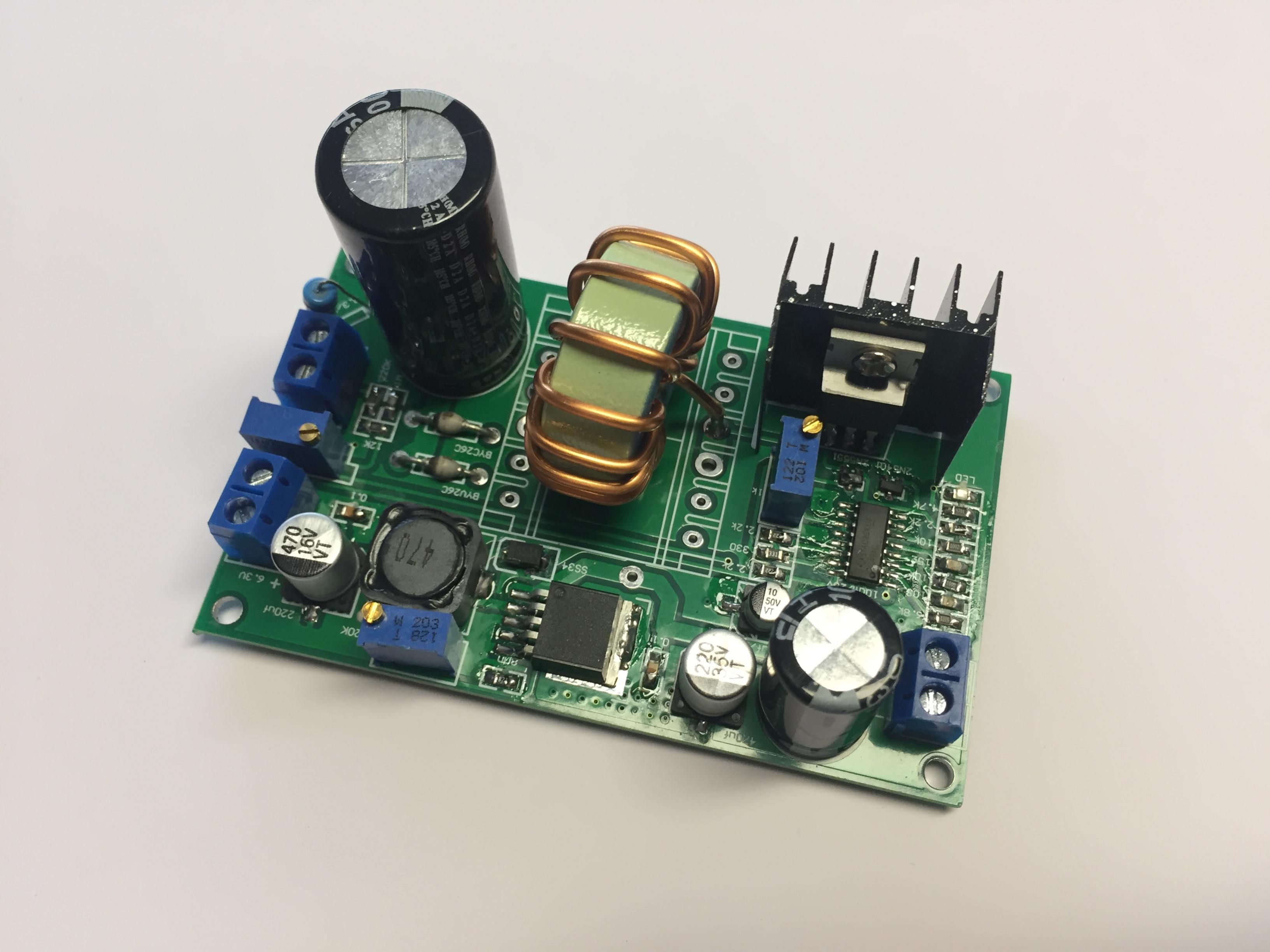

My 12V to 150-420Vdc boost, plus to 6.3Vdc buck module just came in. Nice pcb layout for the 12V to 6.3V buck converter.
Layout for the 12V to B+ boost is more of a layout compromise, and switching frequency appears low - it may take a few days to get some waveforms. The high step up ratio of the boost would support the B+ 60mA output spec limit, but for preamp applications that really is a non-issue.
Comments on module are:
12V to 150-420V boost, non-isolated (common negative 0V);
1,000uF 35V 105C.
15T on 27mmOD 14mmID toroid (likely micrometals T106-52 with AL=95, so 21uH).
IRF840 on drain connected h/s.
2x BYV26C in parallel (600V 1A 30ns).
100uF 450V Samxon 105C (KM series, 35x18mm, 490mA ripple 120Hz).
TL494C (10k RT, 10nF CT, f~12kHz).
12V to 6.3V step down, non-isolated (common negative 0V):
220uF 35V solid; LM2576S-ADJ; SS34; 470uH; 470uF 16V solid; 20k pot; 0.1uF smd on 12V and 6.3V rails.
LM2576 direct soldered to pcb with ground plane.
Cycle by cycle current limiting; 52kHz, down to 11kHz in overload with output voltage limiting to 40%; so should be fine for heater warm up.
45V max input, so cap voltage limited.
About 80% effy for heat dissipation (6.3V 1A output causes about 1.5W loss into pcb).
No input polarity protection.
Easy to add smt caps on rear of pcb for high frequency decoupling as close as possible to specific nodes.
Note that the FET heatsink is hot, in more ways than one!

I also received the board. I ordered two of them, as I am used to do with this kind of bargain parts. Easier to spot any issues by comparing the boards. I will check them througly later on, but first impression is good. SMD parts have been manually soldered, it seems to be a early run or a very small production. The board is easy to repair because it only uses clearly marked and broadly available components, and the circuit appears to be straight from databook. This is important, because I don't want to incorporate in my amplifiers a part that will be difficult to source or repair when it fails. There is no input or output EMI filtering: the board will work anyway, but some EMI filtering must be added to comply to EU regulation, and also to avoid obliterating the AM radio reception to the neighbours, like many unbranded LED lamps do. The smt caps mentioned by trobbins are a easy and effective first step. One board came with the Samxon 450V 100uF capacitor, the other one with a Chongx 120uF 450V capacitor. This capacitor is one of the most expensive parts on the board and they clearly put there any leftover they had on the drawer from the assembly of consumer electronics SMPS. At work I replaced dozens of dried up capacitors of this exact same kind and brand from TV sets that were still on manufacturer warranty. I will exchange the capacitor with a low-ESR 450V 47uF Panasonic. It is, incidentally, about the same size of the original 100uF one and I believe that 47uF is the correct value for this circuit. Another 47uF capacitor may be eventually added after a smoothing inductance of a few mH. The 1000uF 35V capacitor is on the input side and I will probably replace it as well. Other components seems to be OK. The heatsink is small, maybe too small when you draw the maximum power. I will check this later. There is enough space for a bigger one.
To kissabout2002: on this tried and tested switching power supply design the most common failure mode is not the output that slams to the upper voltage limit, like some linear old style power supplies do. According to my experience, it mostly fails by shutting down, either because the capacitor is faulty or because the output MOS is shorted. In this case, the TL494 is usually fried too.
Compliance would depend on the total system, not just this pcb, so whether extra filtering is needed would be an open issue. This pcb operates from dc input and would likely be contained in a metal chassis, unlike LED lamps that I think you are referring to, so it could be an apples and oranges comparison.
At work I replaced dozens of dried up capacitors of this exact same kind and brand from TV sets that were still on manufacturer warranty. I will exchange the capacitor with a low-ESR 450V 47uF Panasonic. ..... The 1000uF 35V capacitor is on the input side and I will probably replace it as well.
I wouldn't think that many DIYers would need to consider changing parts in the pcb - maybe you are aiming to use this pcb in a commercial amp product where service life and equipment failure have consequences back on you.
