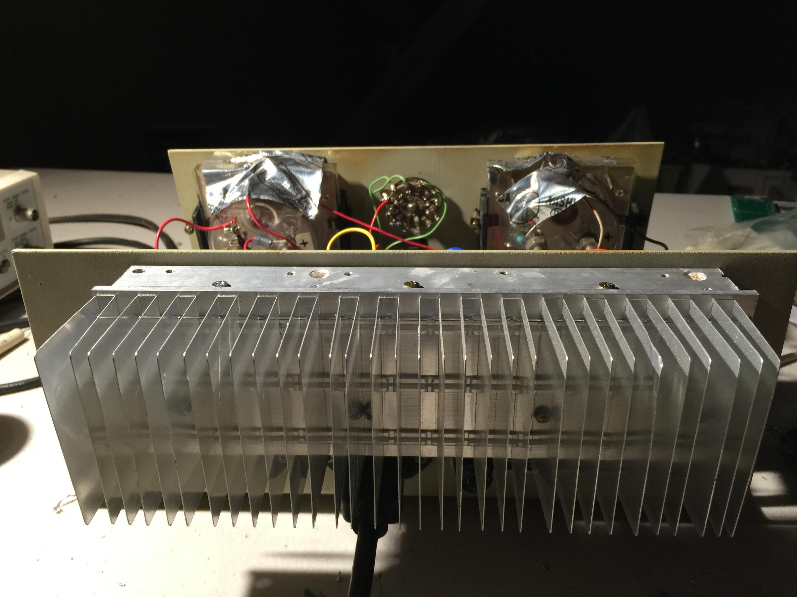

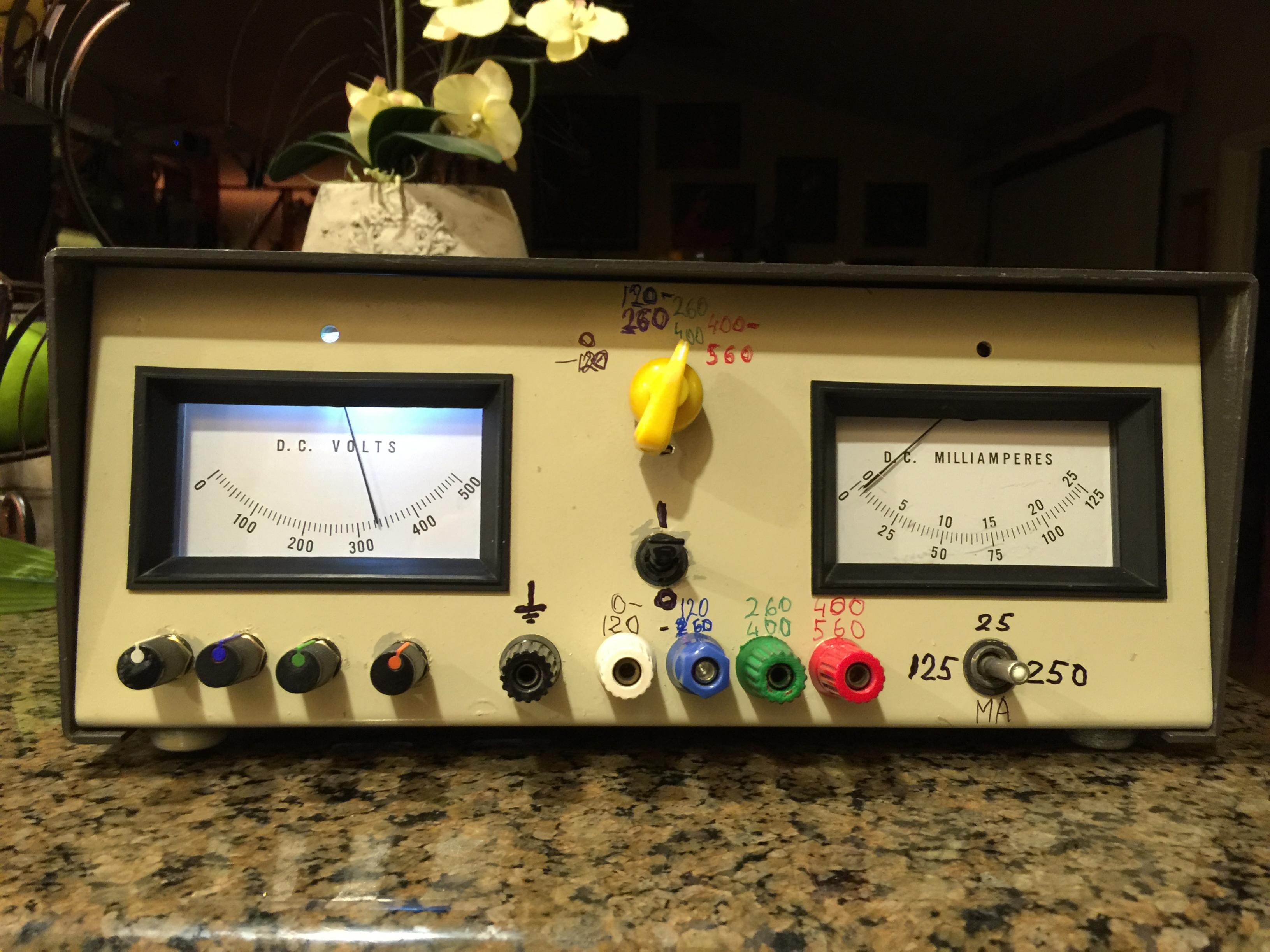

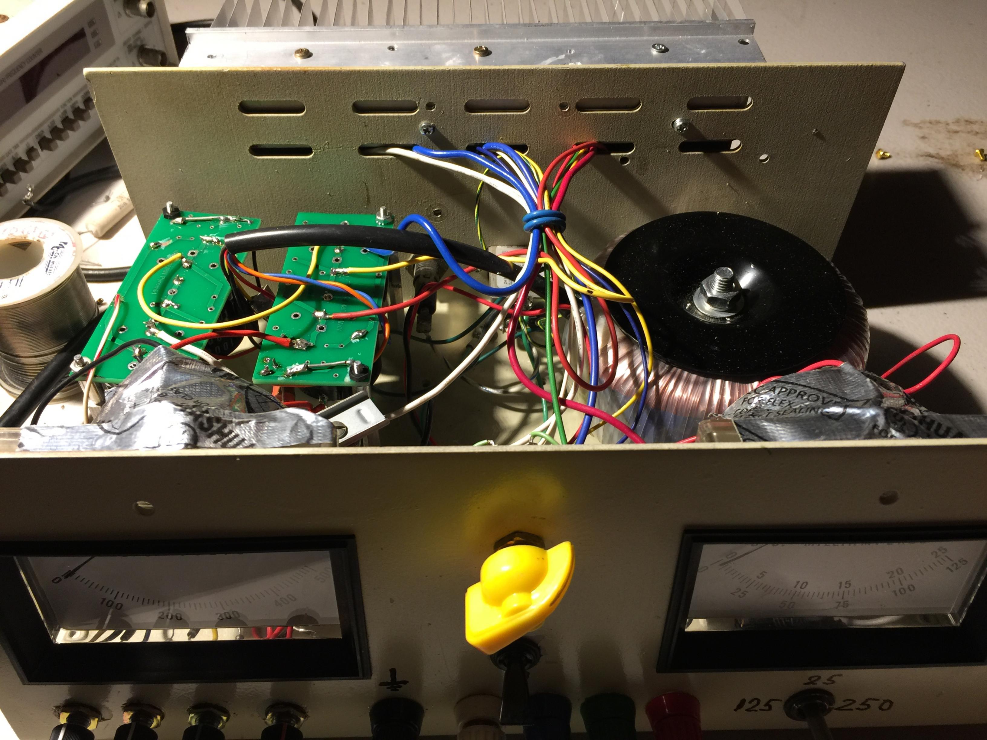

4 independent outputs with different ranges. One isolation transformer with 2 secondaries, 2 doubling rectifiers. One Zener string with potentiometers across Zeners, 4 MOSFETs. One high voltage BJT that shunts Zeners when current goes out of range (3 separate ranges). White backlight goes red when the BJT that shuntes Zeners start conducting.
Anatoliy, your post got me thinking... about current limiting by adjusting the reference to the servo versus brute force shunting the control signal inside the feedback loop, so I'm redesigning the current limiting function in that vein, and when I'm done I will post back. I realize that I'm just creating another loop, but hopefully this loop will be more amenable to analysis.
