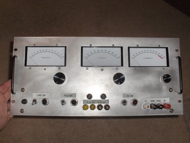

I finally got around to documenting this HV bench supply that I designed and built a while ago...
Details, schematics, etc. are here:
http://www.pmillett.com/HV_bench_supply.htm
Pete

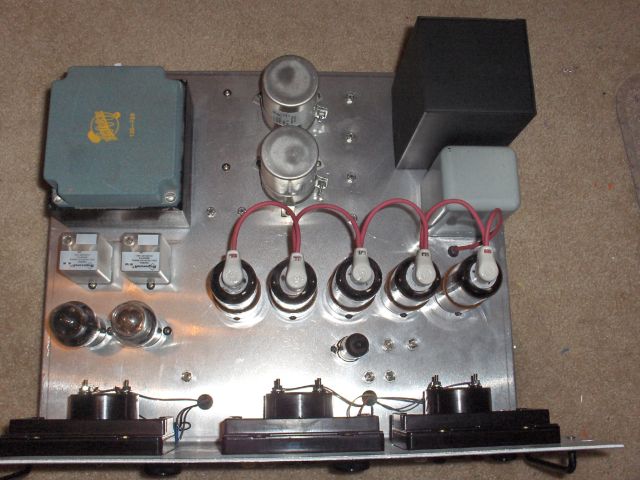

Newbie question: I'm considering building this, and my B+ transformer on-hand is good for 360V@160ma.
Can I use less pass tubes? I'm assuming that these are paralleled to allow for Pete's 500ma current requirement.
I have a handful of Chinese 6L6GC's. If I can reduce the number of tubes to say 2 or 3, does anything else need tweaking?

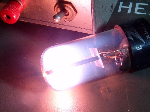

Any of you lucky enough to own one of these bad boys?
http://tubedata.milbert.com/sheets/077/1/1257.pdf
Because I do =)
Why is it that no one has used something like an 811A as a pass tube? The rest of the regulator could easily be sand...
Splendid! About the only information you didn't give was its mass. Lots, I imagine.
UH, if you have to ask, you can't lift it!
I has a big tube with battery cables hanging out of the bottom. It was about 2 feet tall and I couldn't even light the heater without smoking a transformer, so it and a whole pickup truck full of thyratrons were sold for $200.
