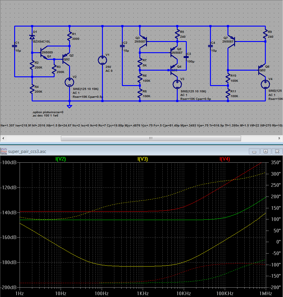

I'm looking for a solution that only uses discrete devices.
Here is the scenario I'm trying to avoid for a circuit such what is attached (sorry for the crude drawing):
Constant bias being applied to the BJT, say 1V, and vbe at t=0 is 0.7, so the current is 0.3/R. And lets just say R is 0.3 for a 1A bias. I'm looking to avoid this:
BJT heats up > reduction of vbe > vbe/r current goes up > device heats up more > further reduction in vbe > etc
Then thermal runaway. Basically I'm looking for a circuit that has good tracking of the bias being applied to the BJT. I suppose I could mirror the current and thermal match, but that would add another power device. Looking to avoid that too.

It would seem a trifle dogmatic to exclude a solution just because it uses an IC.

or 2 Q in "loop" feedback?
"ring of two" bjt feedback ccs uses the Vbe of the feedback/control Q - the heating of the pass Q only has an effect through h_fe tempco (or MOSFET Vth TC divided by loop gain)
pic below was just something I had on hand - hope you can parse pnp source version of the topologies
left most uses a higer Vref - 10 V Zener, and "Baxandal" or "complementary Darlington" - the Vbe nominally cancel - but you would have to bolt both to the same heatsink if large power were involved - and the tracking would have long thermal time constant
the other 2 are the "ring of two" - middle one cascoded
