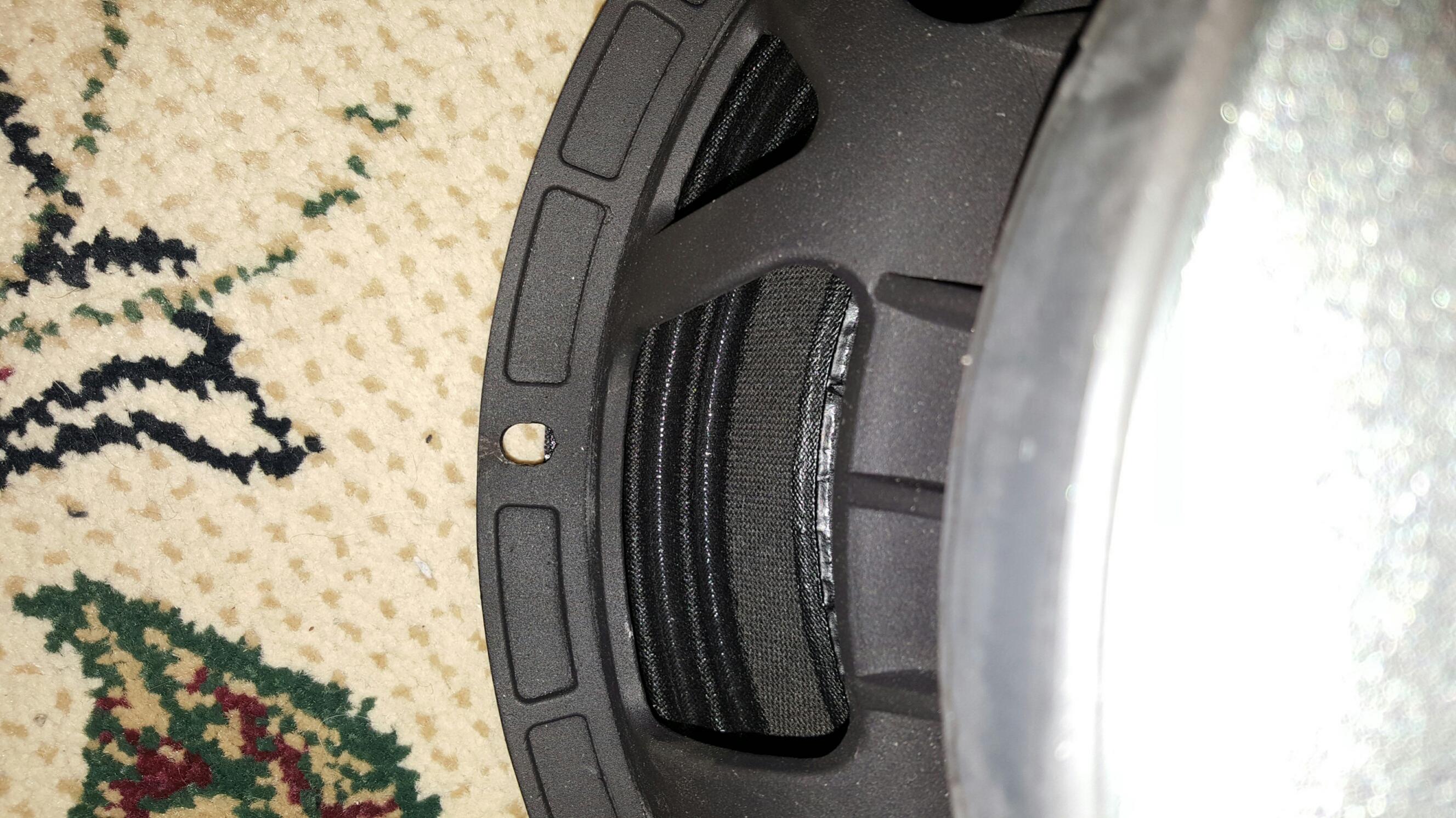

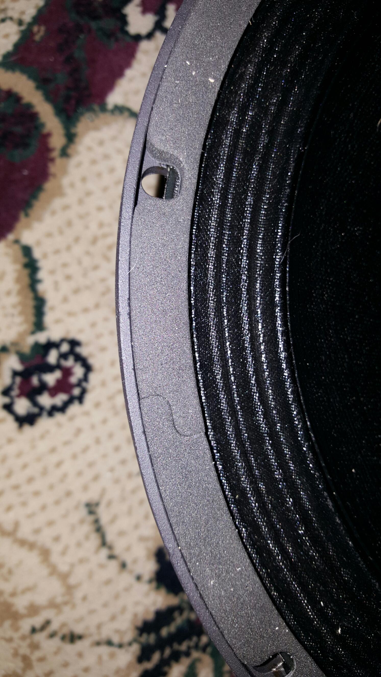

Weekend is fine. I was going to start building this weekend but the drivers arrived and this is what one of them looks like. The second one took a pretty good hit too and I am a bit worried it might not be perfect either.
Damn - how was that packed for shipping purposes?
My brother received two B&C 18" drivers recently. They used less packaging material than PE used for one of the cheap Dayton 12" pro audio drivers I ordered about two years earlier. I was surprised they actually arrived intact.
Yea I was disappointed by the amount of packing material. Also it looked like the box had been kicked all the way to Canada. I don't think the shipping company was very careful.
