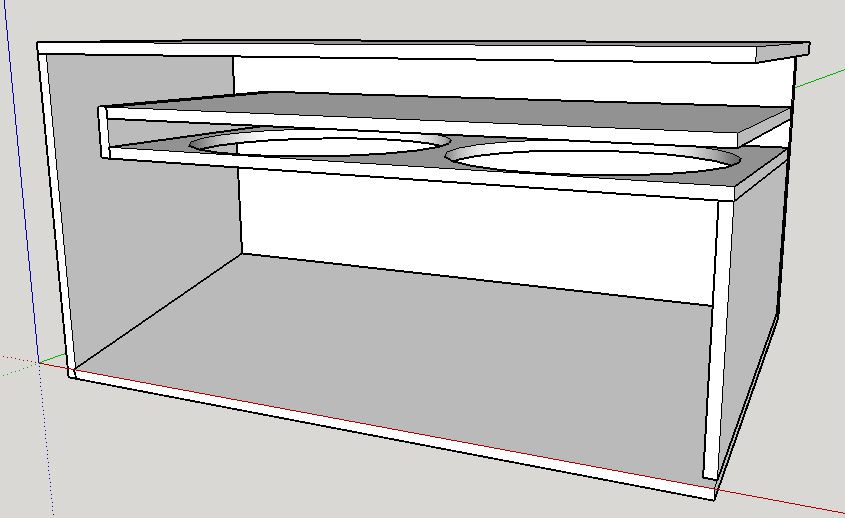

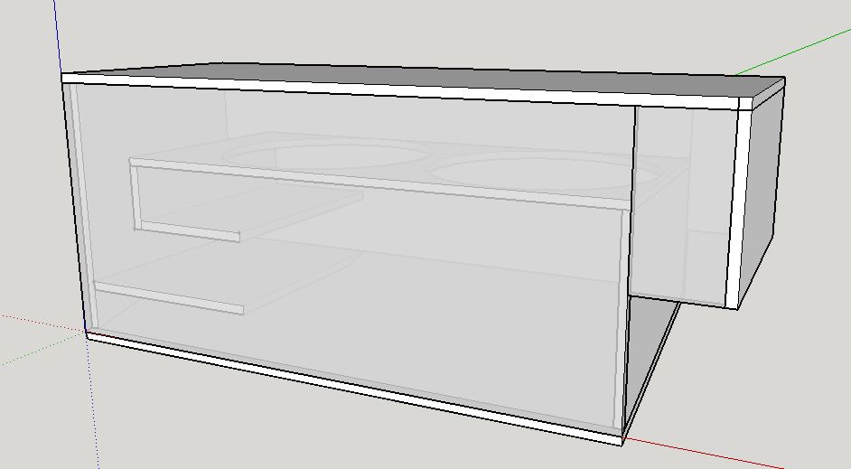

I am not sure I understand. Are you thinking something like this?
A little update. I have been working with the following concept. What do you guys think? Here are the details
Slot area = 100cm2 length = 68cm
port area = 188cm2 length = 82cm
rear chamber volume = 50 liters
driver Fatalpro 12hp1030 - 2 drivers parallel with 1000watts total
Did I simulate it correctly?
I am worried a bit about the size of the port and the slot being too small and causing wind noises. I am not sure how to calculate port velocity and even what an acceptable parameter is.
1. Remove that center board, and extend the vent a bit further into the enclosure
2. Sim as a TH with a large rear chamber and L12-L34 = vent length and S1:S4=vent cross-section area.

Yeah, at 188 sq cm you should be very worried about port noise and compression. Are you using Hornresp? Check velocity by going to Tools - Output - Horn and then Tools - Particle Velocity. You can dramatically reduce velocity by adding a small flare at the end of the port. Just a 45 degree chamfer at the end. The bigger you make it the lower velocity will go. I can check your core port velocity with Flare it (or you can do that) but not tonight.
If you post up your Hornresp inputs I can check it all over for you.
But until you get Audacity auditioned and figure out what tuning you actually want you probably should hold off on the box design. Spend the time in Audacity, not Sketchup.
I already did that, you get a big smiley face response curve with a huge dip in the middle, and big spikes at both ends of the bandwidth. Also bandwidth doesn't extend very high, nowhere near 200 hz.
There's an infinite number of variables so you might have better luck than I did but a quick first pass didn't look very promising.

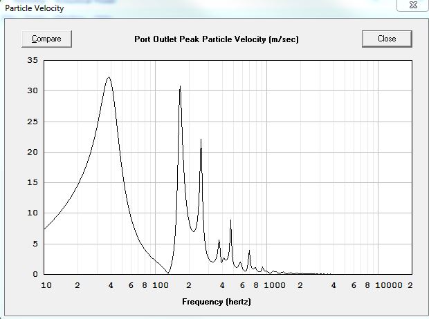

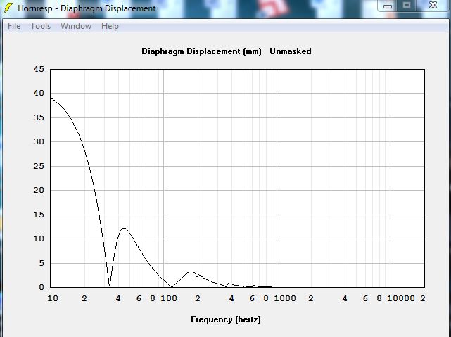

Yes I am using hornresp, thanks for the tip. I checked port velocity and the horn peaks around 40m/s at around 50Hz. The port gets to around 40m/s too but near 30hz where I will have my HP filter set. I'm still not sure if I am simulating the drawing correctly though so this could be wrong.

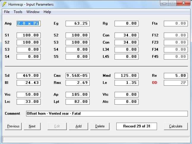

Here are the inputs I am using.
OK I will spend some time with Audacity.
I only have time for a quick glance but it looks good except for Lrc. Set Lrc to the length of the longest dimension of the rear chamber. It's 33 now, it needs to run the entire length of the box.
When you get the design finalized I can run it through Akabak and fine velocity with the high pass filter in place. Maybe run it through Akabak with a flared port too.
Velocity is ideally 10 m/s or less, but that can lead to unreasonably large ports. Some people compromise with higher velocity, I'd never ever go above 27 for any reason and ideally I like to keep it at 10 or less. It shouldn't be too hard with flared ports.

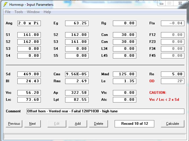

OK so here is where I am at.
I have ordered 2 Faital Pro 12HP1030 drivers. Should arrive in a week or so. Of all the woofers I tried were pretty close to the best for my application. To top it off they have some weatherproofing treatment that should make them more suited to a boat.

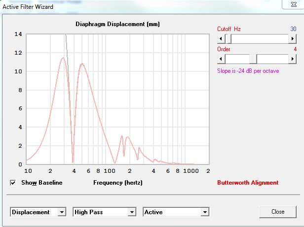

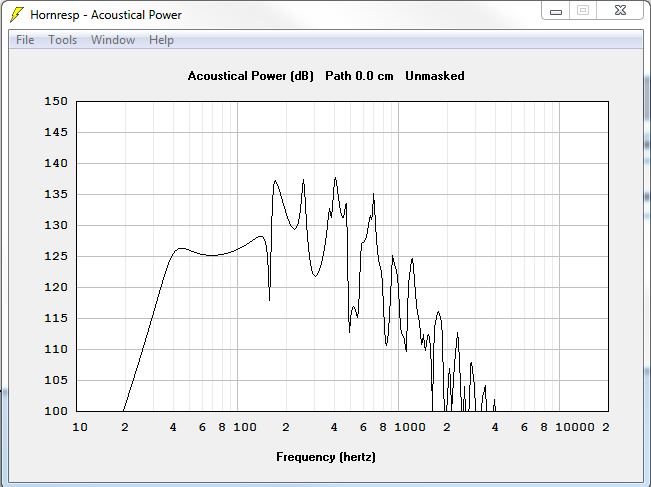

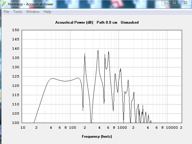

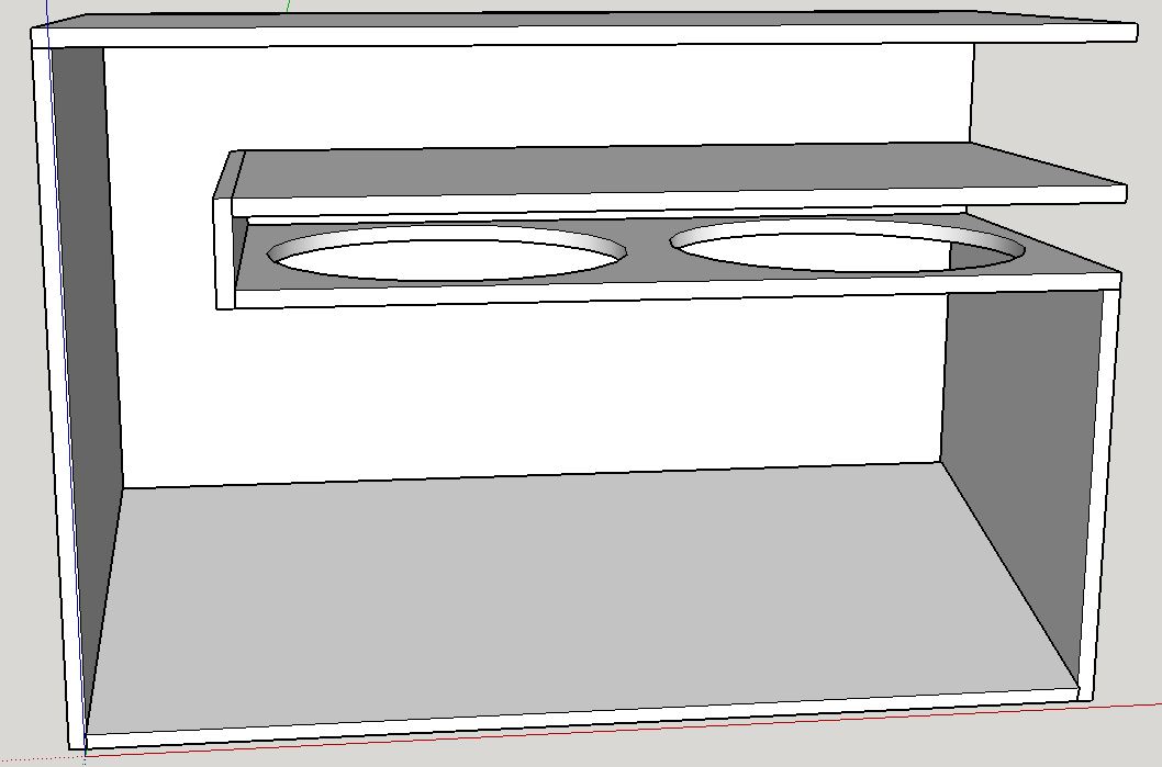

I am trying to put the finishing touches on the design so I can start building when they arrive. Here is what I have so far:
Questions:
1. The high frequency response gets quite ugly above 150hz or so. Should I be concerned about this? I would like to cross over as high as possible
2. The port velocity is very high, do you think this is going to be livable?
3. How do I correctly measure the lenght of the port in the drawing I submitted? For the simulation I basically measured the length down the middle of the port, around the 90 degree bend, until it intersected with the rear chamber. Is this correct?
4. the high frequency response gets a bit better if I choose "mask rear chamber resonances" Is there anything I can do when I build the box to mask these resonances? eg. Line the walls?

1. It's not ideal but a bit of stuffing could help a bit. In reality really sharp spikes and dips won't be present in your measurement of the finished product but those spikes are pretty wide, they aren't going anywhere without damping. You have to figure out which part of the box is producing the resonances and damp it. It's probably a combination of the backside and frontside. Damping the frontside will just accumulate moisture, not sure how viable that will be.
2. If you are actually going to use the high pass filter as shown in the 3rd pic that will knock the velocity down a bit. Maybe by as much as half.
3. Straight down the center is fine, right from the part where it joins into the bigger part of the box to the end. Not sure if Hornresp calculates end correction for segments, probably not, so you could add a couple inches to that.
4. Yes, damping. That's all you can really do short of a complete redesign. Hornresp can simulate damping, not sure if that applies to this type of enclosure or not.
How are you going to install and maintain the drivers? Is there an access panel?

How do I determine which part of the box is causing he resonances? Is there a tool in hornresp for that?
I have no plan for driver maintenance. As far as I can tell I am going to have to install the woofers as I make the box. That narrow slot is only 2 inches wide and the woofers will have to drop in from there. I know this is not ideal but I don't know a way around it.
glad to see this coming to fruition. also glad to see my "shoot from the hip" advice hit its mark 🙂
Ha yea it turned out pretty well indeed. I am pretty impressed at how little volume these woofers need. And to top it off they are treated for weather resistance. A little spendy once I get them to Canada but I think I am going to be happy.
