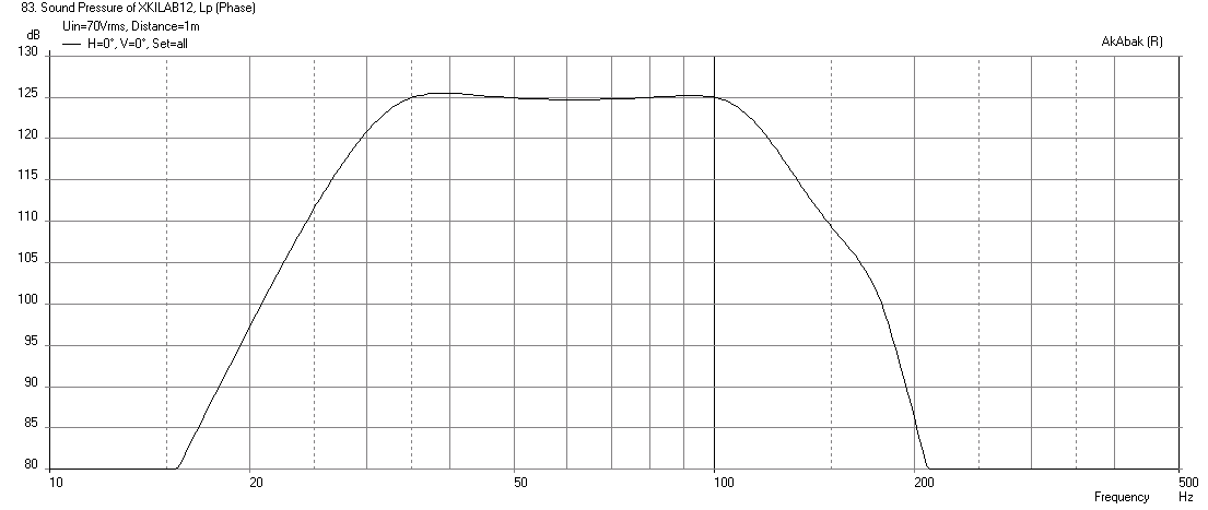

Here is predicted max SPL:

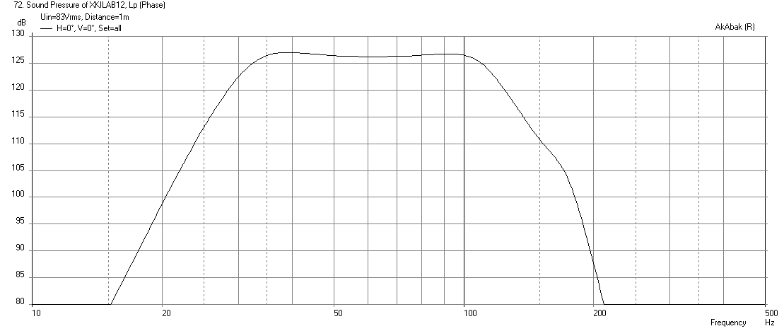

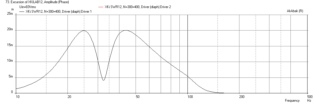

XKi with dual Alpine SWR12D2's
The Alpine is a sweet driver for the XKi, it achieves extreme cone control and your max SPL will be thermally limited and port compression limited, not xmax limited. Here is a sim for two drivers (each wired in series and the pair in parallel for 2 ohm nominal load overall). The design is slightly modified with a smaller volume of 120 liters for the total volume or 90 liters for rear chamber and 30 liters for front. The vent is now 12.5in high x 1.5in wide x 29in long. The K-aperture on the exit remains the same. You may need to add a hairpin fold to fit a 29in long vent on either side.
Here is max SPL, assuming you have enough juice to drive 83 volts into the speaker 🙂. The speaker achieves 127dB SPL in 4pi space and the -3dB point is at 31.4Hz - digs very deep. That is 130dB in 2pi space!
Here is the predicted maximum cone displacement at 83 volts with a -24dB/oct Butterworth high pass filter @26.5Hz and a -48dB/oct LPF @110Hz:

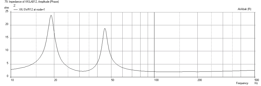

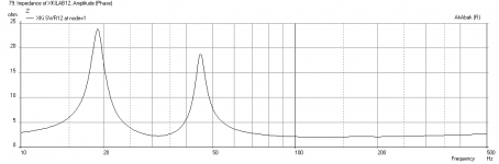

Here is the predicted impedance curve showing the nominal 2ohm load and max impedance of about 25ohms:

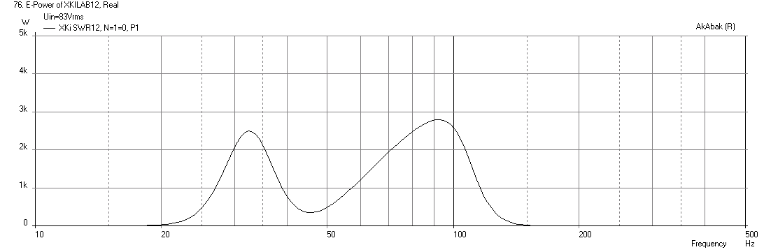

Here is the predicted electrical power required at 83 volts drive (almost 3kW!). The SWR12D2 can handle 3kW peak loads so this is OK from a peak standpoint not sustained RMS. For sustained RMS, the rating is 1kW ea or 2kW total:
If you want to operate this at a thermally sustainable RMS of 2kW, then the max drive voltage will be 70 volts RMS (with 17mm cone excursion), and the resulting max SPL in 4pi will be 125dB, and 128dB in 2pi space - not bad at all:

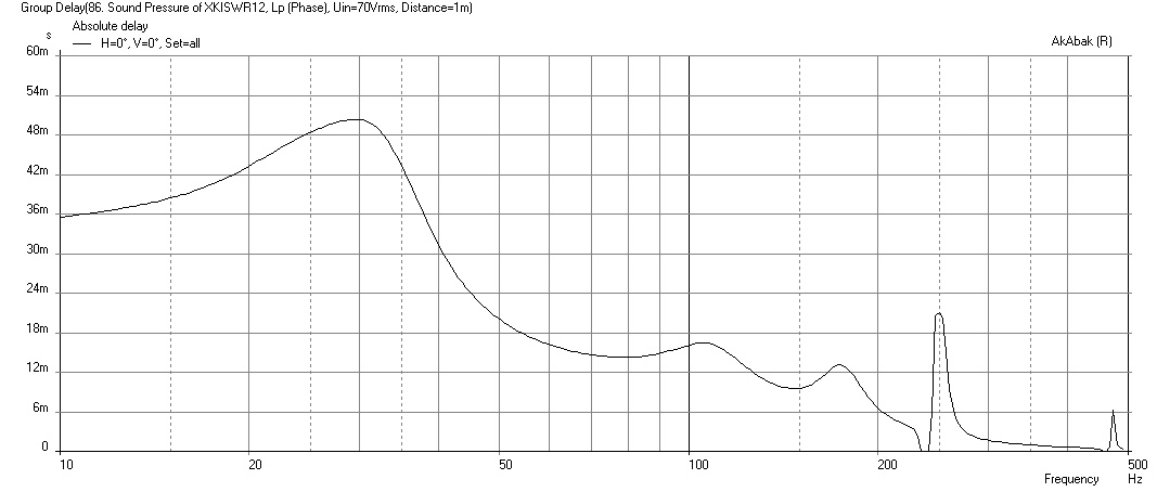

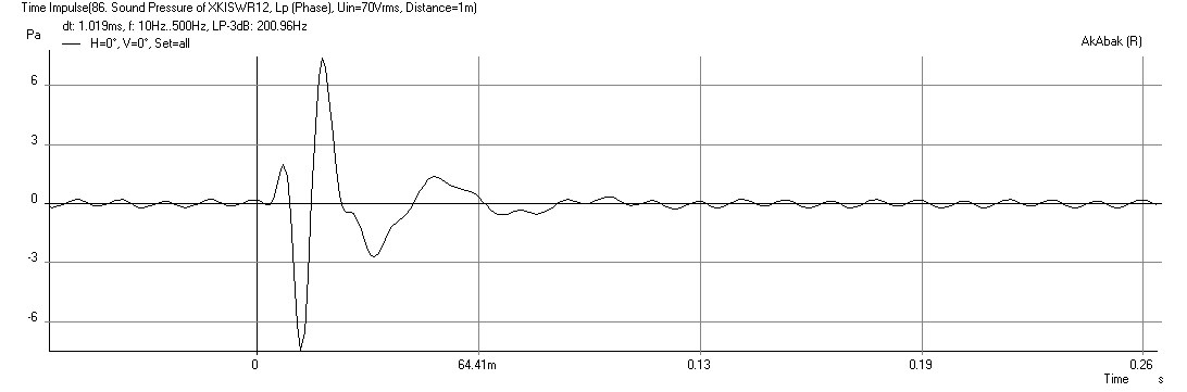

The design has a negative going leading pulse if you look the impulse function, this means you should flip the polarity on the drive (or phase 180 deg flip) in order to get the proper kick on the leading edge:
Also note that the design has an inherent time delay, similar to a horn etc of about 14ms so you will need to use the DEQX to add delay to your tops for time alignment with this sub. Here is the Group Delay as a function of frequency:

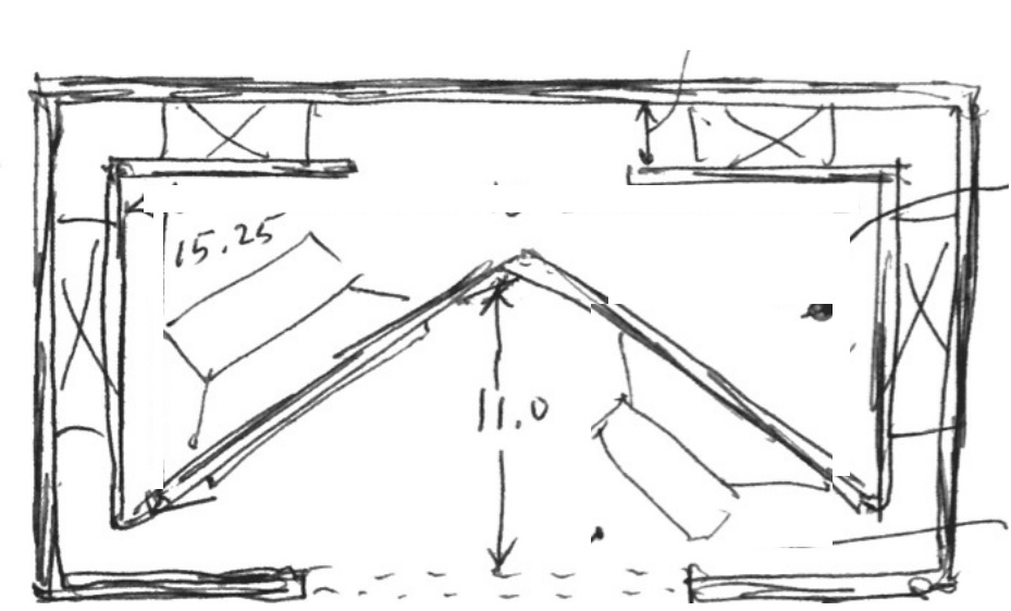

Hi xrk971 and Beat Street,
Beat Street pm'ed me w/ the following information looking for a sketch of the enclosure he is planning for his car:
"BeatStreet enclosure details:
2015, June 03
- dual Alpine SWR12D2
- like picture in Post #26
- details in Post #28, but: size 15x40x15 vent 1.75x13x33.5"long"
I sketched out a rough first TRY. There just is not enough volume here to do this, maybe X can figure out some other way to do this? But, it looks like Beat Street needs a larger box. Or, just go w/ dual sealed.
P.S.: Please, check the math! 🙂

Tb46 would 15x40x15 be enough volume for the original size vent size 12.5in high x 1.5in wide x 29in long.If not you can draw it 15x42-44x15.
Tb46,
Thanks for doing that. The XKi has wraparound vents on the ends of the box. The front chamber volume is half of rear chamber volume, total volume was 125 liters IIRC. It's a tight fit and given how big that rear magnet is, we may have to go with the chamber ratios as you have drawn. I can rerun sim but this will decrease cone control. We keep running into envelope problem of too small. Even with BR - the volume is the volume of you are optimizing for extension and power.
Maybe dual 10 in SWR's are in order for this small trunk space?
