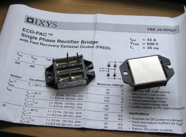

Nuuk said:
I asked this in another thread but I don't think that anybody responded.
I have seen it claimed that a ready-built rectifier bridge is better than using individual rectifier diodes because the diodes in the bridge are more closely matched, being built on the same silicate strata.
Any comments chaps?
If you use something like that, maybe. I didn't try them yet for sonics, but they better be good.;)

Please note that a thread was started in the Solid State section to discuss transformers and the anomalies we are seeing with the latest chip amps. So is the consensus in this thread that a higher rated diode will sound better ceteris parabus than a lower rated one from the same company?

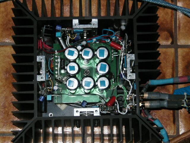

Peter Daniel said:
I didn't know you were such a tweaker Fred;)
Hi Peter,
You must have forgotten this thread from your H. Potter days.
http://www.diyaudio.com/forums/showthread.php?s=&threadid=2197&highlight=Aleph+fast+bridge
If you read this link, you'll notice that Fred (HH) used the IXYS Fast diodes in his tweaking of his Aleph3, having tried many others diodes (Way to be consistant Fred:checked: :up: ).
Fred, your contributions to the forum have alway been appreciated.
Question: Peter, what diodes have you tried on your Aleph 5? You have touched on it before in one of the past threads, but I couldn't find it. Do you think your MUR860's are too small for an Aleph 5 if used per rail in a monoblock?
Thanks,
Rodd Yamashita
PS: Peter, has the H. Potter legacy officially become the stuff of legend?
HH's Tweaked Aleph3
HarryHaller said:
Any Aleph amp tweakers out there?
H.H.
Of course I remember.;) The above was a first post from HH that I saw and we started on this forum in about the same time.
I used regular bridges in my Aleph5, because at the time I wasn't aware of a difference thay make. MUR860 might be a bit small for that application, but you can either parallel them (but again I don't know how it changes sonics), otherwise you could use MUR1560 as I remember they sounded pretty good too. If you need more softness and presence in vocals, MUR1520 is a good candidate. Don't use diodes from Fairchild as they are very edgy and have glare. I found Motorola and On Semi parts better sounding.
In my AlephX I used IR 30ETH06 diodes, but again comparing 15ETH06 in my GC I found MUR better.

Perhaps you should rephrase that as "I didn't like the some of the Fairchild diode's of a particular part number." I think that the whole subject of high speed diode selection and the use snubber circuits is just starting to be addressed. That was the whole point of this thread. As I have mentioned before, the regulatory requirements for lower levels of EMI (RFI) have developed a new design criteria for high speed diodes. The original design emphasis for high speed diode were for fast recovery times.
This parameter is given as tRR (t subscript rr). Design for low tRR was to reduce switch losses in high speed circuits such as switching power supplies. Low tRR numbers give less electrical losses in these circuits. This minimizes heat production and increases efficiency for switching supplies and is a highly desirable goal.
The desire to reduce EMI contributions, as well as overshoot voltage spikes that can damage circuits, has lead to emphasis on the soft recovery characteristics. The tRR measurement is divided into a tA and tB portion. The ratio of tB/tA as well as the rate of change of the tB interval defines the softness of the diode and the amount of EMI generated by the diodes reverse recovery characteristics. Lowering of this EMI is what we are trying to do with the use of this diode types for audio supplies. Snubbers are another tool in reducing this EMI and the development of soft recovery diodes was to free the designer from having to use these snubber circuit which and cost and complexity to a switching power supply design. Selection of diodes based on these tA and tB numbers on the datasheets is complicated by the fact that the numbers are not always measured under the same test conditions. Reading data sheets is tricky even for engineers. Data sheets are written as advertising for parts, and are written in a way to emphasize the parts virtues and downplay it's shortcomings.
I have been doing the dreaded market survey of some of the 8A to 30A parts that might be suitable for audio supplies. For data on a couple of interesting soft recovery diodes:
http://www.fairchildsemi.com/pfPrint/IS/ISL9R1560G2.html
http://www.irf.com/product-info/datasheets/data/hfa08tb60.pdf
