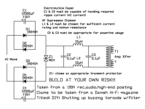

Could it be this schematic from that thread http://www.diyaudio.com/forums/showthread.php?threadid=2080

re: the DC blocking filter schematic
Thanks Peter for posting the link and pic.
There's an error that i never posted the correction for: the line about C1 & C2 handling ripple current should actually read "C1 & C4 ..."

Peter Daniel said:Could it be this schematic from that thread http://www.diyaudio.com/forums/showthread.php?threadid=2080 ...
Refering to Peter's diagram, there is no requirement for two such cap circuits. One will block DC by itself.
Referring to the above diagram, what is the Z1MOV and what does it do?

Mov
From what I understand just a Metal Oxide Varistor.
What does it do? It attempts to limit inrush current and it also snubbs up crap from diodes,switches, to some extent.

MVO...
MOV is Metal Oxide Varistor...it works as a bidirectional zener...they exist in various voltages...
The voltage rating is the voltage at they begin conducting and they clamp the voltage at this value...

The varistor would do more good after the chokes which act as impedance limiters. The way the varistors is wired it would have to absorb all of a surge and better do it quickly (varistors are not as fast as good caps, their advantage is the nonlinear resistance). The chokes would limit the slopes of a surge, and whatever gets through is shared between chokes and varistor -> much better supression!

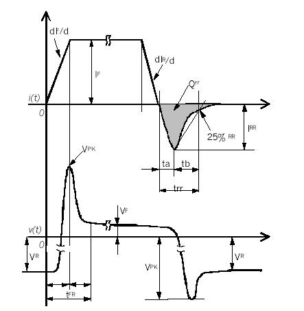

Re: I must be getting soft in my old age
Can you explain why a large tB/tA indicates softness? Intuitively, I assume we should worry about the total energy in the spike, i.e. its integrated area. Then secondly, we should worry about the slopes of the spike. There I'd guess the leading edge is as troublesome as the trailing edge. One way to bring both down might be to add series resistance at the expense of efficiency.
I wonder if all the reported sonic differences between diodes still matter if proper filtering is done, e.g. PI filtering with resistors between rectifier and first set of filter electrolytics and common mode choke between first and second set of electrolytics.

tRR noise
Actually the slope of the tB portion of the reverse recovery is important. I think the the longer tB times may be a smaller slope ie. a slower fall time. The design emphasis on soft recovery seems to be fairly recent and the tB/tA ration is described on relatively few part's data sheets. The increasingly strict regulatory enviroment for EMI compliance both here and in Europe
will lead to more information on and parts choices for fast recovery diode designed for soft recovery. Filtering noise in the supply is a good idea but a lots of RF gets through filters from paths like winding capacitances in chokes and transformers. EMI suppresion can be very difficult to measure and even more difficult to implement. Snubbers still seem like the best bet for RF noise reduction.
