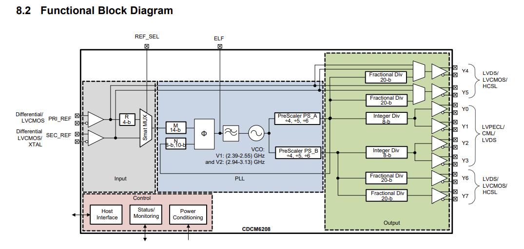

I have been thinking about a similar project, just not for extending stereo I2S (because 4ch/8ch I2S are already easily available), but extending 8ch to 16ch or even to 32ch. There are very very few USB UAC2 -> 16ch I2S bridges, and basically none USB UAC2 -> 32ch I2S bridges, while the USB gadget can handle that data flow easily (it could run 50+ 48kHz channels with just a minor modification). But the principle is identical, no matter how many channels.
Please let me a few questions: IIUC you generate all your I2S clocks with 2350. Does 2350 have enough dividers to generate both incoming I2S clocks and outgoing I2S, or do you generate the outgoing (i.e. slower) I2S with PIO? Or do you use individual PIOs for generating the incoming and outgoing clocks with PIO assembly program, using the 2350 PLLd master clock (you say 8x BCLK)?
Does 2350 have an option for external precise clock (e.g. standard audio MCLK 24.576MHz), to avoid any PLL alltogether? Does it allow switching between clocks (e.g. to allow switching between 48kHz and 44.1kHz clocks)?

A single PIO state machine generates all the clock signals (MCLK, BCLK, LRCLK) for the incoming and for the outgoing I2S signals. Notice that the two outgoing I2S signals share the same clock so it's just matter of outputting 6 clock signals (notice also that the RPi does not need a master clock and not even the MAX98357s I'm using for testing need it, but the MA12070 wants it so... it's not like I'm paying for it).
When I realized that I could offload al the clocks to a single SM and use others for signal management instead of trying to intermix clocks and signals management, it all became incredibly easier. And of course you can only do this if you're the clock master!
About clock "precision"... at this stage I'm just using a standard Pico clone board, so the PIOs' clock is extracted from the sysclk of the board. And since there is a 12MHz xtal on the board, all the 48k, 96k, etc... rates are spot on. I really don't care about 44.1 and multiples but, yes, in the future, the idea is to switch to a custom PCB and there I could use a "audio" xtal. Notice that also these small Pico boards support external clock generators / external xtal, so I assume you could "run" them with an audio xtal.
BTW: I'm using the 2040, I do also have a couple of 2350s but for this stuff I did not need them.
Then again: I'm not thinking at this as a general solution. I just support a single fixed incoming signal rate, with a single supported signal format (S32_LE) and I'm producing two stereo outgoing signals with half that rate. Adding support for dynamic rate switching, more formats, and so on would be relatively easy, but that's not my use case.
