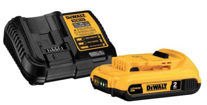

However, I could get back to my DeWalt battery idea... remove the battery pack inside the cabinet, which also frees up volume, and plug in a 20V drill battery which should provide plenty more voltage. These batteries only have 1.5Ah, but I can swap them if I find a battery bay from a scrap DeWalt tool.

... my DeWalt battery idea... remove the battery pack inside the cabinet, which also frees up volume, and plug in a 20V drill battery which should provide plenty more voltage.
Excellent idea… i love my DeWalt 20v drill.
A bit expensive maybe, and one might want an 2nd charger (or at least the socket part) so you can really quickly swap batteries.
https://www.homedepot.com/p/DEWALT-...n-Battery-Pack-with-Charger-DCB203C/315470771
Not a new idea. It is (similar) the same technique Jeff used for his Pass RIAA amp, but he just uses alligator clips to hook them up.
dave
Most power tool LI batteries don't have discharge control. You can always use Dewalt DCB1820 20V to 18V adapter to address this.

Yes, a scrap charger or tool sold "for parts" should do. I already have 3 batteries and that was part of the original idea. Easy swap would be critical as I imagine the battery would get drained quickly.

Sure enough, they have 3D-printed battery adapter for DeWalt and other brand tools: **Dewalt 20V Li-ion Battery Adapter RC Robotics Power Output Connector DIY** | eBay
Maybe more expensive than a scrap drill or dead charger, but prettier 🙂

One more thing... Dewalt doesnt have BMS in their batteries. You must have at least low voltage cut-off at around 15V. If you discharge them to a certain V/cell, they crap out permanently.
You can easily find a BMS for dewalt battery, its 5 cells series. They dont need balancing when discharging so only 3 wires have to be connected
Which means that your BMS can be located anywhere
Buuuuut... If you decide and find a super small BMS that can be fitted inside the battery you can use any 20V charger to charge it.
