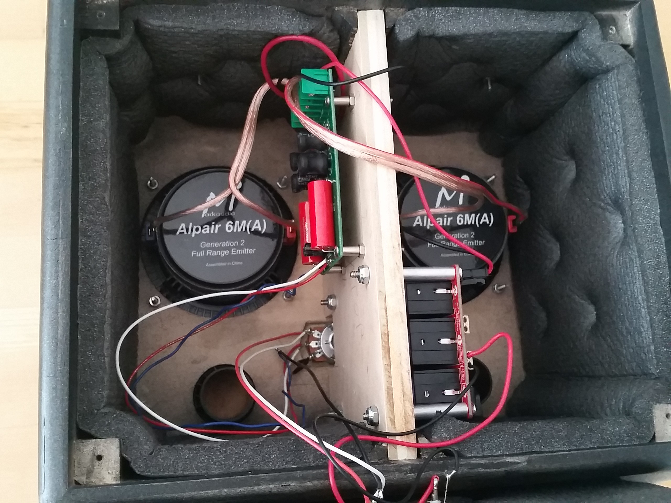

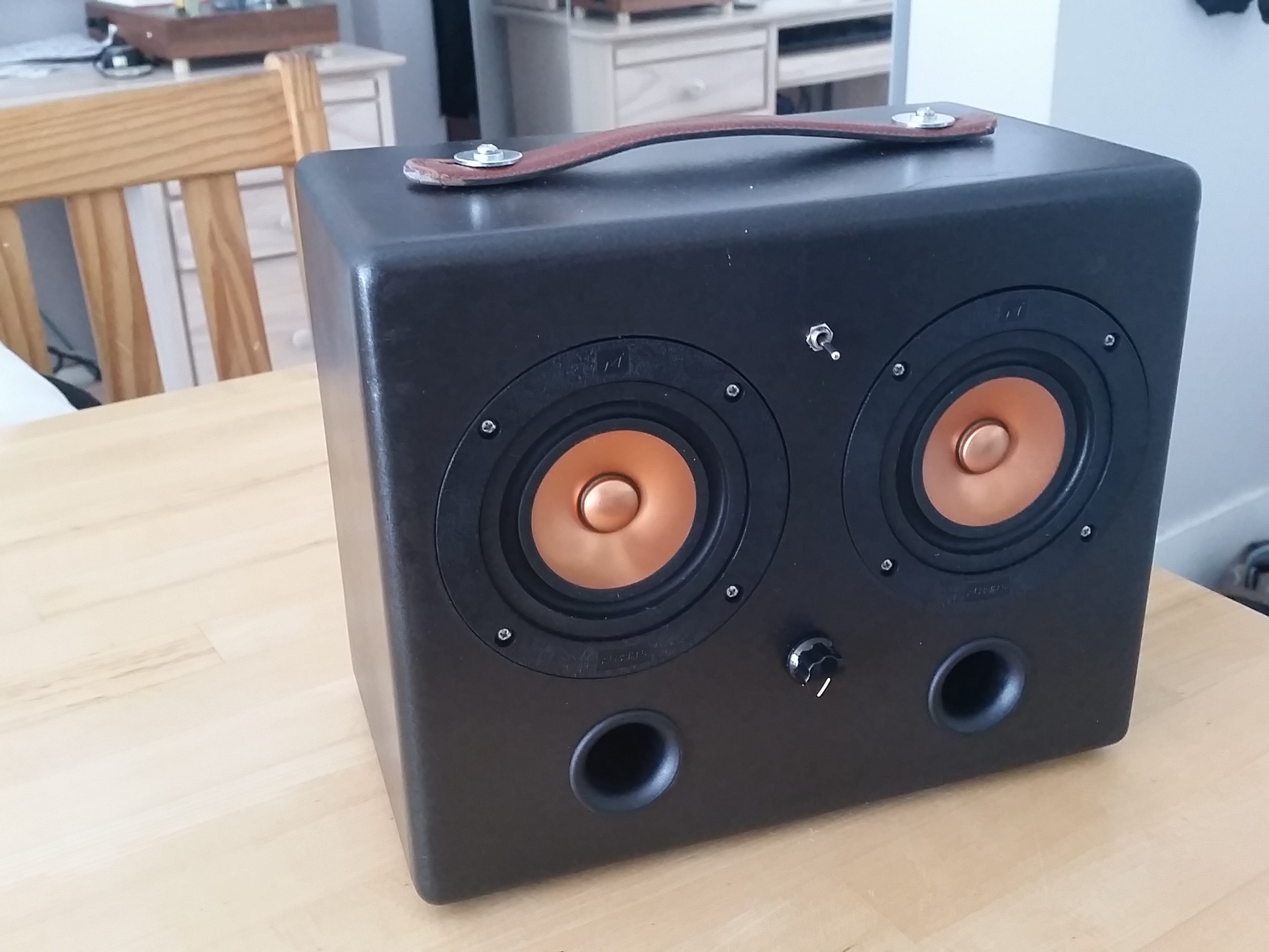

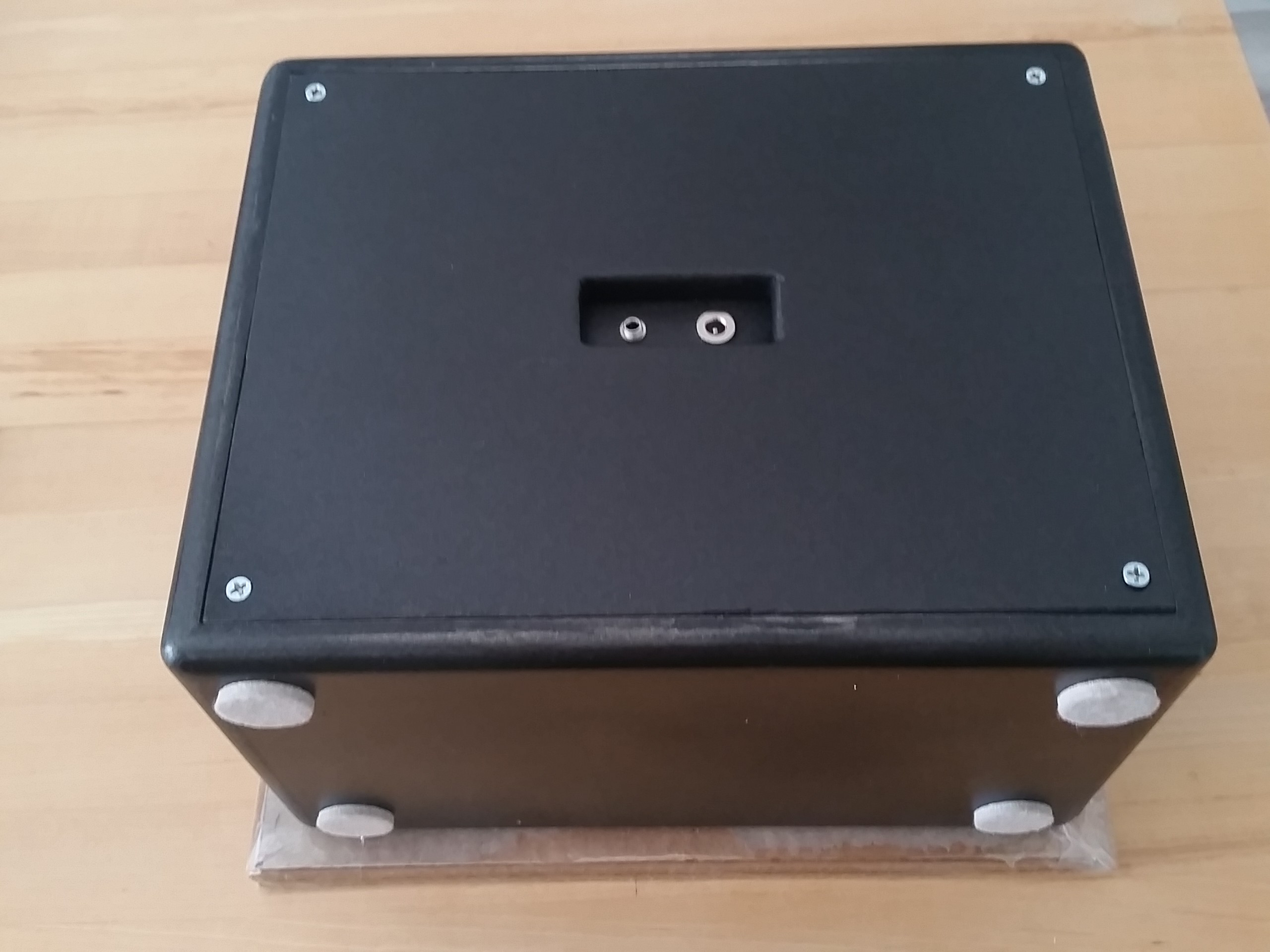

So, here it is... I cheated on the speakers' break-in process and tried to turn it up for a few moments. I have to say that the Alpairs, at 86 dB efficiency driven by a 15W/channel amp, are underwhelming. A little bit louder and cleaner than my CA box, but not up to the task.
I believe speaker efficiency is really what makes a difference here. Maybe I can try that single 99 dB Dayton Audio with the two 15W channels strapped together.

Yes, Imagine that I've two of that size'.
And with open back. In an open space, you don't have the room's walls reflecting the back emission of a speaker.
Nice and professional job you've done, but the physics tells you the basic lines...that also applies for the Dayton you mention...search for Hoffman's law in speakers
