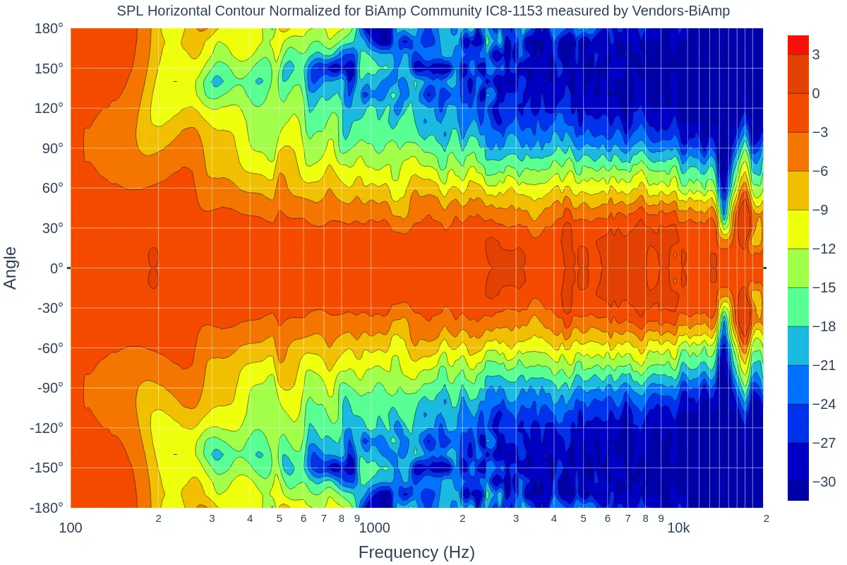

Some of these speakers are REALLY good. Way better than JBL 4430, (cautiously : ) approaching Earl Geddes designs-good. Three examples just from the chronological top of the list:
https://www.spinorama.org/speakers/LD Systems DDQ15/LD Systems/index_vendor.html
https://www.spinorama.org/speakers/RCF ART 935-A/RCF/index_vendor-pattern-100x60.html
https://www.spinorama.org/speakers/BiAmp Community IC8-1153/BiAmp/index_vendor.html
BiAmp Community 3-way is probably the most impressive with its controlled directivity down to Schroeder:

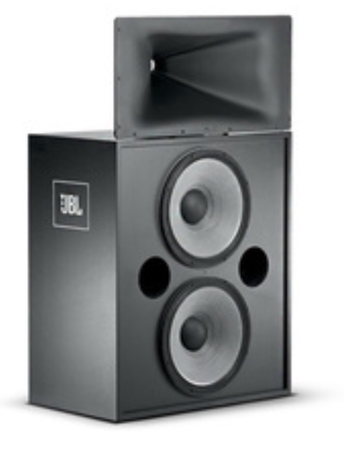

I would suggest getting older cinema speakers like the JBL 4722N, they'd do home, PA, studio, cinema or anything else. The newer ones are definitely smaller/shallower but their datasheets are also anaemic, with some not even disclosing as much as the crossover frequency used.
Ok, then this.So when a fellow member has WAF problems, you suggest this ;-D
https://jblpro.com/en-US/products/c211
