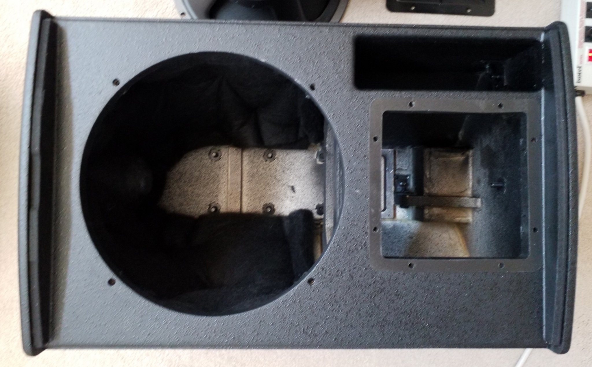

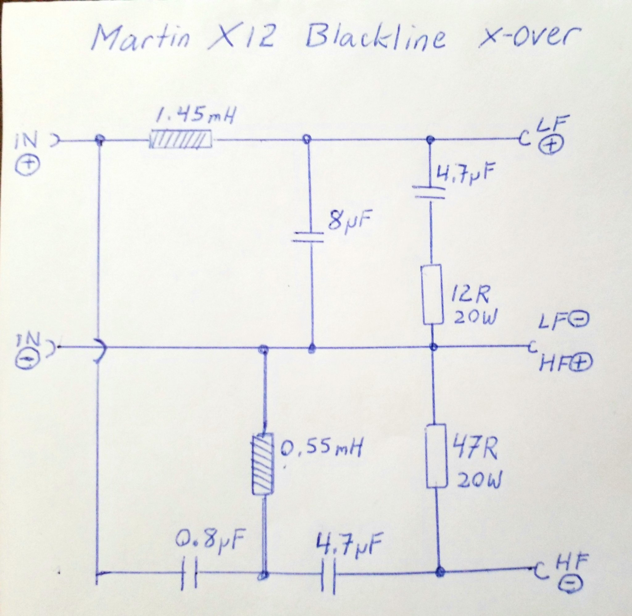

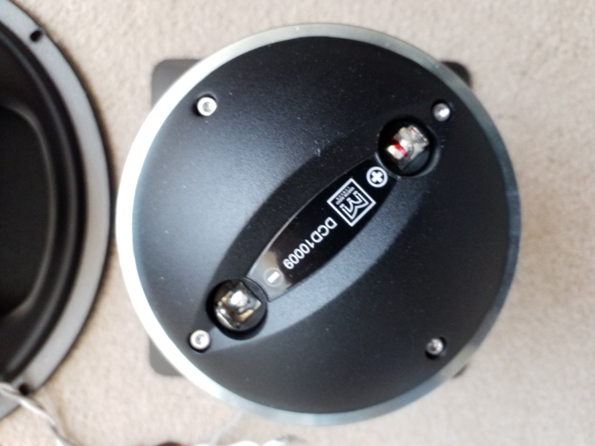

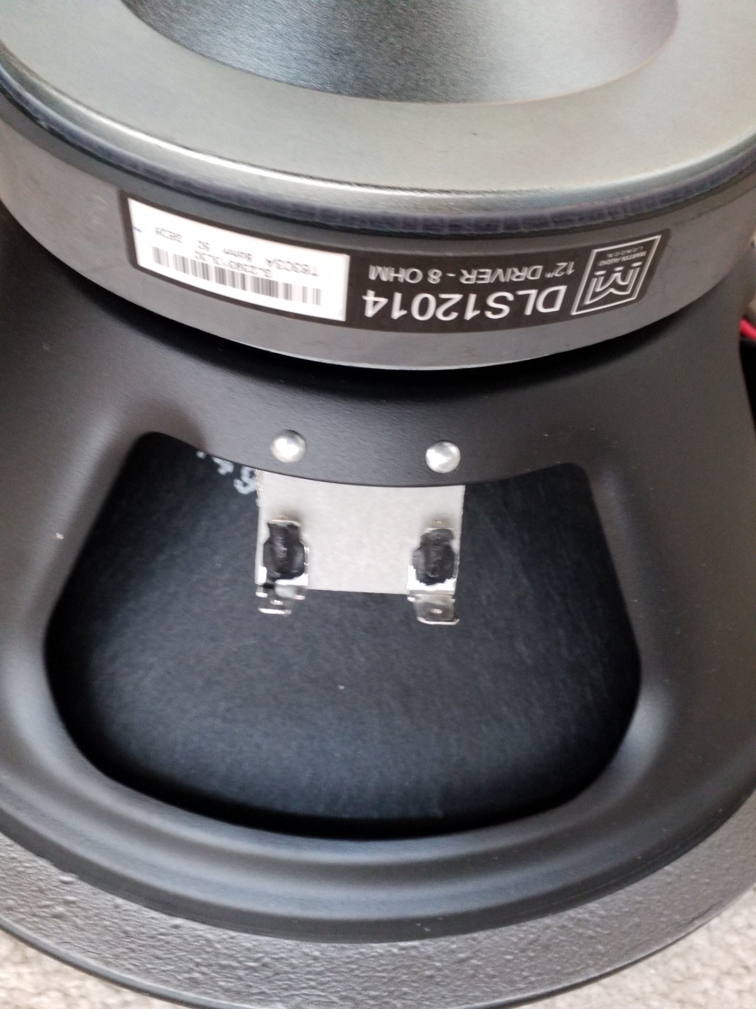

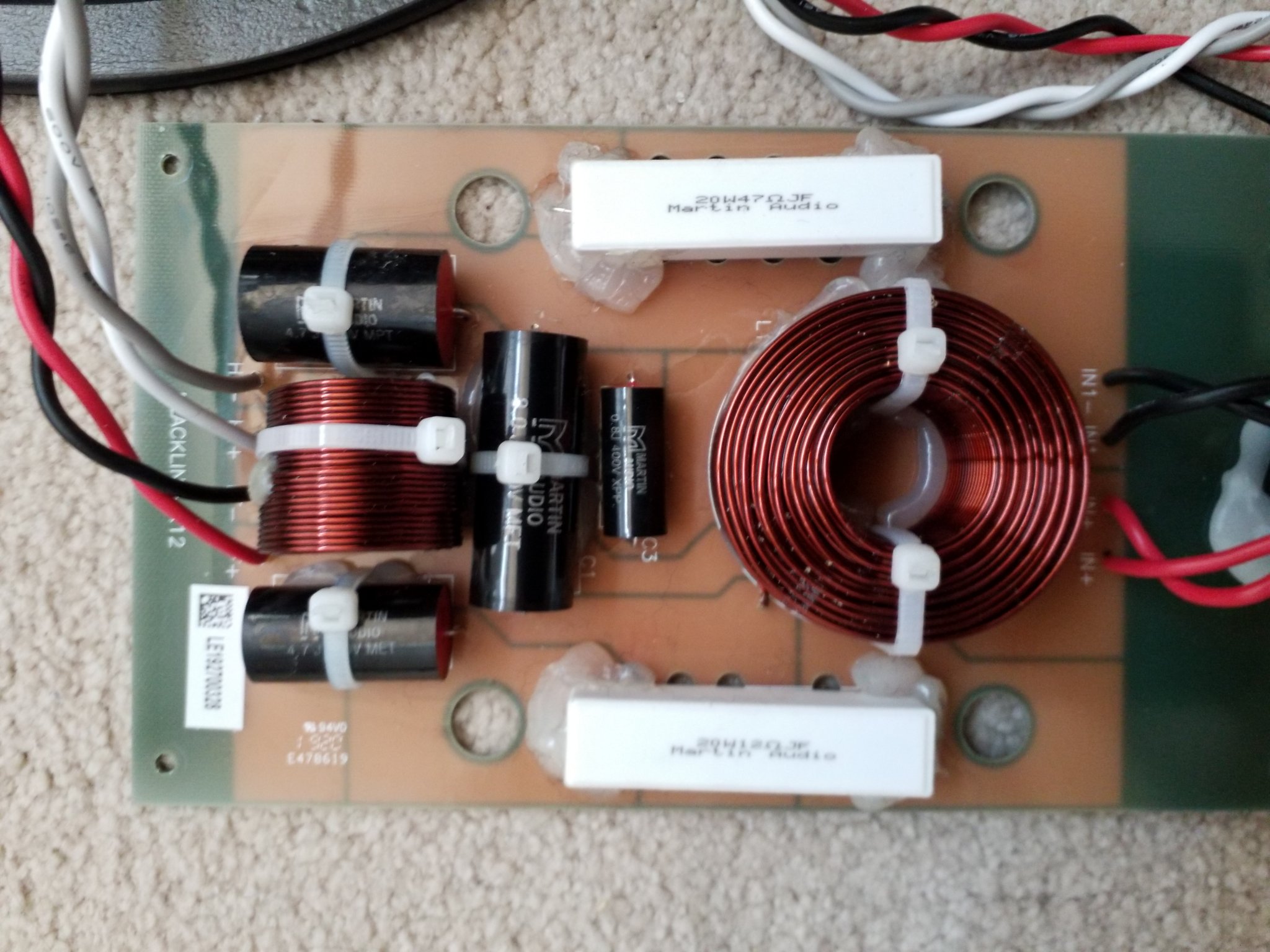

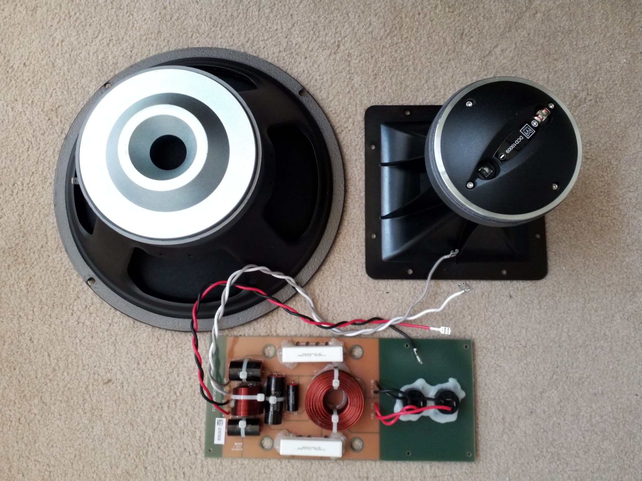

Here's the inner workings of the Martin X12 -
All air cored inductors and film caps. HF is a celestion CDX1-1745 and LF is a 1225E. WG is 80x50 based on listening observations. The top end sounds like a decent dome tweeter. Mids are clean and open. No protection . Just a simple design that sounds better than many 4 digit priced speakers. If anything needs improving, its maybe more dampening material in the right places.
