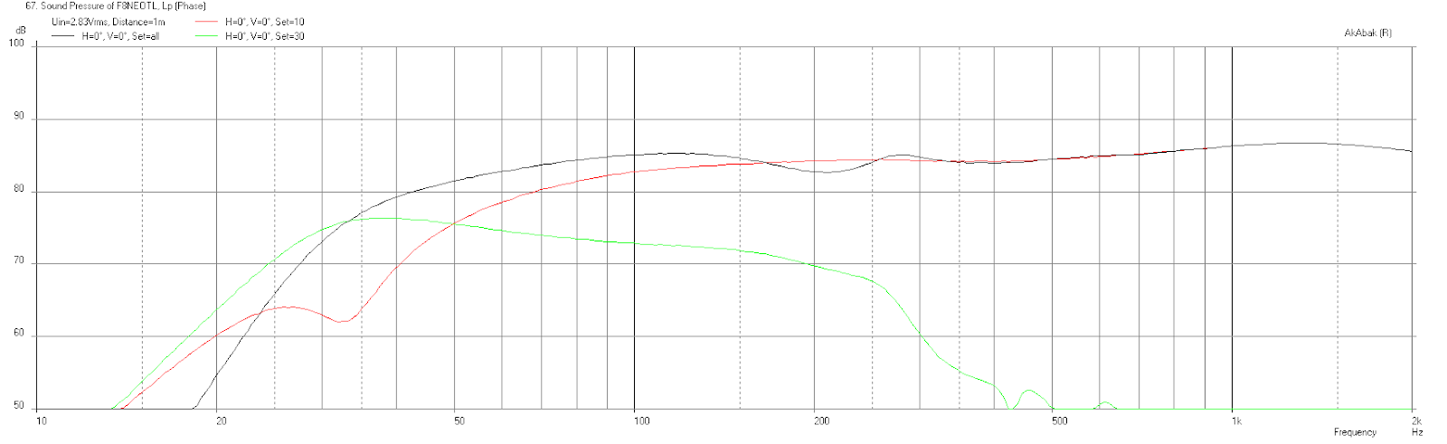

There is an 8in version that seems to have nice TS parameters for vented/TL style alignments. If one could make any type of box, what would that box be? A MLTL, or a tapered TL? Or simply sealed cabinet?
Cube Audio F8 Neo Fullrange Drivers
A simulation of the F8 Neo in a tapered TL (similar to the one designed for the 10D/RS225 FAST) yields a pretty nice shallow slope bass fall off that will integrate well with room enhancement modes. This is for 4pi open space hence about -6B down from native 91dB sensitivity for 85dB.
attachment.php
Ignore the cutout for the small 10F driver and the main F8 cutout is an octagonal hole.
803725d1576909032-10f-8424-rs225-8-fast-waw-ref-monitor-10f-rs225-fast-tl-render-png

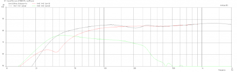

Here’s the F8 Neo:
Factory measured response:
The F8 Neo, although similar to the F10, is a different driver so I might start a new thread.
