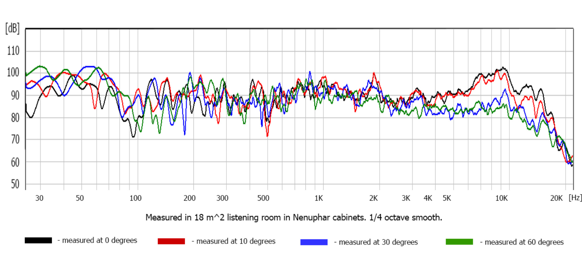

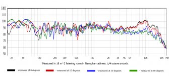

Listening experience aside, even the ancient w4-1320sb I practiced REW with last night walks this measured performance above 500 Hz. A 40 dB drop from 60 Hz to 20 kHz is a stretch without reincarnating Anita O'Day in my living room.
Shouldn't 1/4 octave smoothing be smoother?
I wouldn't be inclined to put much value on in-room measurements of the Nenuphar < about 300Hz or so. So if we set that aside (as it should be for pretty much any speaker as it's more or less meaningless) it has a reasonably flat response out to about 6KHz, usual lower treble rise from there to about 10KHz (not dissimilar to many Lowthers & equivalent units) drops to flatter output to c.15KHz before finally falling off. Not bad for a larger whizzer cone unit & better than some.
One would have thought so re 1/4 octave. YMMV.

Leaving aside the broader question of FR measurements & sonic characteristics (TBH, I find them very useful myself, although they certainly don't tell you everything) it appears from the caption on the above graph that the response data is a (presumably gated) in-room measurement of the Nenuphar speaker, in which case the LF range should be disregarded as it needs to be measured using different techniques. Be that as it may, Cube to my eyes appear to be one of the better low-volume / boutique manufacturers & while as noted the products certainly are not cheap, they also appear to be decent examples of their particular types (e.g. medium - large[ish] whizzer cone wideband drivers).

At the Nenuphar site only the sound pressure as a function of frequency is given. And the vertical axis is 10 dB/div instead of the more common 5 dB. It's obvious that hand-made is more expensive than mass production but it also raises questions. Missing are pulse response and distortion - measurements that eventually can be outsourced. Those measurements have more value to me then the opinion of any reviewer. Building enclosures yourself or leaving it to the local carpenter can be much cheaper indeed, and sometimes better performing too, when size isn't an issue.
Cube publishing those measurements suggest they believe in a correlation. This may be one of those drivers designed to be heard ~20-25 degrees off axis. Visually guesstimating it would deliver decently linear direct sound from 100 to 10k.So if we set that aside (as it should be for pretty much any speaker as it's more or less meaningless)....
At the Nenuphar site only the sound pressure as a function of frequency is given...And the vertical axis is 10 dB/div instead of the more common 5 dB. It's obvious that hand-made is more expensive than mass production but it also raises questions. Missing are pulse response and distortion - measurements that eventually can be outsourced. Those measurements have more value to me then the opinion of any reviewer.
Very likely, most such units are. However, that applies to the midrange - HF. As noted, I am merely referring to the fact (this is not startling or controversial) that in-room gated measurements are basically inaccurate at LF wavelengths and anything < c. 300Hz or so is best ignored. There is a reason why ground-plane and free-air LF measurements exist.
