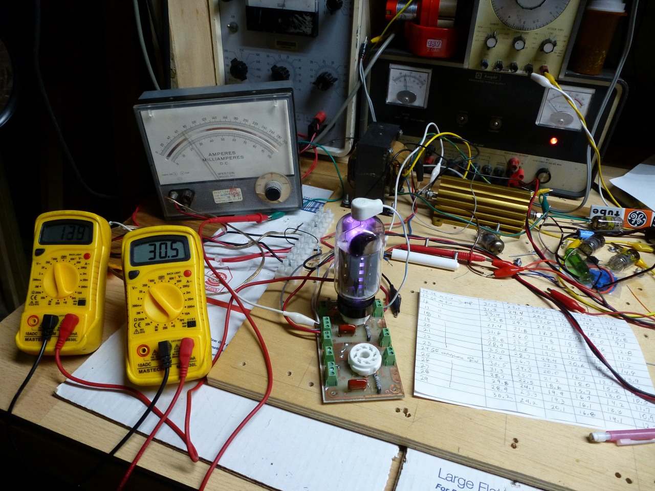

Yeah, it was the final push that this 64 year old child needed to come out and play. I cleaned off the bench and started testing some ideas. The first step is choose an output tube, and how many of them it will take to get me to 500 WPC. I whipped up some test boards to test the biggest TV sweep tubes that I had sufficient quantities of to build an amp and have spare sets. I will need 4 or 6 tube sets that are sufficiently matched for a PPP amp.

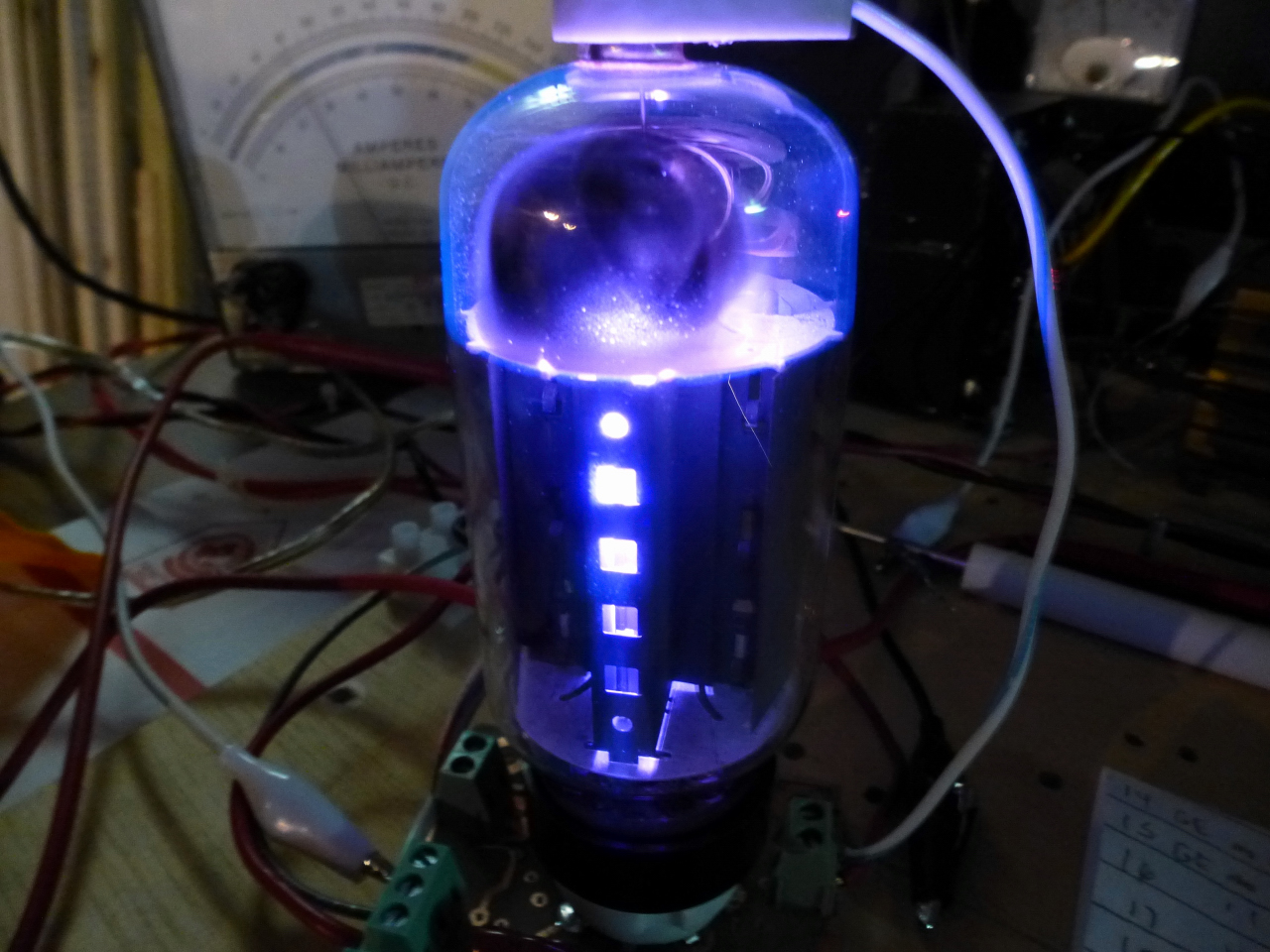

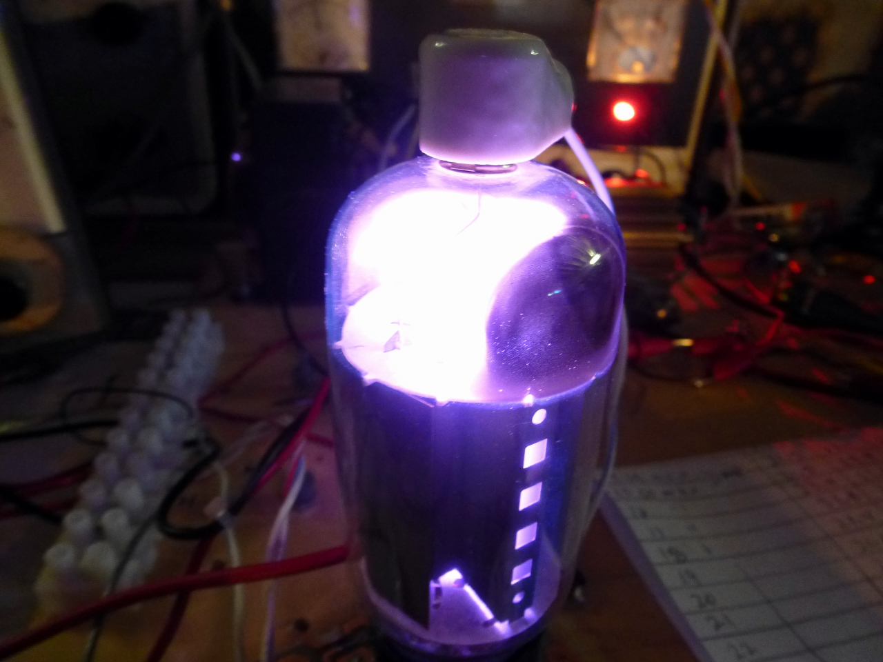

Of course the child in me just had to try to blow a bad tube to pieces. It's really dead now and will meet the hammer soon.
Yes, I really did subject a well used TV tube to brief (long enough for me to read the meters) tests at dissipation levels over 600 watts (650 volts at 900 mA). That one is still alive! When I can devise a more accurate and less abusive testing method I am going to test some NOS tubes.
