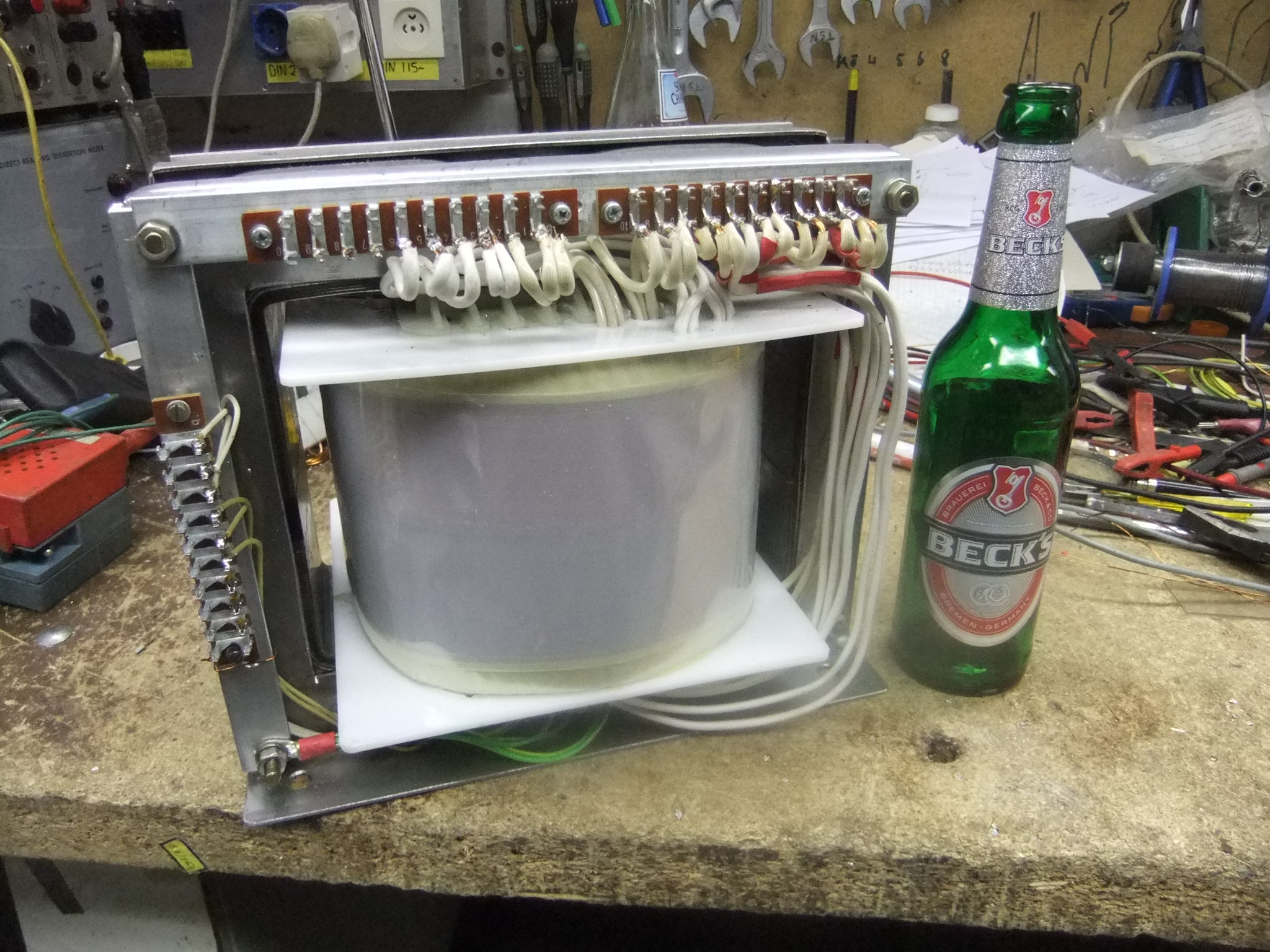

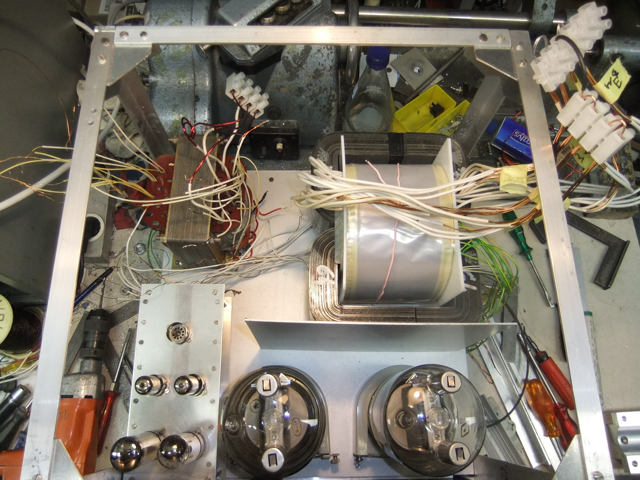

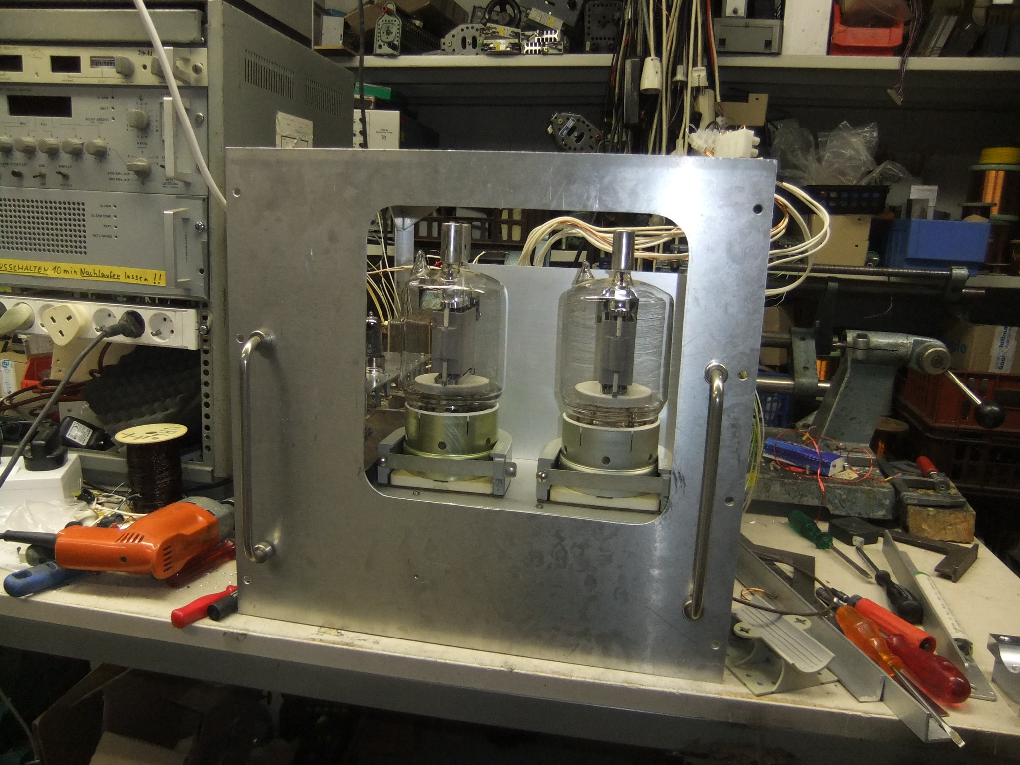

I also got an ongoing project with an high power transmitting tube amp.
But the work ist slow down due to my back problems .
The main work , especially the mecanical is done. The opt is wound and most of the major parts fitted .
I separated the high voltage power unit from the amp. The aux mains trafo is located on the amp chassis.
The output tubes are 2x GU-81, the driver 2xEL34 , the input amp are 1xE88CC and 2x EL803. Estimated output 1,2kW +Vplate 2,3kV. Mains input power at full blast 3.5kVA/ idle 0,8kVA.

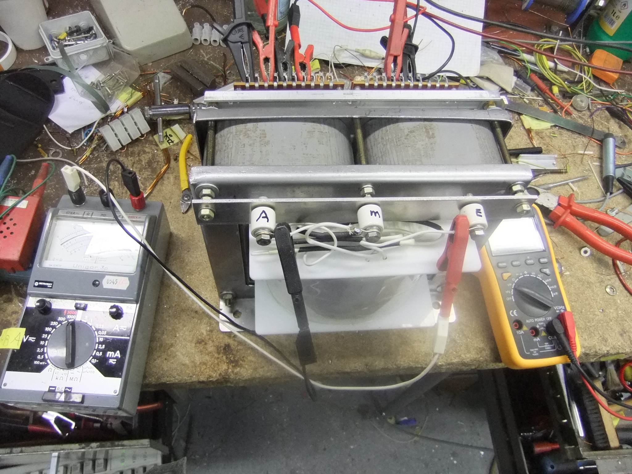

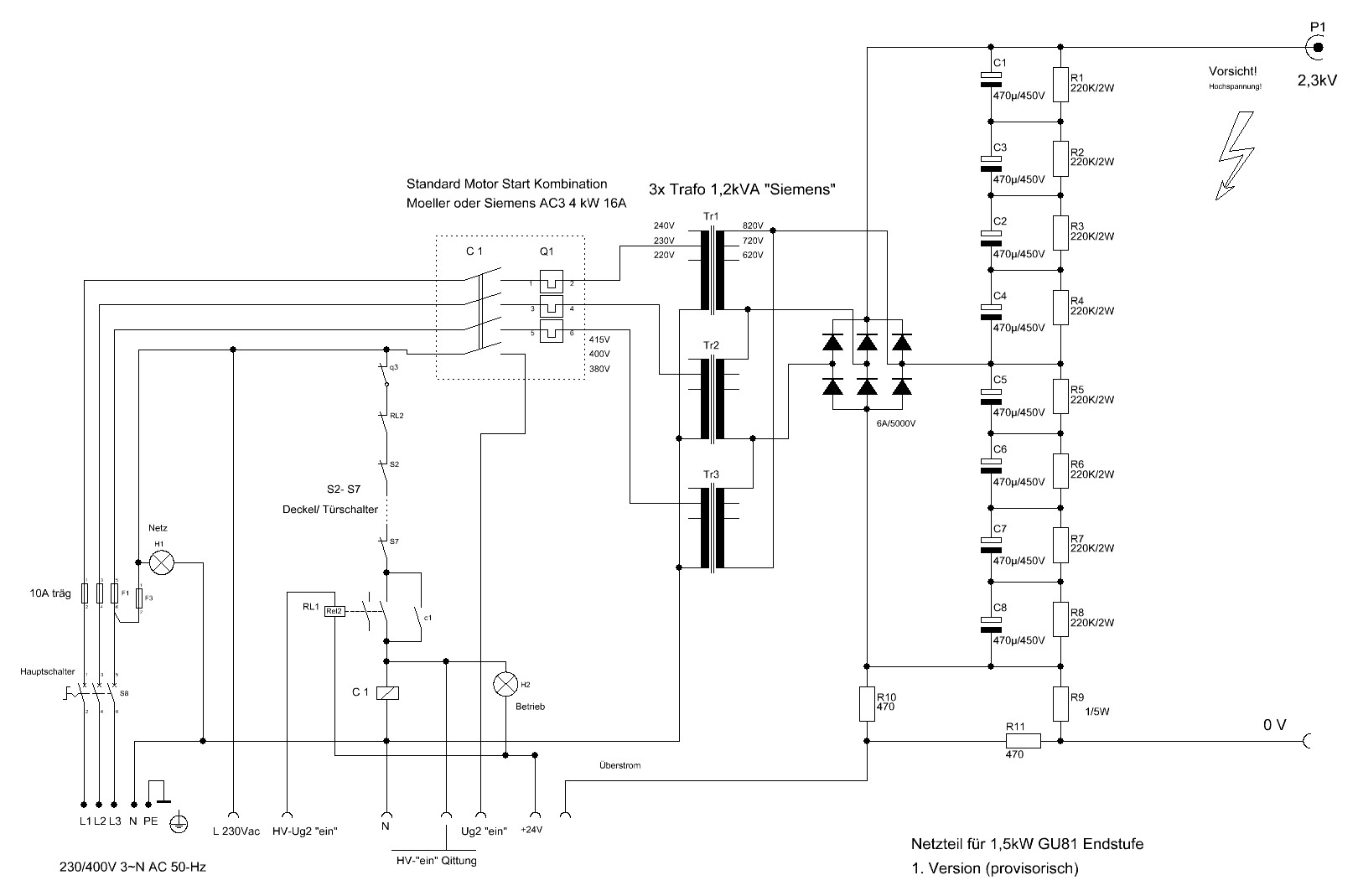

The HV mains unit is still a makeshift version with 3 identical xfmr , each got 230V prim / 820V sec. . the 2300V are derived with a greinacher doubler .. The primaries they run on 3 phases, four wires in star circuit 230/400V.
Three phases operation got the advantage of less ripple on the dc side .

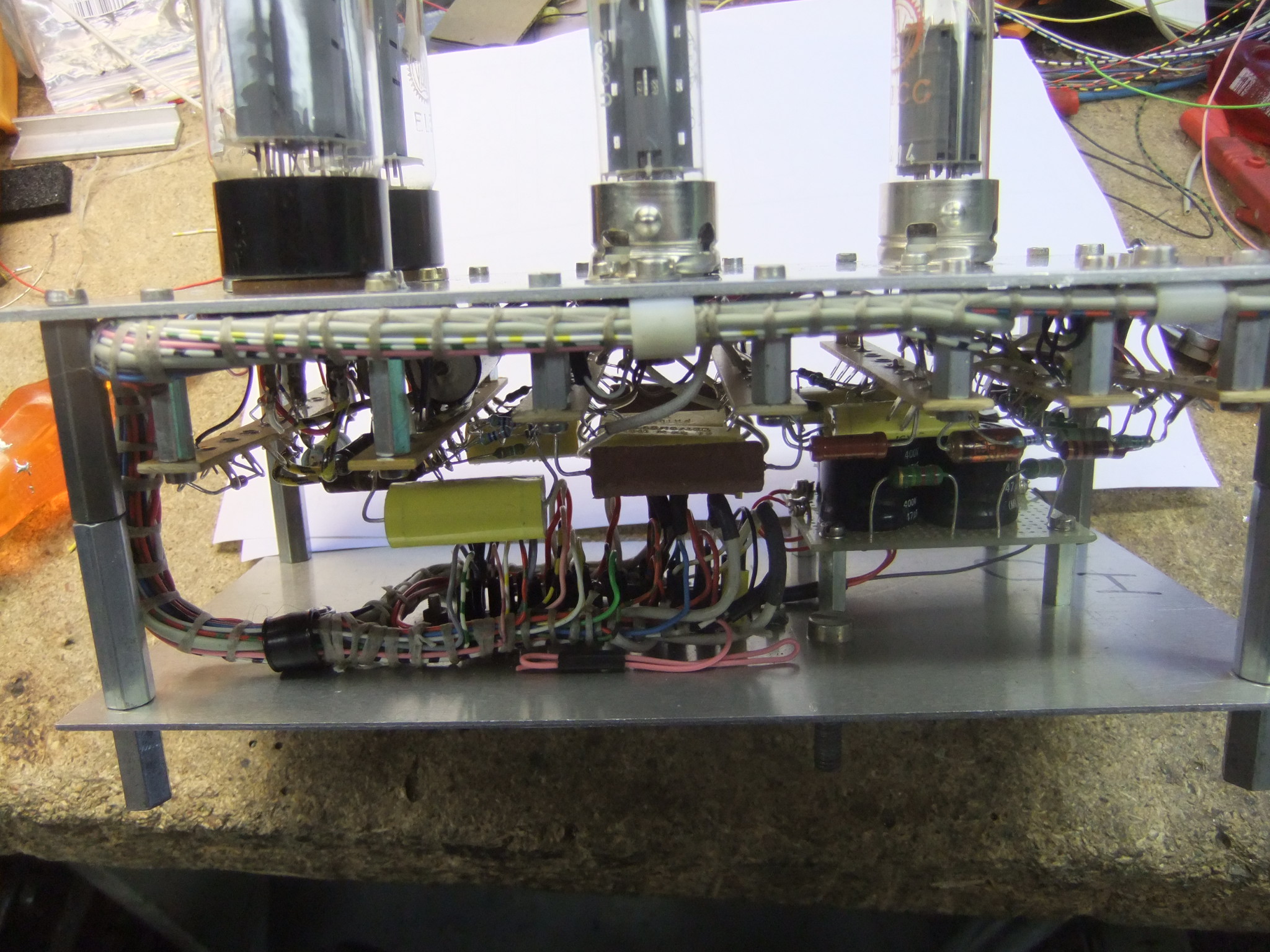

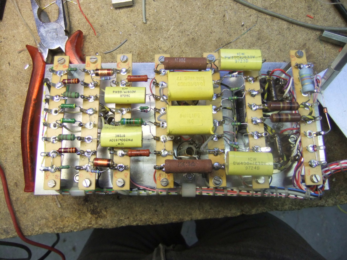

I hope I able to finish this amp stil this year.. here some pics from the construction.
The drawings of the amp will not get into the attachment window . I will find out later why. It took only the drawing of the HV mains supply .

Love to see the big amps going together. I was worried about ripple in the B+ to begin with but with a little choke and plenty of capacitor the push pull outputs don't seem to mind the ripple that's left.
Do you plan on using fet followers for the driver tubes. The big transmitter tubes really respond to positive drive on the grids. Comnoz

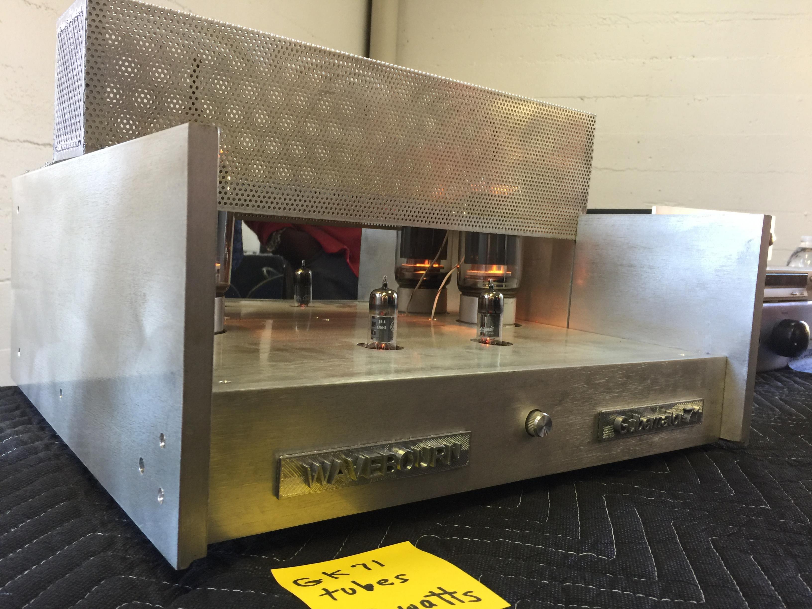

my new overkill tube amp. Just what I wanted for my little shop.....Output tubes are 4-250's in the video with 2000 volts on the plate and 600 volts on the screen. With these tubes it makes 150 watts per channel

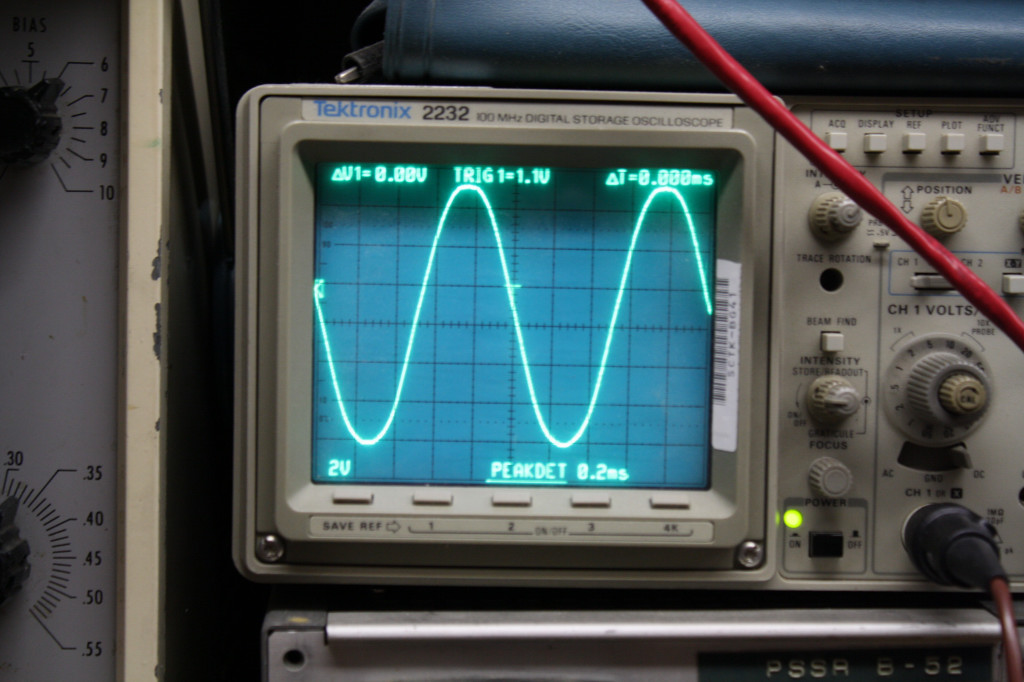

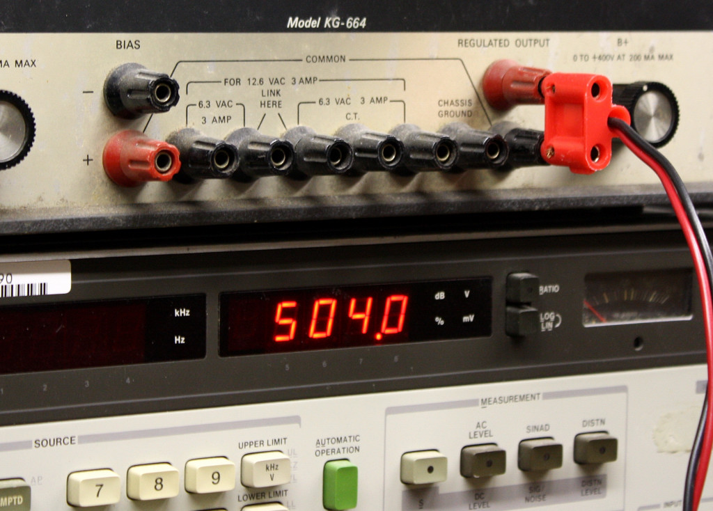

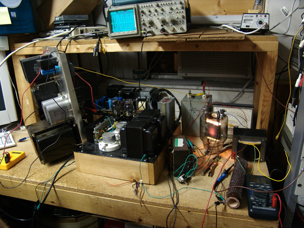

I have been guilty of talking a lot about building a big one, but the reality of actually building it hasn't gotten very far. A crude and rather unsafe "breadboard" test about 10 years ago started me down the transmitting tube route, but I wasn't happy with the results and never took it any further. I was squeezing about 200 watts from an 833A on 1500 volts Picture#1

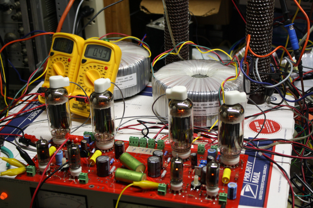

Several years later another breadboard test managed to squeeze out 500 watts from 4 overworked TV sweep tubes on 650 volts. This convinced me that my "big one" would use TV tubes, but no amp ever got built. Pictures #2 through #4.
Lately though I have quietly collected all of the necessary parts to build my "big one" and preliminary circuit design and testing is underway. Like all successful projects, I have set some goals and have some circuit designs in mind.

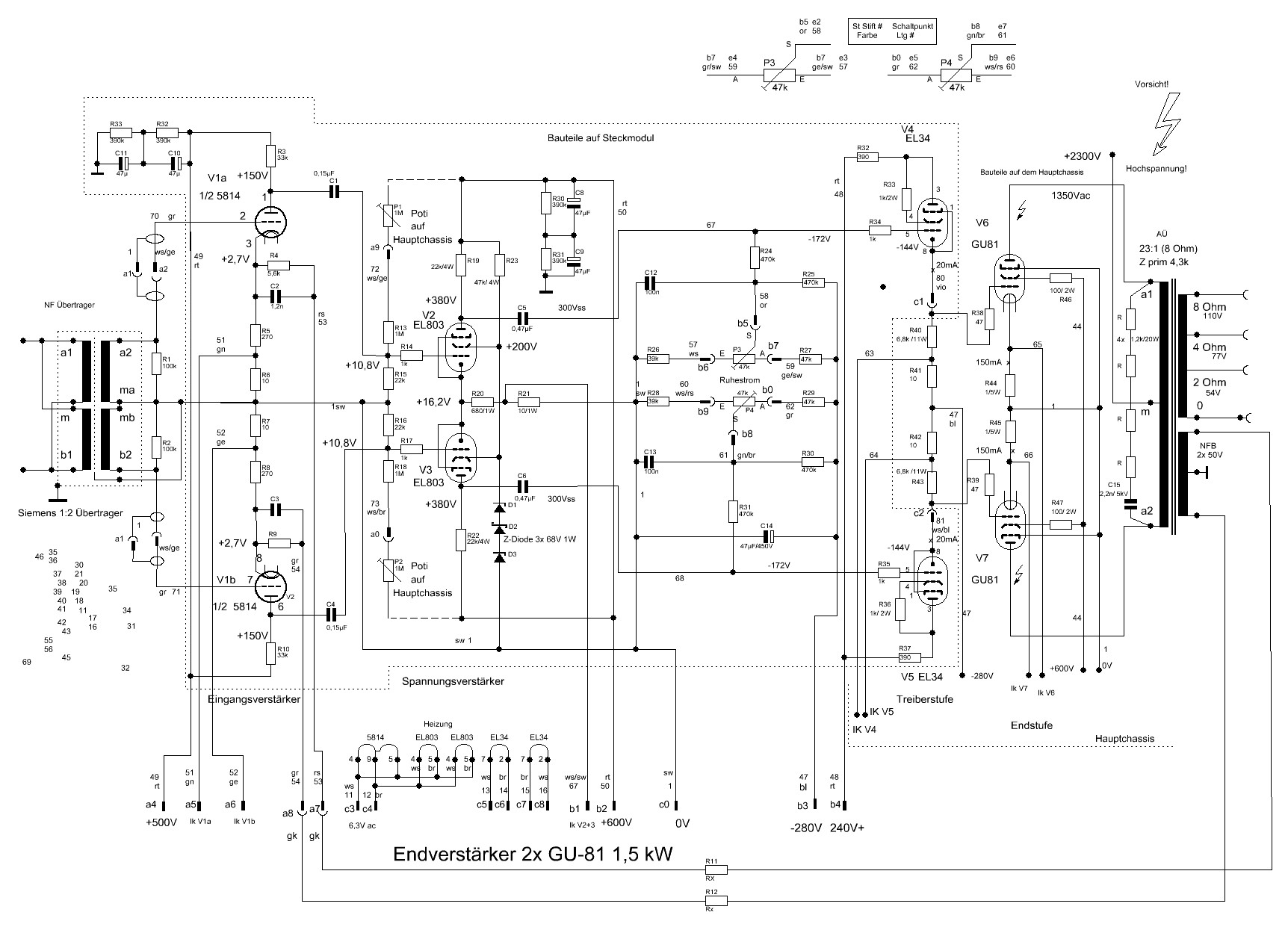

Hi ,
here are the schematic of the amp .
The complete amp consist of
the amp circuit itself
the aux mains supply for the heaters, input, voltage and driver amp.
the protection circut
and the operating unit.
The HV supply shall be a separate unit due to the weight
I will come up later with the other drawings when I find time to make them readable for others than me. Actually they are scratch on a piece of paper.😀

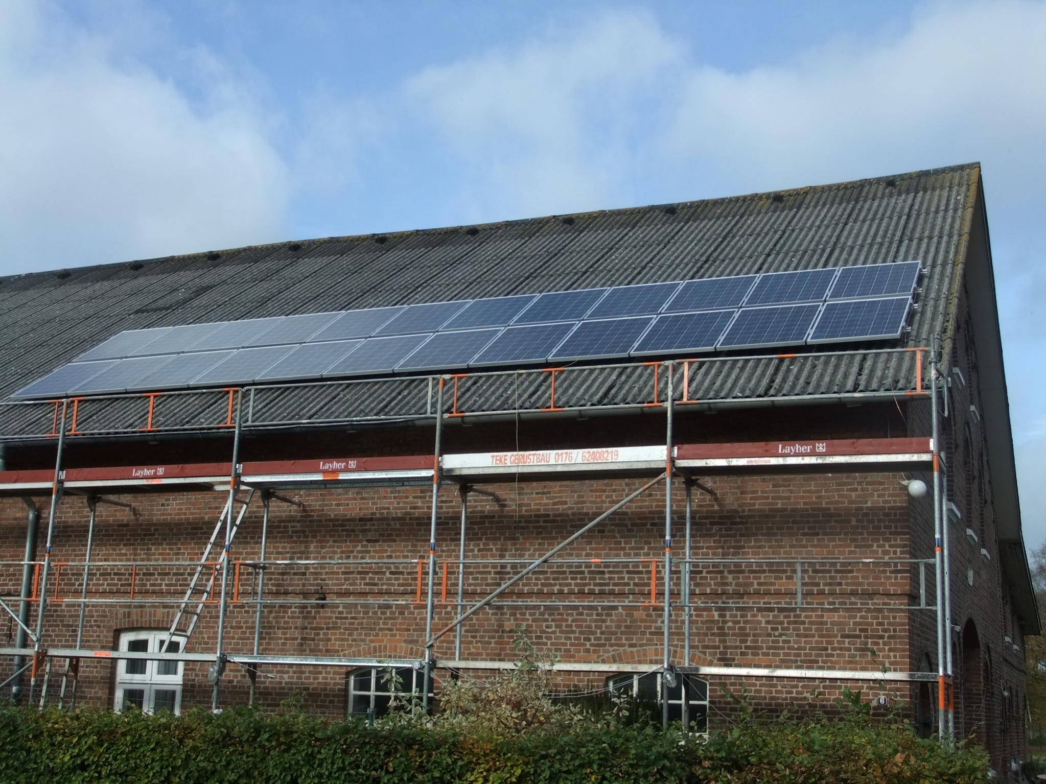

Edit:

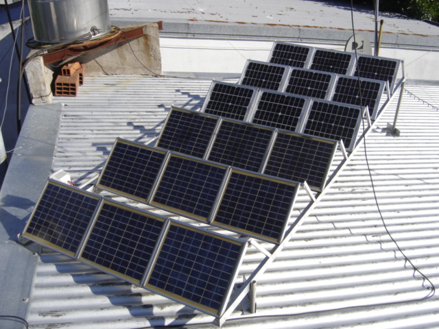

here how I compensate my power consumtion. 24 Modules with 4 kW peak produce aprox. 3500kWh /year.
The meters show the output on a wet november day 2016 short after fitting the panels on the roof. On the pic you can see the scaffold which was left for another few days before the roofers removed it.
