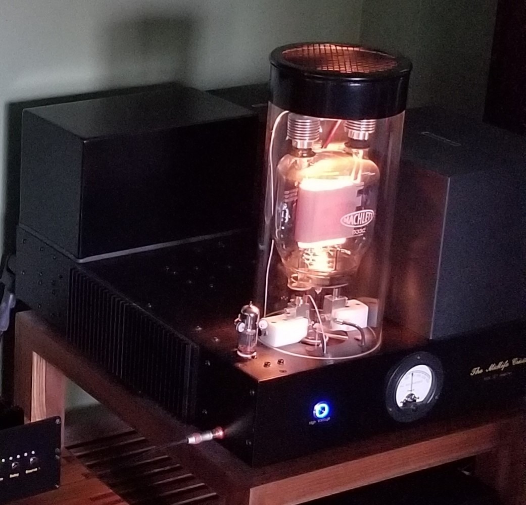

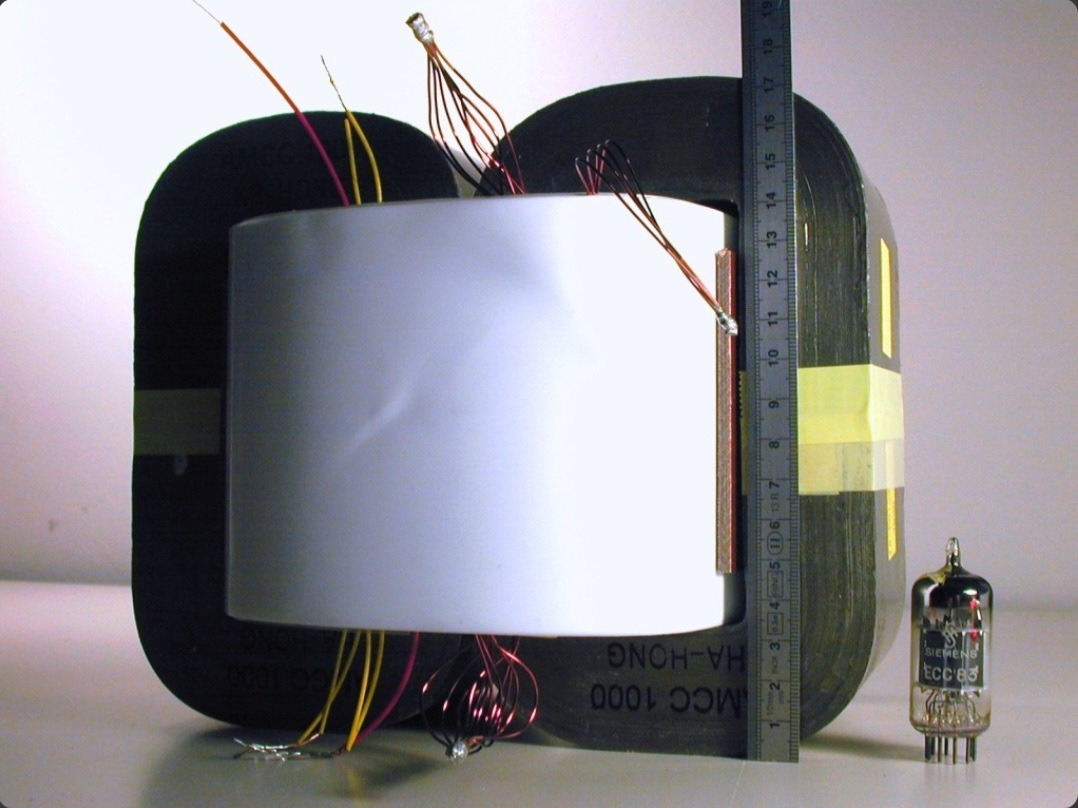

That's the OPT in my Midlife Crisis 833C amps. Each OPT weighs about 60lbs! Plate voltage 2300V at 160mA.
Monolith sent me a picture of the internals while they were building them, with virgin teflon interwinding insulation and double-C amorphous core...that's an ECC83 tube next to it for reference.
They sound excellent, BTW.
