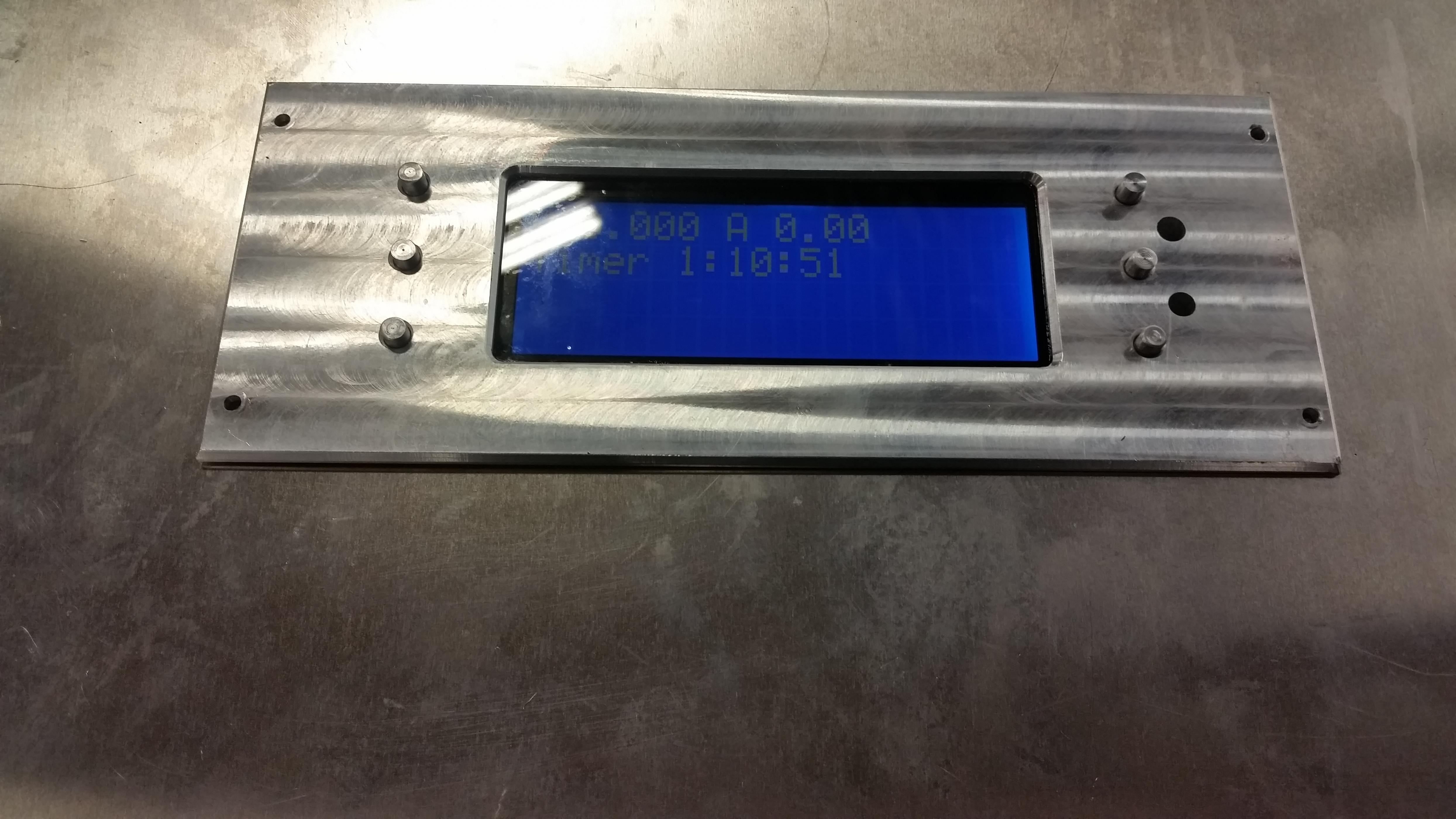

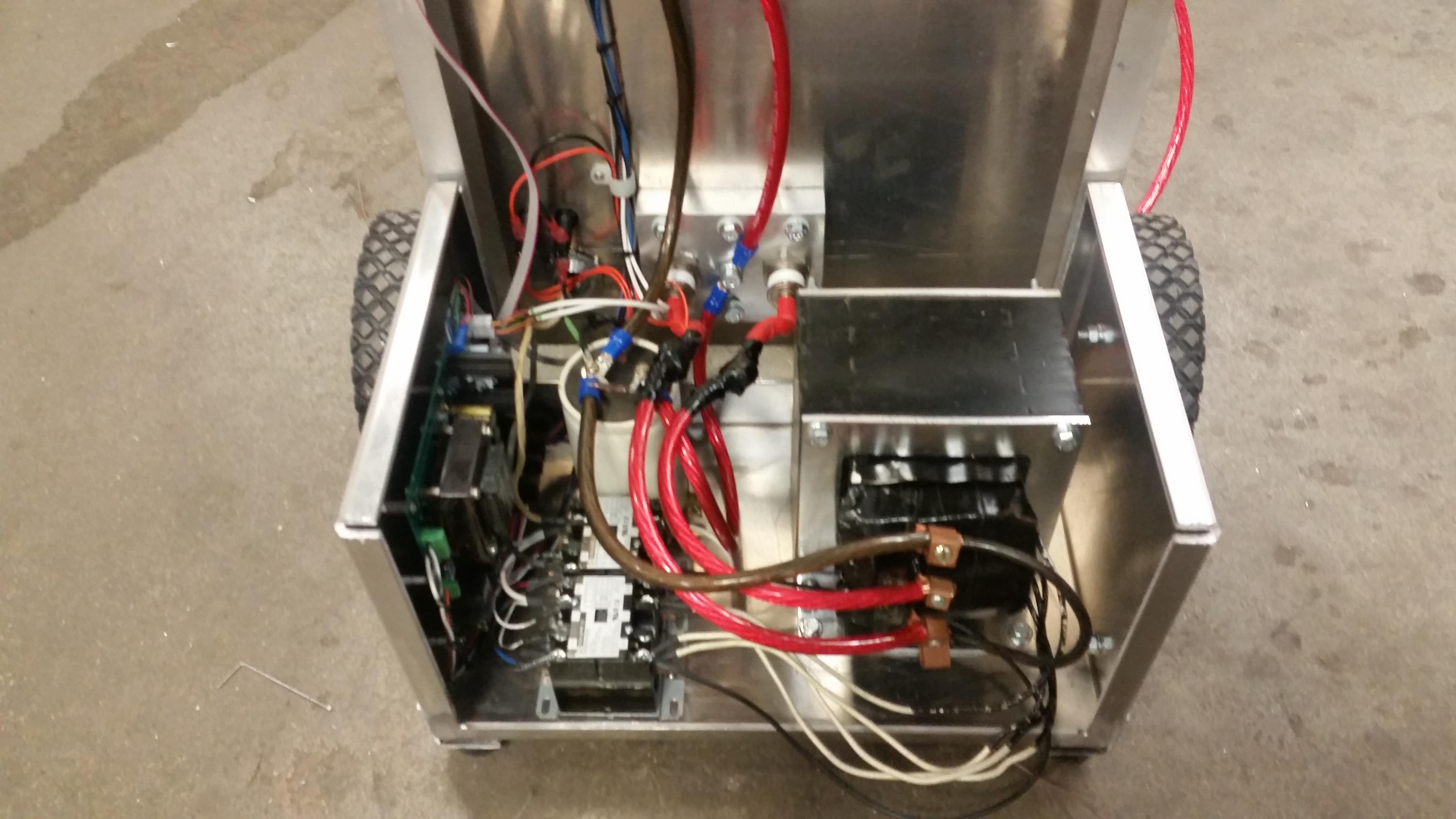

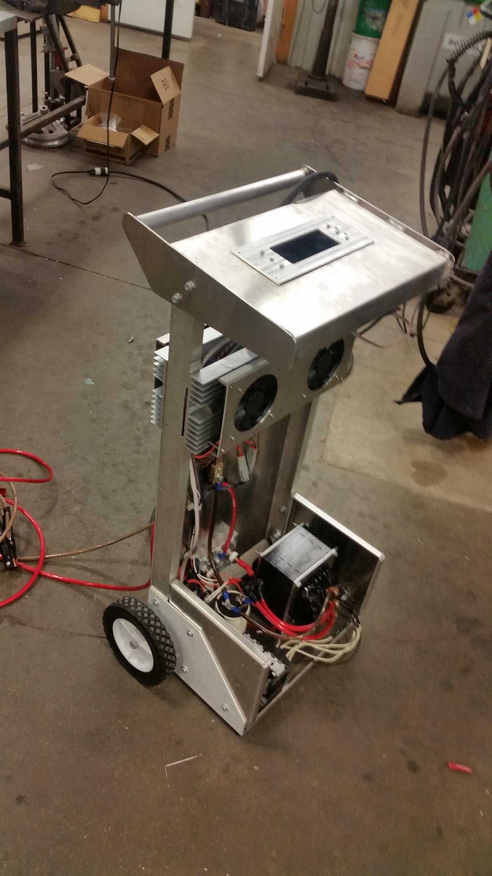

It's been a long slow dragged out build, but my supply is almost ready for a test run. I need to do some adjustments in the software yet, but it seems to function correctly so far.
I've got a microcontroller taking care of transformer and relay controls as well as temperature monitoring and fan controls. Another microcontroller controls current, shutdown timers and front panel display.
