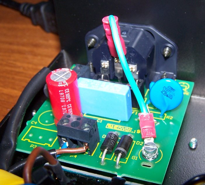

I measured the AC voltage with a DMM (10 M input impedance) between the chassis of both devices.
There was a 200 Vac differential between them with the CDP switched off that dropped to about 100 Vac when switched on.
I reversed the mains plug of the CDP and got less then 2 Vac when switched off, but still about 100 Vac when switched on.
Now this CDP has been giving me a lot of aggro over the years which I thought to have solved a while ago (http://www.diyaudio.com/forums/digital-source/133909-very-strange-fault-cd-player.html). Not so long ago it began to misbehave again, so I gave up and connected the SPDIF to the DAC (it's the analogue stage that keeps going wrong).

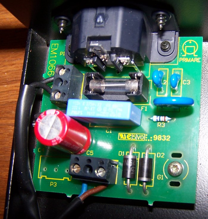

But after being bitten, I inspected the innards of the CDP again, but now focusing on the filter behind the mains entrance. Despite having a 3-prong IEC socket, the PE has deliberately not been connected by the manufacturer, thus selling it as a class II device. The design of the mains filter, though, looks like it had originally been designed for a class I device. Perhaps in a more expensive guise, this CDP would have had balanced connections. Usually PE is connected to the chassis when balanced in- and outputs are used.
Closer inspection after removal of the filter pcb confirmed my suspicion that C2 and C3 are across L and PE and N and PE (or rather would-be-PE). As you can also see in the picture the PE pin has been cut before insertion in the pcb.
Under the screw, marked G1, is a copper threaded standoff fixed to the chassis. It touches a pad that would have connected to PE of the mains entrance. I'm assuming the high potential between my DAC and the CDP is caused by C2 and C3 as long as it's connected to mains but not yet to the DAC.
While unscrewing G1 I noticed it wasn't very tight, so the connection to the chassis might not have been very good, perhaps intermittent. Recently I noticed the display of the CDP scrambling whenever I switched the DAC on or off. Might this have something to do with the not-so-good connection of the filter pcb to the chassis?
Isn't it a bit strange that a mains filter clearly designed to be used with PE can find its way into a class II appliance?
Wouldn't that mean high leakage current trough the interlink shields to the DAC?
But my main question is: can I (or rather, am I allowed to) connect PE to the chassis changing it into a class I device?

Absolutely shocking (ha!). Is the double insulated (square within square) logo on the equipment? Are you sure the manufacturer cut the connection or did you buy it used or ex demo?
I would immediately remake the protective earth connection.

PE connected
I just turned the D20 into a class 1 device by connecting PE. Instead of soldering a bit of wire between the pcb and the PE pin, I chose to do it as in the picture instead. This way I could experiment quickly and easily and it can be brought back into original state without soldering.
Whether or not PE is connected on the D20 seemed to have no effect on the noise-floor (I just turned up the volume on the amp all the way). According to this excellent article (http://www.diyaudio.com/forums/diya...udio-component-grounding-interconnection.html), "Loops aren’t bad – it depends on what is on the loop.", holds true.
I do have a groundloop, though, if I connect the CD-player to both the amp and the DAC. Then, at higher volume a buz/hum is heard, I presume this is a ground loop (CDP<>DAC<>AMP<>CDP). Connecting PE doesn't affect it.
I see on the pcb there's the possibility to connect SPDIF through an output transformer, that would prevent a ground loop. For now, I will either only connect analogue or SPDIF. The analogue output of the CDP is better than that of the DAC, so I prefer that, but if it goes bad again...

On your ground connection..
I see the energy storage device under the panhead screw, that is good.
Is that a self-tapping screw that goes into the chasis metal?
Is the hole in the pcb solder coated, so that you are compressing solder with the screw? If so, that is not recommended as the solder will creep over time, loosening up the bond.
