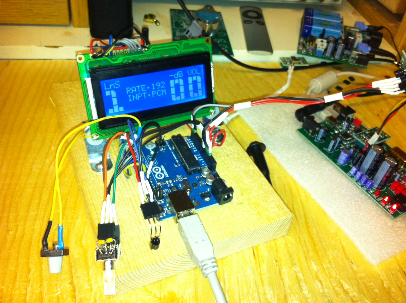

Code done...
as far I will take it now.
Arduino 1.0
Apple remote (Vol+/-, dim)
Rotary encoder (plz check if the debouncing delays are in the right places)
Switch for filter changing
Didn't do: Remote filter selection, remote or rotenc rate selection, brightness or contrast...
Brgds
The code:
The spiderDAC:
