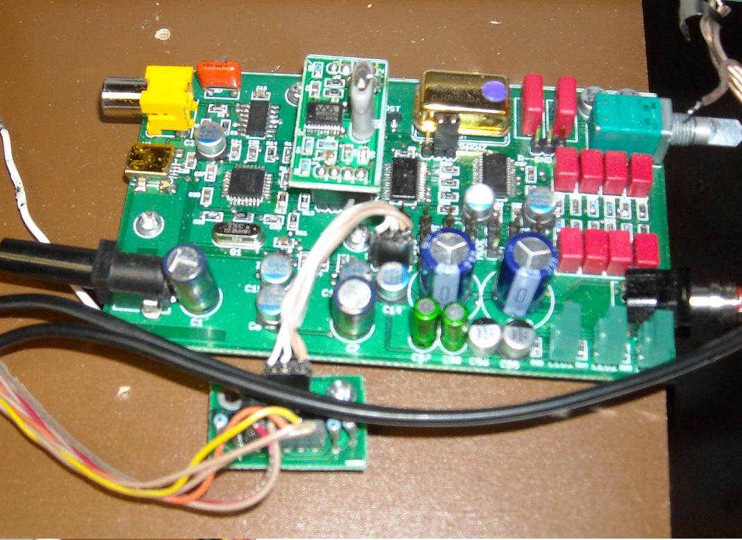

Does anyone have the SPDIF input working?
I've tried both my soundcard output and the output from a CDRom drive that I transformer coupled with resistors in an impedance matching network and neither work with this card.
I tried both sources with another DAC board I have (CM102S/CS8416/CS4398) and both worked with it so I don't think it is my source that is the issue.
I took the WM8804 receiver off ribbon cables, attached sockets on the bottom and plugged it directly on the pins on the DAC board. SPDIF still refuses to work.

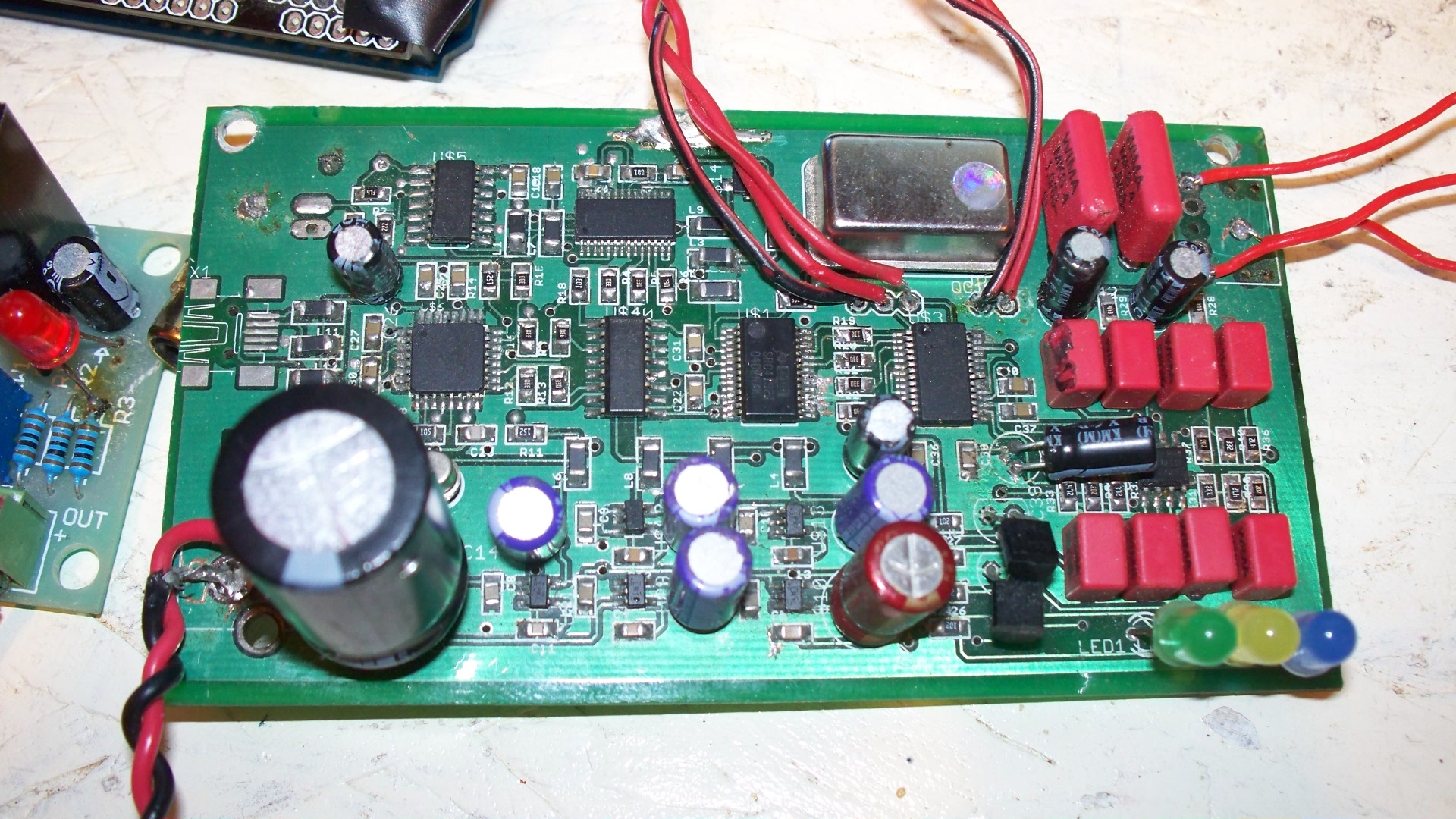

hi,
A picture of my board,I am getting ready to modify it to use the mute,digi volume control and the digital filters,All accessed with the adrino of course,
What pins on wm8741 are SDA and SCL,They don't seemed to be labeled that way ,I will keep looking.....
Thanks,
NS

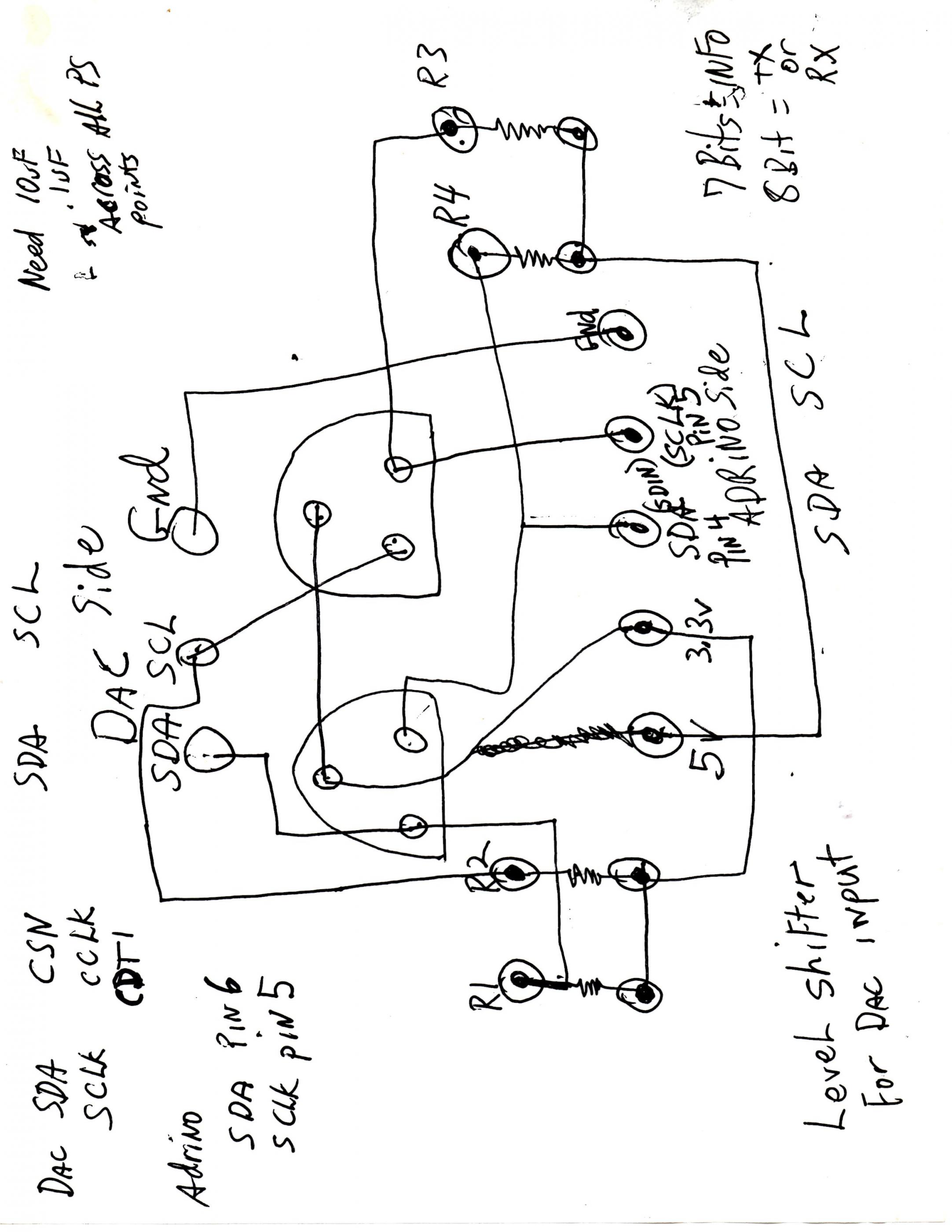

hi Turbon,:D
I have temporarily put this project on hold ,If you do get it to work I would like a sketch of the Adriano program , Mine is from twisted pair and seems to compile ok and loads but not control the wm8741,I may still have some problems ,but have gotten side tracked with a set of xoc th 18 speakers and a set of DM-2 from speakerplans ,I am almost done so I will have some time to get back into the wm8741 and arduino .I have enclosed the rough draft of the level board I found in my files ,I have those original boards also,I hand made a circuit on some pref board,
So good luck!Maybe this thing will work ,after all,lol.
NS:)

Yes, I recall there was a problem in wiring the card between the dac and arduino...
Just shout if you want me to dig it out... ;-)
